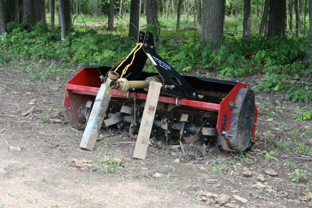

I have a Howse Implement tiller, TILLER : Howse Implement Company, Your source for tractor and farm equipment parts and supplies
Easly to reverse and offset. Not a high quality tiller, but does the job. Their web site needs work also.

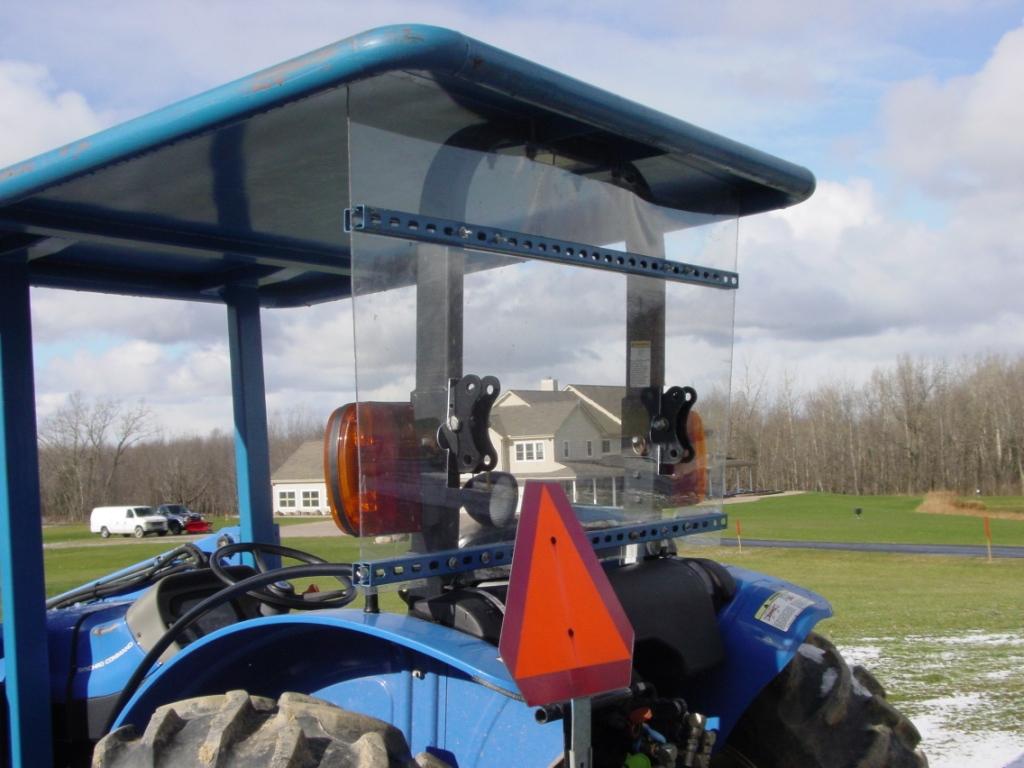

The rear shield is really necessary to keep the rocks out of my head. Reverse tilling will launch rocks upward at the operators head.
I used Lexan (polycarbonate) bolted to the ROPS. I added 10" of offset to leave the tiller fully behind the left wheel. A creeper gear would be nice, my NH TN65 is a little too fast at times, even in the slowest gear.
