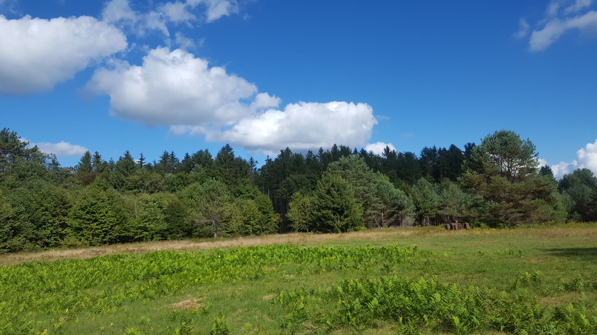

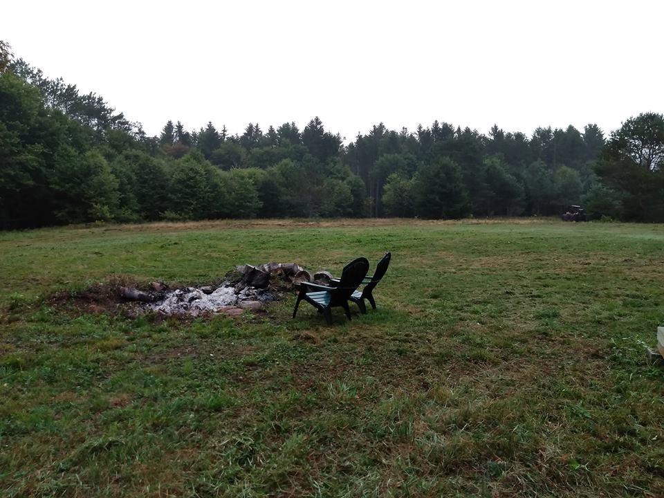

Hello there Oosik, thanks for the reply! You've given me some food for thought. First, I do believe that tread width is used, center of one tire to the center of the other. It reasons, therefore, that it doesn't take into account half the width for each tire. That, by my guess, would mean actual width is one tire width larger. It also means that by your argument, I'd ballpark actual width as close to 6ft across (I'll measure when I'm up at camp again). A cutter would need to be quite wide indeed to avoid my tire paths. Your point is well taken. Like you, I'm currently using a 6ft box blade on the rear and the edges of the box line up well with the tire edges. I've yet to try a cutter. Sounds like I'll be needing a scarf around my throat and mouth with a pair of goggles ;) The small John Deere I use for the 3 hours of cutting I do already kicks up dust in spots like a stampede in August.
I had to chuckle when I read, "I have no beautiful/fancy bright green meadows to mow. Least of my concern would be stomping down the dead grass and not having the mower catch/mow it." It got me to thinking, neither do I really. In fact, I don't care that it's closer to rough than finish. A smaller cutter could also come in handy on saplings and thick brush should some grow, or hills, should some appear :laughing:
I went down this road of questioning around 5 yrs ago and for some reason I can no longer remember, thought the 60 inch was the right choice. Looks like I'm remembering why.
Thanks again!
Before and After. 3 hrs later, time for a beer or two.
