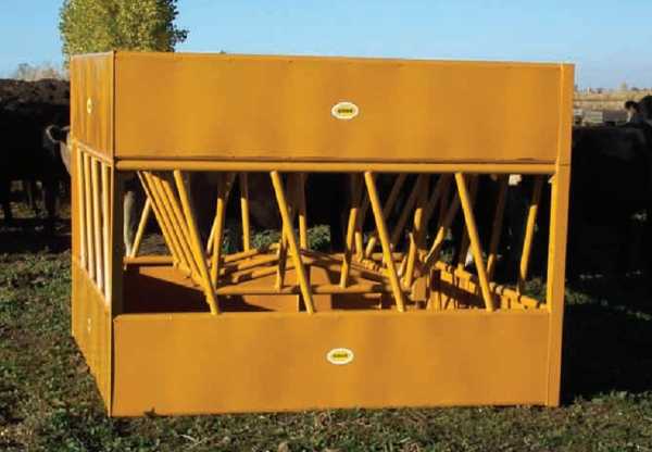

I am looking to build a round bale hay feeder, something similar to the square sioux hay feeder. Can anyone give any advice or pointers on building one of these. I am planning to use 14 ga 2" round tubing, also can any one give recommendations on either building it as one unit or as several pieces or as a top and bottom section.

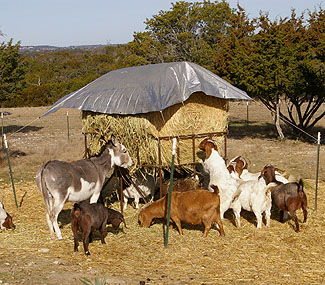

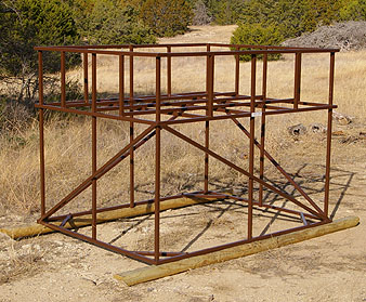

What kind of animals will you be feeding from it? If it is going to be square, wouldn't working with square tubing be easier to work with? I build square bale feeders for goats and because the bale is elevated, I build with 11 ga , 1" square tubing.

This is the type of feeder I want to build. If anyone has suggestions on building it.
