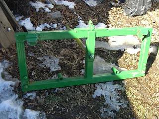

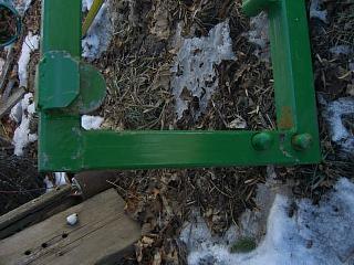

Here is the round bale spear i made for my JD's, still need to add the 2nd forks.

I made a similar attachment and I just used 1" cold rolled steel for the minor spear about 24" long. The main spear takes all the strain and the shorter length makes it plenty strong. The only real reason for it is to keep the bale from spinning when you pick it a little off center.

Thats what i used on the other one i Just have not had the time to work on this one.
