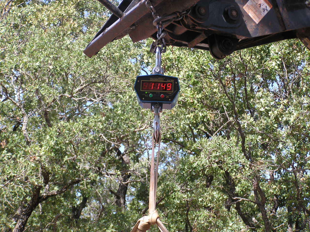

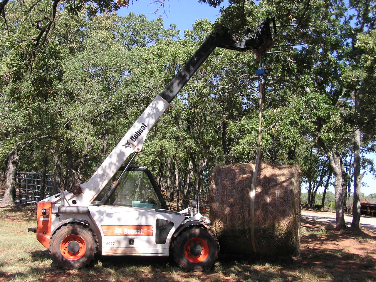

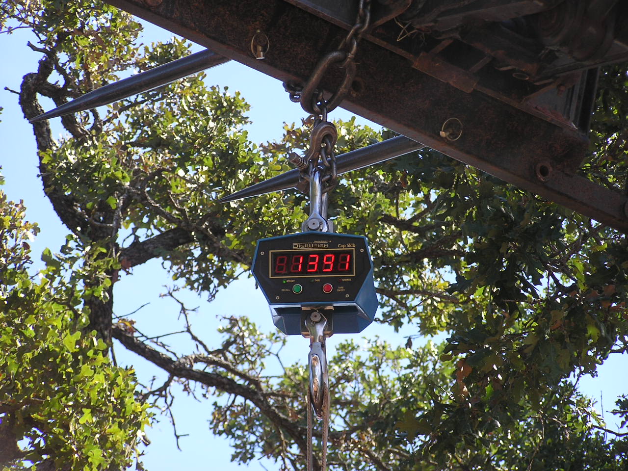

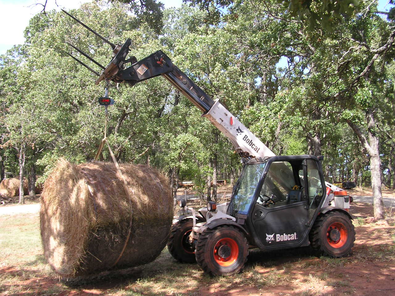

I have b7800 and wouldn't try it on round bales. They would have to be a real small ones to use the fel. 3 pt would do small rounds.
   / Round bales #10

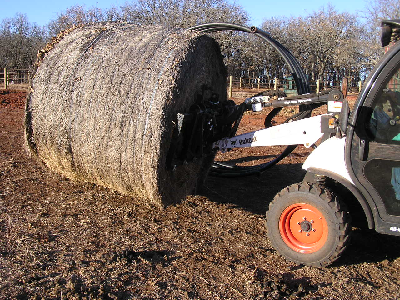

My wife sets out the 5x6 bales with the Toolcat. You can see the bale ring behind it, she has no problem raising it up, or pushing it over the bale.
To the OP, whistlepig, you have to cut the twine or netwrap before you set the bale on the ground. :thumbsup:
