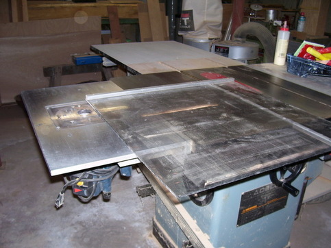

I thought there might be a few woodworkers out there that would be interested in what I did to my Delta Unisaw to adapt a router table to the left wing if the machine.
I had to remove the cast left wing on the saw to mill a flat along the entire outside surface and of course have it perfectly square. This would enable me to mount an auxillary
table that I made out of 1/2" aluminum jig plate. I believe I drilled and tapped 6 5/16"x18 holes to mount the auxilary table to the wing.
As you can see in this photo, I milled a square opening for a polycarbonate insert that the router is attached to. I usaully use a Bosh Variable speed plunge router in this setup. I used a piece of 3/4" extruded stock along with the two supports in the next photo making this thing quite rugged.
This setup gives me alot more support when cutting off stock that hangs on the left side of the saw. In the last photo you will see a panel cutter that I made for cutting larger panels etc.

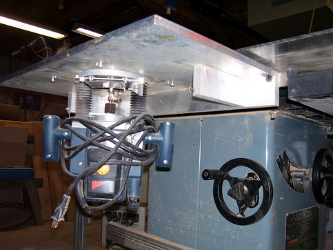

This photo is the underside of the addition, just to give you a little idea how it looks, nothing fancy. /forums/images/graemlins/grin.gif

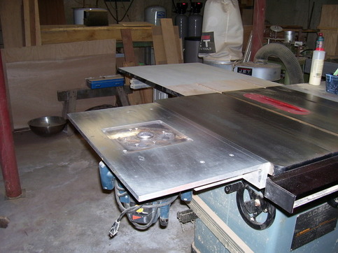

The last photo is the panel cutter I made out of 1/4" polycarbonate and some extruded 6061 bar stock. Obviously the key here was to get the aluminum bar stock that the panel or board is pushed up against to be perfectly square with the barstock riding in the miter groove.
This thing is incredibly handy for almost any cuttoff situation. Especially when squaring up raised panels and such.
As you can see I used flathead screws so they would be below suface and out of the way.

I'm a little unclear how the fence works with the router. Does the tabble saw fence slide over far enough for the router, or do you have another fence for it?
I'd think you'd have to have a router type fence because of material build up and also the fine adjustments you can make with a router fence.
Where there any channles in your base plate for tools or attachments. My featherboard is alwasy on mine when I do anything long and thin.

I use my Unifence, and clamp an additional fence for the router onto the Unifence. The router fence has an opening for a shop vac pickup for all the dust that is generated by the router.
