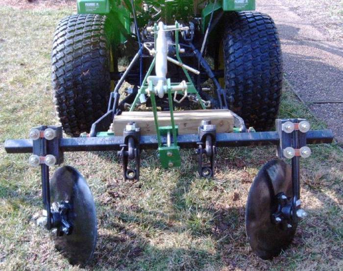

Go to that Agri Supply site that someone posted. Look up Keulavator. It can be fitted with 2 discs.
I use something similar. It's an old JD M soil ripper with custom made mounts to put to 20" discs at 45 degree opposed angles behind the wheels of my JD 4010. It worked great.
Attached is a picture.
Ralph
