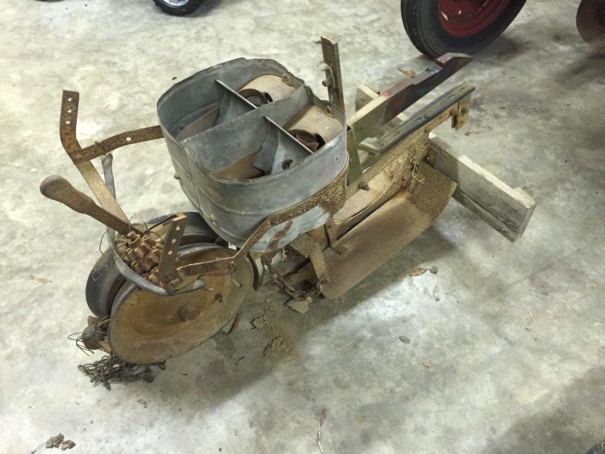

Thanks JMER817 and Pappy on the advice about the arms. However, the type a planter I have (Cole) wasn't manufactured, to my knowledge, so that arms like you are referring to can be added to it. This is planter that used to belong to my Dad who passed away a couple years ago. I'm not sure how old it is. I'll have to find out from the manufacturer if arms were an option for it and, if so, could they still be purchased.

Taylorsrus, and the others who have posted: At least my experience with multi row plants yes you have markers like being described. Now on ONE row planters which is what Taylorsrus is using no, never seen row markers. I do realize some of such varies but we were big one row country here with tobacco for many years and the rear most sweep was always set to leave a good strong furrow to drop your wheel in to keep yourself properly spaced and aligned. It is also easier than the marker for adds nothing to the width of the setup. Let me alter this a little: on setups where the tractor wheels are the same width as the rows being planted the rear most sweeps are used as guides where the tires are not as wide as the rows being planted they have to use an arm of some sort as a guide. Now on the arms have seen them where they line up with the center of the tractor (which I do like, does not matter the width of the wheel spacing) and also where they line up with the front wheel for the spacing which does require a certain spacing with the tractor wheels.
Taylorsrus, if following the furrow the advice still is good for you to begin in the middle of the field and keep turning right due to tractor being offset. It is also good even if your tractor is not offset for other wise you must make tight turn or drive out and back up to align for next row. Do take your time to get your rows laid off or planted straight and proper width other wise you will hate yourself when you try to plow them.
