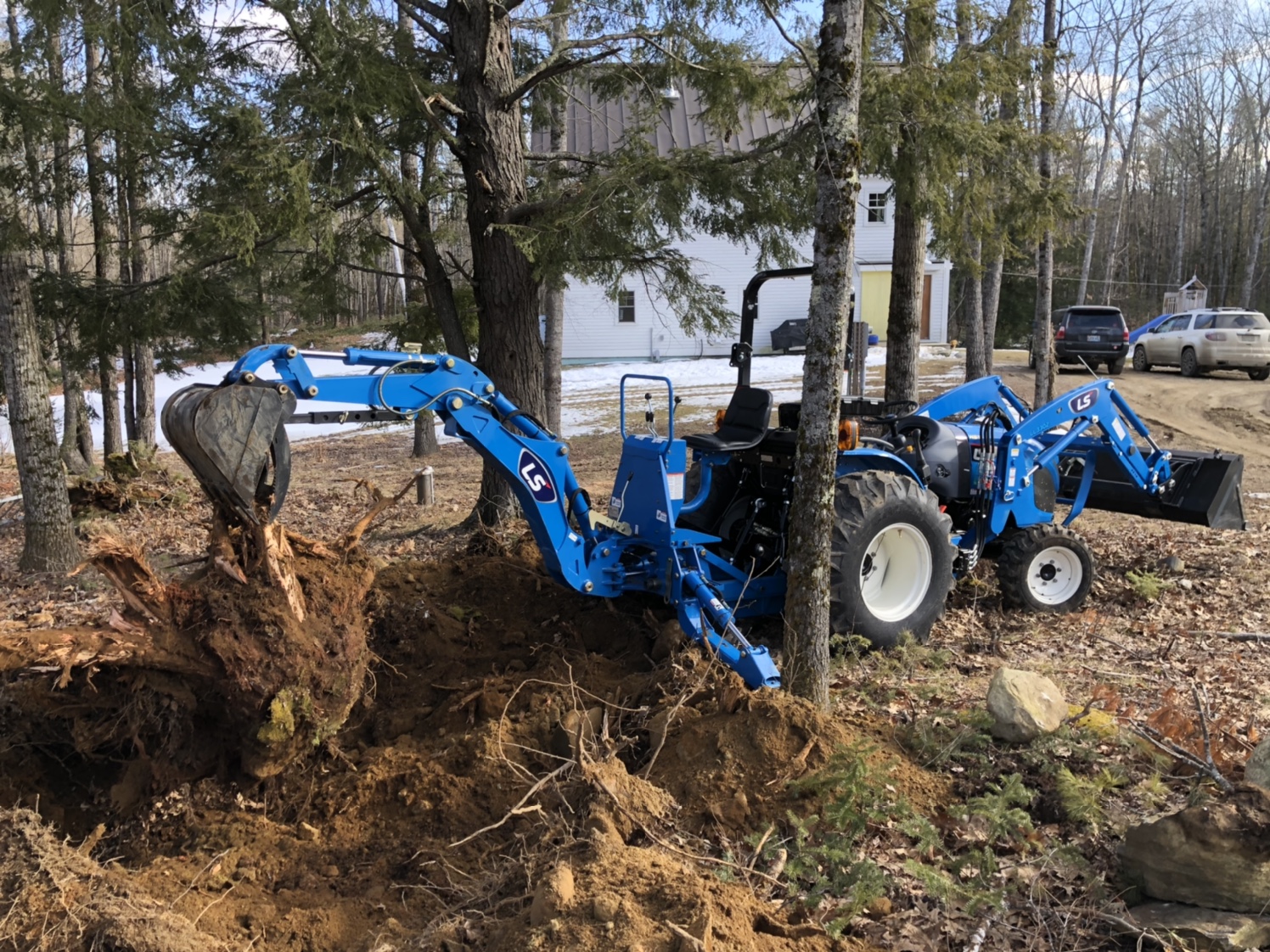

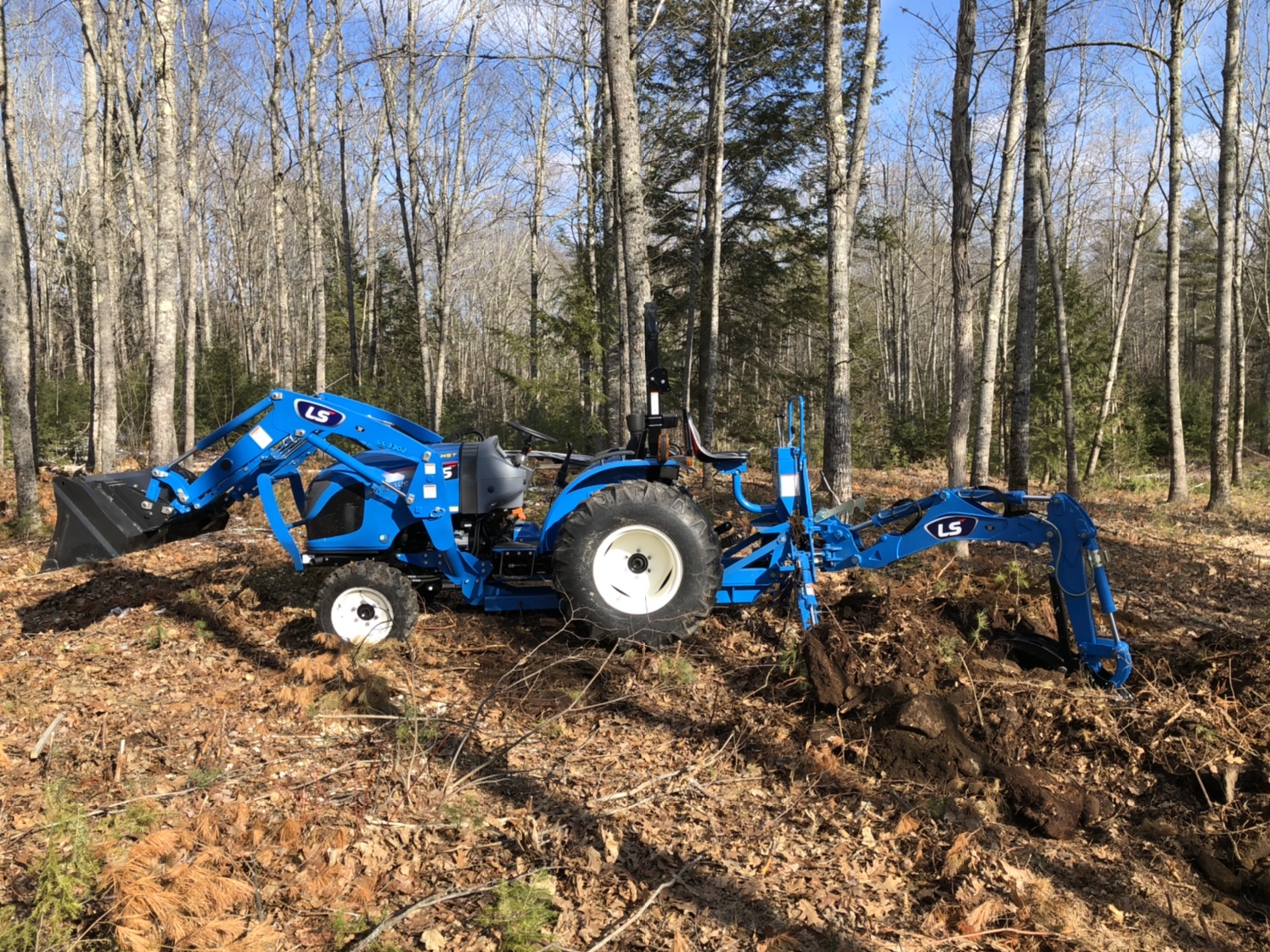

What speed do you all keep your tractor at while running your BH? My manual basically says it up to the operator, higher RPM means faster movement. Anyone have a sweet spot? I don’t think pinning the RPMs is the best idea either. It’s on a MT240HE.
Thanks all.
