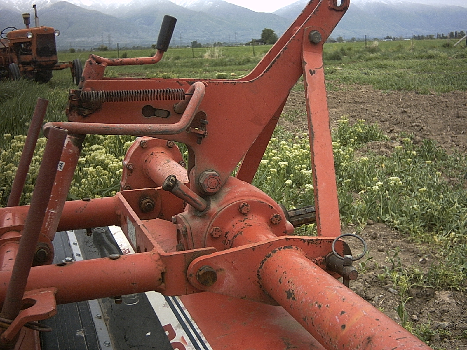

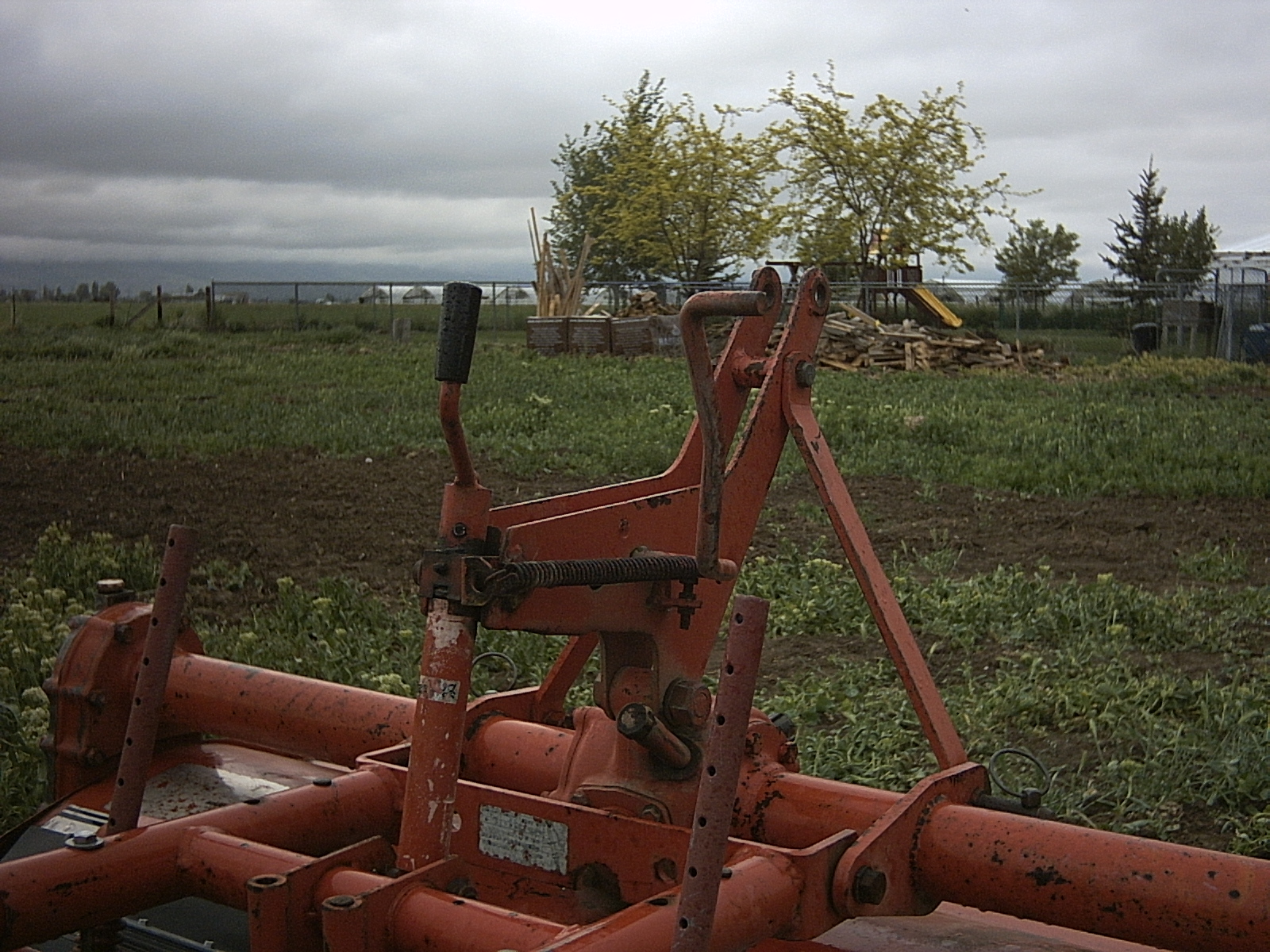

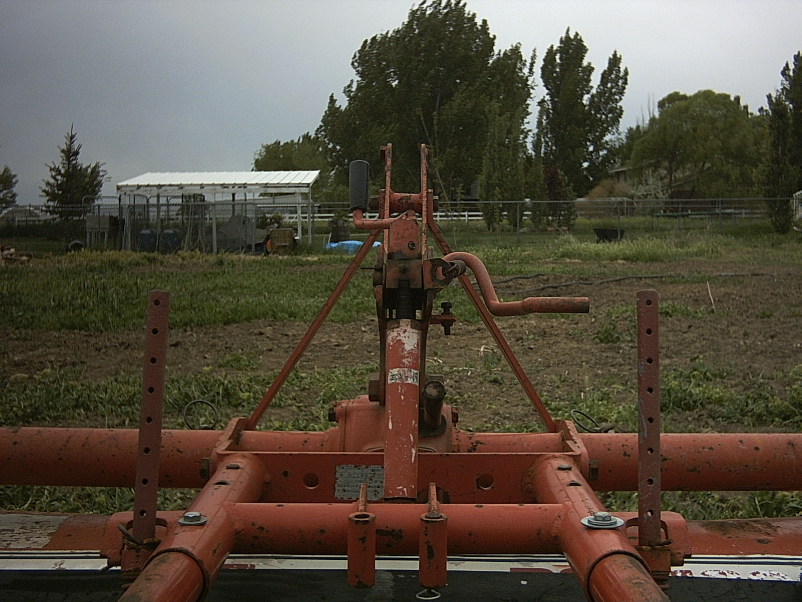

I just bought a Yanmar RSB 1300 tiller to use with my YM2310 and I am wondering what some of the knobs and levers do. Are there any manuals out there?
   / RSB 1300 Tiller Manual? #2
Don't know about a manual but if you post pictures of items of interest, I might be able to help.
I'm wondering what the order is for adjusting the depth of tilling. I am guessing the 3 point hitch for big adjustments, then the height of the wheels, and then the crank in the picture? Would you happen to know what the lever on the side of the crank is for?

The best I have figured out is the crank control/sets angle of the tines and how close they come to the rear tires when fully loaded and to some extent depth. The lever releases the rear wheel assy so they can float.
I'm sure all this is more important when used domestically in the rice fields.
I don't use the wheels often as I have my tiller set up to operate with the UFO controls on my tractor. The UFO controls deals with keeping the tiller level and a consistant depth.
