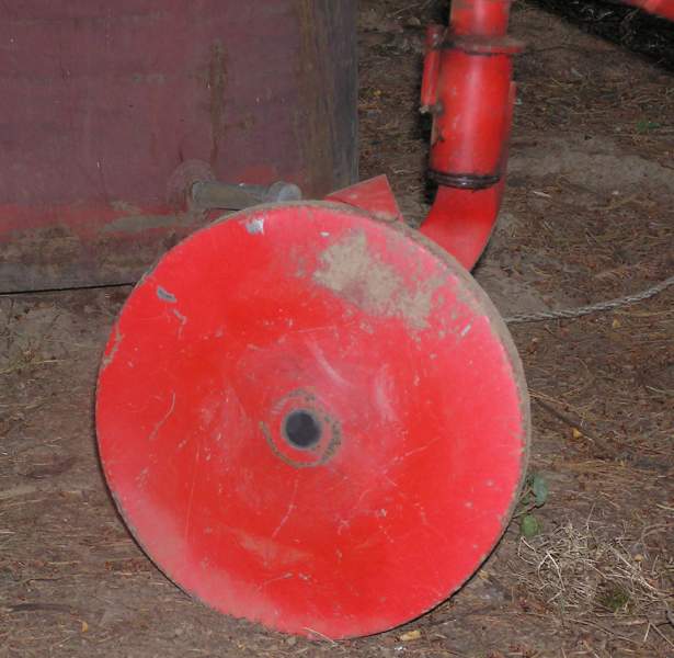

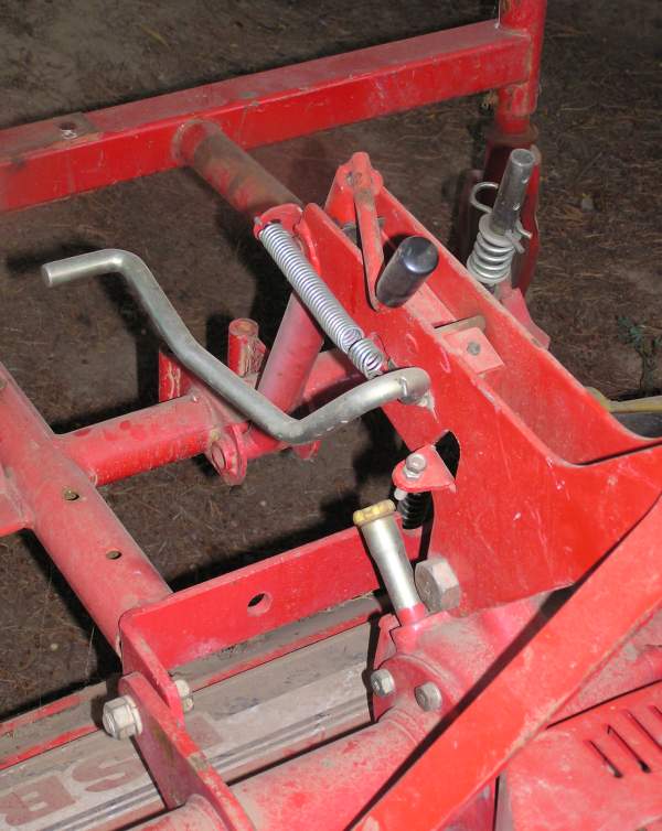

Tom, here are a couple pics. Excuse the dust, dirt as the tiller was used a couple days ago.
The wheel carrige assy is adj up/dn to set heigth with relation to tiller depth. Wheel are about 12" dia made from 2 piece steel stampings made like a dish with one fitting inside the other. Can also see the mud scrapers for the wheels.
Last pic shows the wheel carrige assy at the piviot point and height adj. The lever can be pulled so wheels "free float" with respect to the tiller. On my tractor this is kind of hard to pull from the seat.
Depending upon ground conditions I really recommend the spring tension for the rear drags. Even with the pressure I use the ground is still about 2" higher than before tilling. The drag does a god job leveling the tilled soil.
