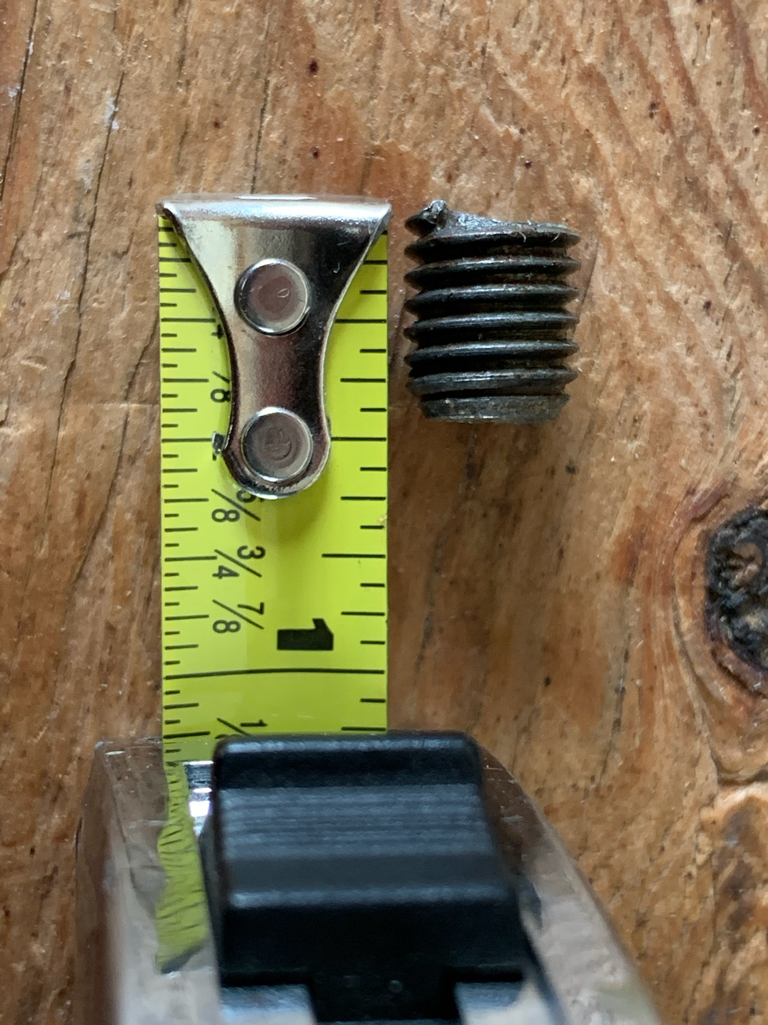

It is actually my friends tractor but people need to know. The bolt for the rt lift arm apparently came loose and once it backed out enough snapped off. We got the bolt out using a left hand drill bit and a rt angle drill. Once the bit caught hold it unscrewed the remainder of the bolt, about 1/4". Our local AgPro suggested abuse but I can tell you this this is treated better than many children.

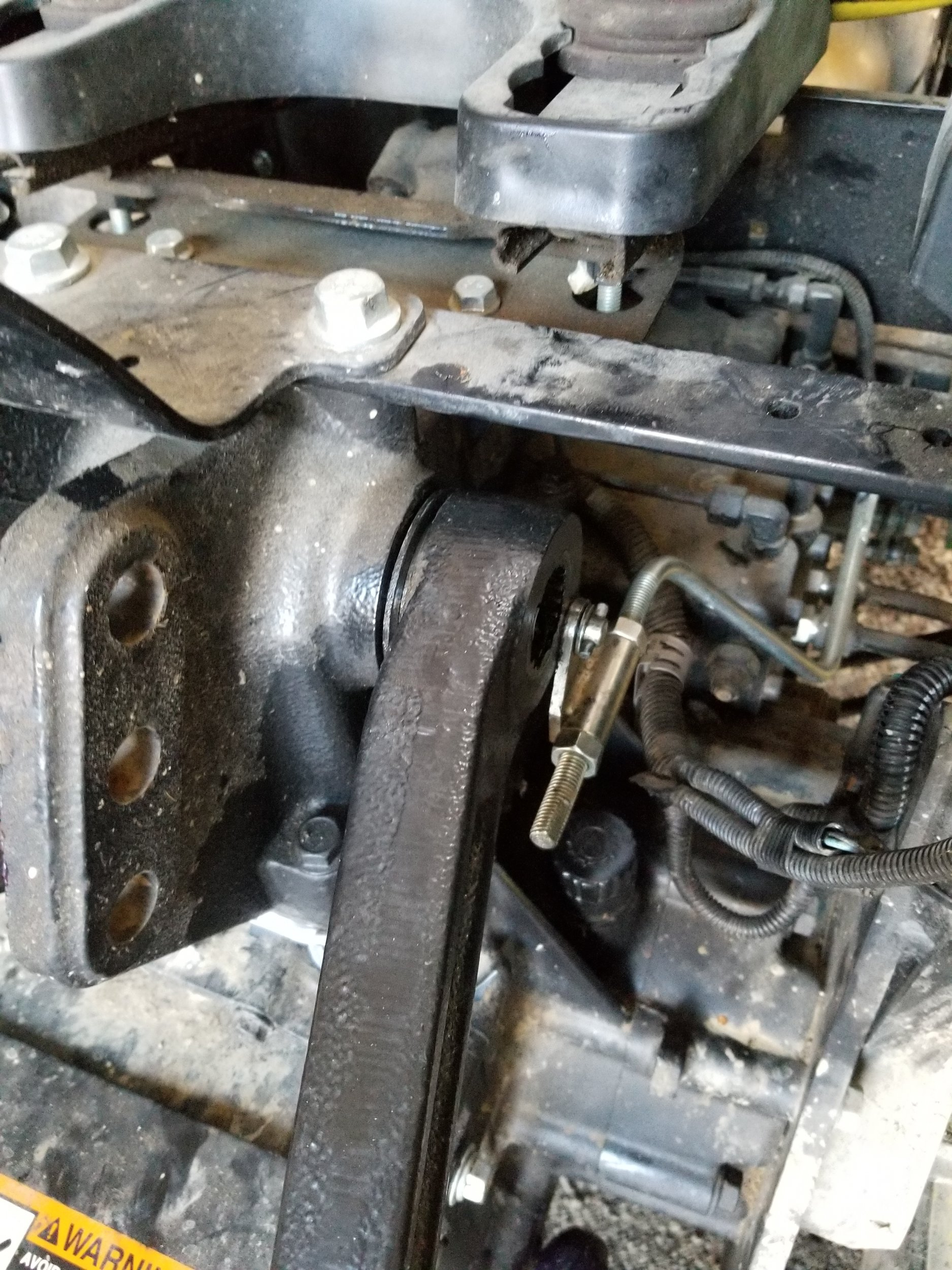

A bolt holds the lift arm or a bolt that holds a pin holding the lift arm? Pictures?
   / Rt Lift Arm Fell Off

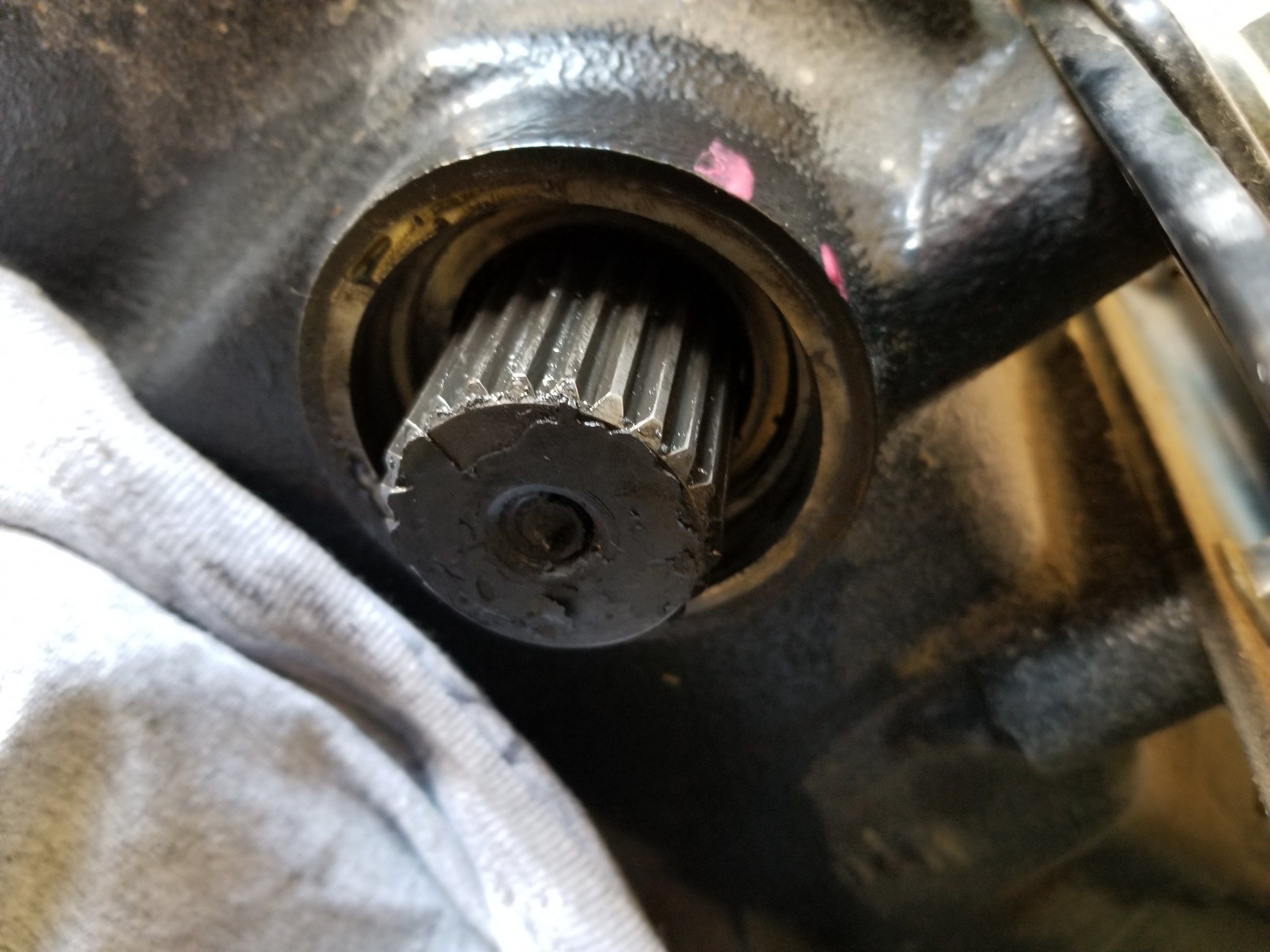

The third pic shows the left arm with the washer and bolt holding the arm onto the spline shaft. The first two show that the bushings are missing and the bolt is sheared. Of course the remaining piece is removed using left handed drill bit. The remaining piece screwed right out.

Check out that forum, his 3032e most likely also had a bolt back out however, the shaft broke in lieu of shearing the bolt. This is of course an ASSUMPTION, but it is based on years of mechanical maintenance.

Here is what remained in the shaft, once a new bolt arrives you will see the full length
