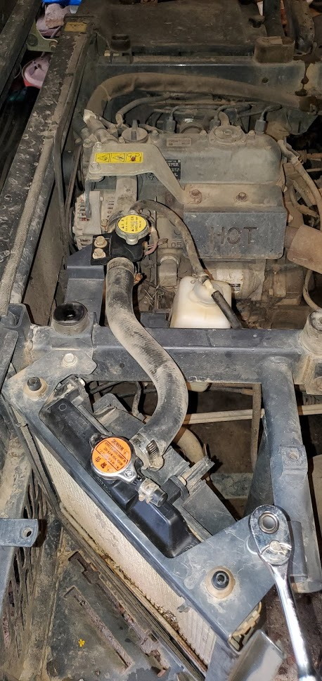

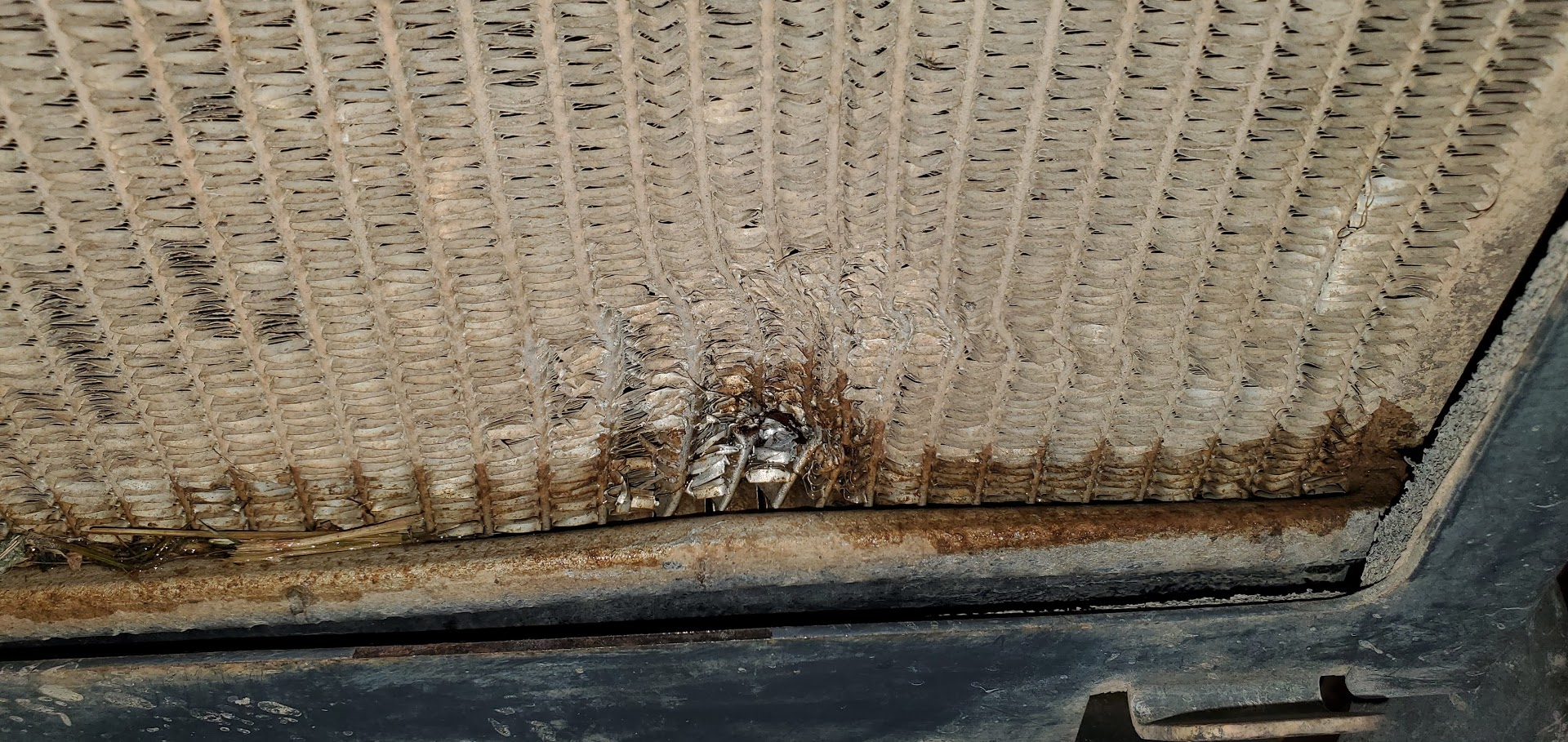

I put a stick through my radiator. I'm going to take it off and take it to a radiator shop to see if it can be repaired.
Looking for options on replacing it w/o breaking the bank. Has anyone else replaced w a different radiator w good results?
If anyone has the dimensions, I'd appreciate getting them - I have to drive out to farm to get the radiator...
   / RTV 1100 CPX Radiator 2011
#2
I took the radiator, Part# K7711-85210, off and took it to a radiator shop and they couldn't fix it, pulled the tubes out of the bottom rail and bent the frame etc. I found a replacement at apairinc.com. It cost significantly less than other options. There were others that I probably could have made work, but decided to just get a new one.
I'm thinking of making some kind of guard for the radiator. It is exposed to this type of damage. Maybe some expanded metal right in front of the radiator might help.
