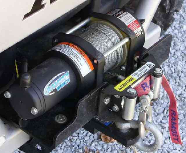

They are not hard at all to install .
I would not purchase nothing no smaller than a 3,000 pounder. That's what folks down here run on the RTV 900's, and everybody keeps a snatch block in their action pak box that we keep in the back, just for added power >>>>
Been purchasing the winch / winch mounting kit from allterrainonline, and everything has been installing them perfect !!!!! They have fair prices, and the mounting kits are a BIG PLUS ...

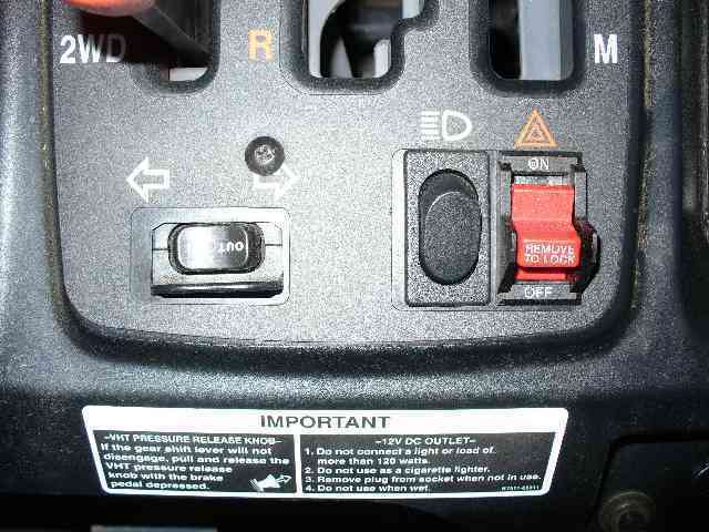

They have different models to choose from, with or without remote control..... We've got ours without, and installed the rocker switch where the emergency flasher switch goes .... easy as pie !!!
The switch is out of the way, PERIOD.....
Install the rocker switch up-side down, for the support-bar to work properly, for if it was installed the other way, it just wouldn't work right. Being upside down causes NO problems.....

THANKS! I think I will get the 4000 and do it myself. This is very helpful, especially the images make it clear.

Mistake, I installed the rocker switch where the turn singles go, not were the emergency / hazard switch goes, sorry 'bout the mess-up >>>>
