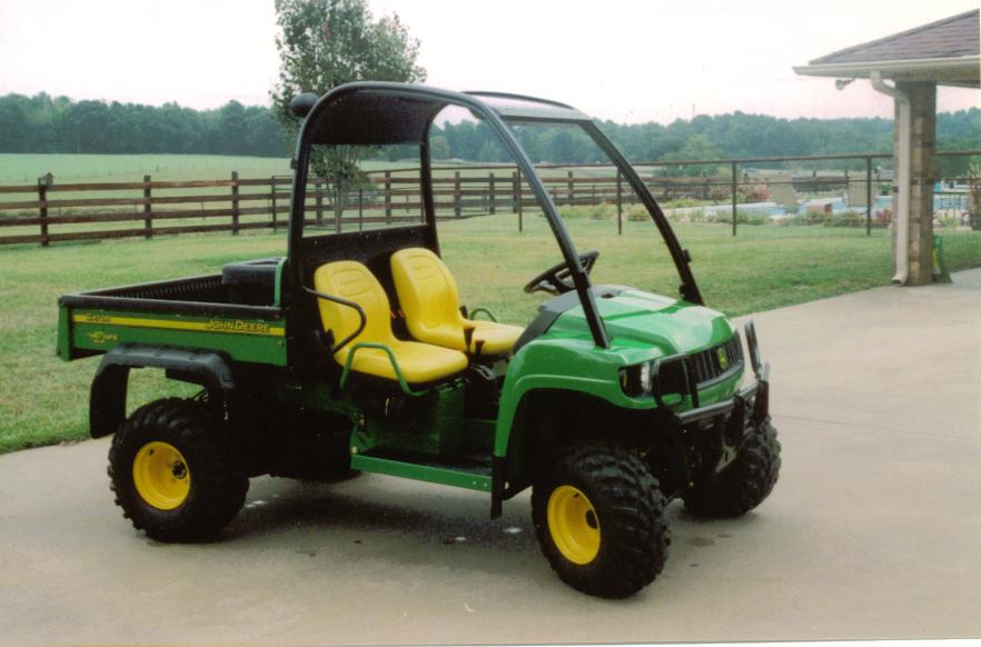

I've had my HPX Diesel 4x4 for 2 years now without any problems. Only changes I would have would be power steering and the limited slip front axle (available now). The ROPS and hydraulic dump are definately worth having.
