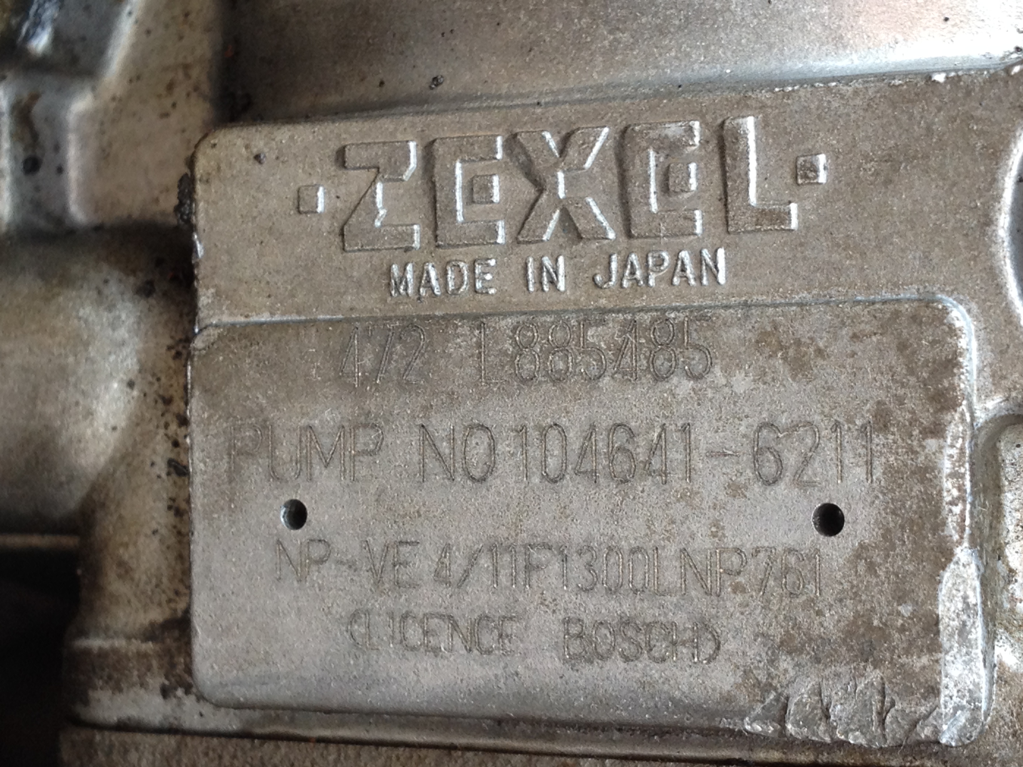

Just bought a mid 90's Bobcat 853 with the Isuzu 4JB1 4 cylinder Diesel, not running. It's been sitting for at least 2-3 years and had some minor parts removed for other machines so I decided to just get the engine going first, and figure out what may be missing later. I completely disconnected the electrical system and just hot wired the engine, shut off solenoid and starter was all I had connected. Fresh fuel into the tank, checked oil and water level, all good, gave her a crank and it sounded good cranking, no bad noises, but wouldn't fire. Tried a few times with the glow plugs and still nothing. Let it rest, cranked again, and gave it a little sniff of ether and she coughed, yeah, we have compression, another little shot and away she went, idled fine for about 2 seconds then went to full throttle....scared the crap out of me so I yanked the IP shut off solenoid and it kept running...:confused2::confused2: Thank the good Lord I had the foresight to have my trusty tennis ball ready so I stuffed it into the intake tube and killed the engine. After I regained my composure, tried it again, same result, this time I used the tennis ball to control the engine speed and let it idle for 30 seconds or so, all the while it was pumping out black exhaust smoke, hoping it would clear up, but it didn't. It sure wanted to eat that ball. :laughing: I tried moving the throttle lever and it didn't make any difference, then while it was running mid speed I tried yanking the IP solenoid and this time it quite. Fired it again and let it get to high RPM and now pulling the IP power wouldn't kill it, I had to stuff in the tennis ball.
So it's an Isuzu 4JB1 4 cylinder with a ZEXEL (Bosch VE4) injection pump.
Any and all help would be greatly appreciated....I would love to get this off my trailer and get working on other things. I have attached a picture of the pump, assuming that is the problem. :confused:

My first thought would be a problem in the injector pump.
   / Runaway Isuzu 4JB1 help ... yikes that was scary
Mine too. I have spent the past hour searching the web and found that Bosch VE pumps have been know to have the governor collar stick, at wide open which is where they rest when not operating. They start at wide open and the rotating speed pulls in the governor weights to idle after it gets its' first big shot of start up fuel. I am thinking best case, just sticky collar which I may be able to get to under the top cover (while still in the machine) worst case, the little knob that goes to the throttle linkage has broken off (also seems to be common failure on these) in which case, new pump time, or at least rebuild.
Am I on the right track?
