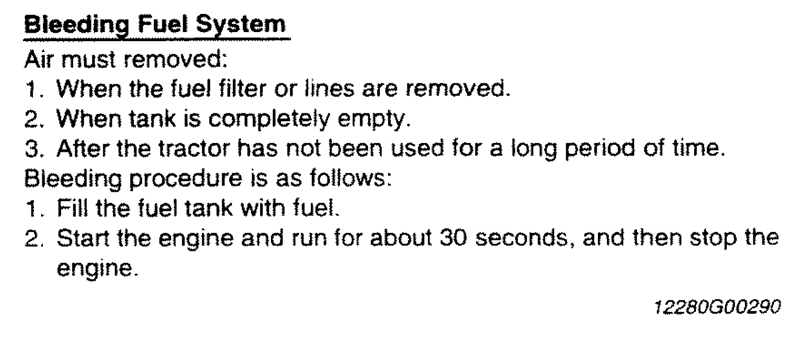

The boy ran it out of go-go juice. I've heard the stories about having to bleed lines and not running so well afterwards. Anybody have any advice before we try to start it back up?? Hoping that it's a self bleeder and it takes care of it's self.

Should have a hand primer, add clean fuel, pump the primer till hard, crack one injector line , pump hand primer till you see fuel. tighten the line, should start. CAUTION, be sure the battery is fully charged , engine has to spin over 75 rpm to start.

From the B7800 factory repair manual. Looks like not a problem.

That seems as simple as if it didn't even run out of gas.

I hope it's this simple. I'm giving it a try tonight. I'll keep ya posted. Actually I just found a You Tube video about how to bleed the lines. If when I fill it up and if it doesn't work I will try their method. It's attached if I did it right,,,,
