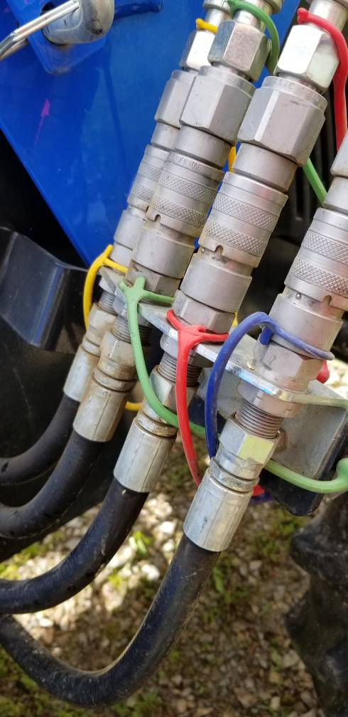

I'm going to run a couple 1/2" hydraulic lines from one of my rear remotes to my FEL to power a SSQA hydraulic auger. I'm looking for help identifying the correct fittings/adapters I'll need to make it happen. I plan to put a disconnect at the mid valve point. Currently my loader hydraulic lines disconnect there, shown in the attached picture. I would like to match these, and they look to be some kind of flat faced QD. I also want to have the new ones go through a similar angle bracket, so some kind of threaded male adapter is needed there (so I can attach to bracket, same as shown in picture). At the front I'll go with 1/2" skid steer flat face qd. At the rear I'll need the standard ag style Male fittings to go into current remote, then a 90 degree fitting prior to hose connection.

The quick connects you're looking at are all NPTF. You can get male NPT to male JIC adaptors, then use the common and cheap and easy to use JIC female hoses and 90 degree adaptors and bulkhead adaptors (which you use to put a quick connect on a bracket).
NPT sucks for hydraulics. It's on many things like cheap quick connects but I adapt to JIC and use JIC as much as I can. I use Loctite 545 on the NPT threads.

I would not use anything NPT
I would use hoses with female JIC fittings in standard lengths
I would use couplers that have ORB/SAE threads
I would use JIC bulkhead fittings with bulkhead nut in fabricated bracket for mid couplers. An ORB/SAE will thread on the short end of a JIC bulkhead fitting.
I would use adapters for the hoses to couplers as required. Straight, 45°, or 90°, what ever works best.

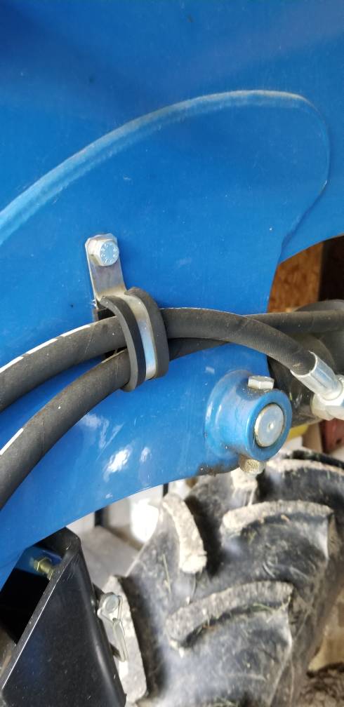

Anyone know what a hose strap like this is called (see pic)? The ones similar that I've found are round, where this one is more oblong to fit a double hose better. 20190502_180212.jpeg
   / Running hydraulic lines from rear remote to FEL #7
I can稚 remember the name but, They are metal clamps with rubber to hold electric or rubber hoses in place. They have been flattened to hold two hoses in place. Surplus center as has phenolic type blocks to hold single or 2 hydraulic hoses in place.
