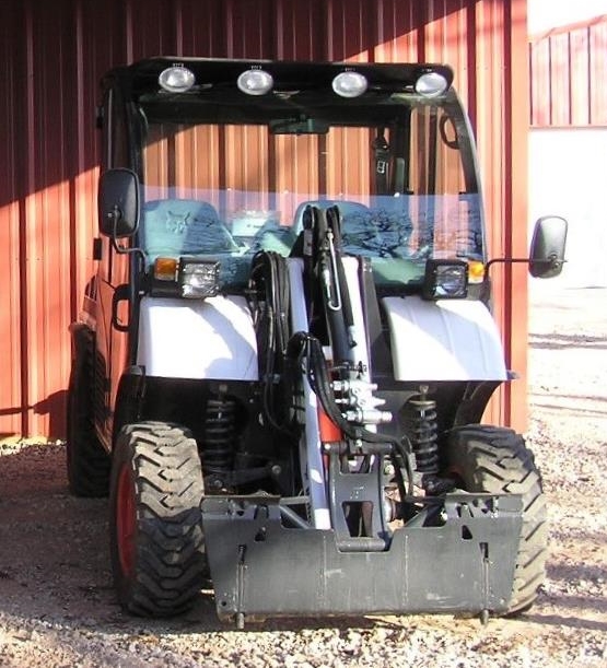

Has anyone switched there regular bulbs for light bar to LEDS? My relay keeps on melting in cab. It will run for a couple weeks but putting 30 amps through that little prong on the relay seems to melt it down. I figure if I can get the correct leds for the application it would bring down the amount of current through the the relay maybe that would solve my problem. I'm not sure if I can just go buy some Leds and put them in. The bulb is 885. Just wondering if anyone has tried it.

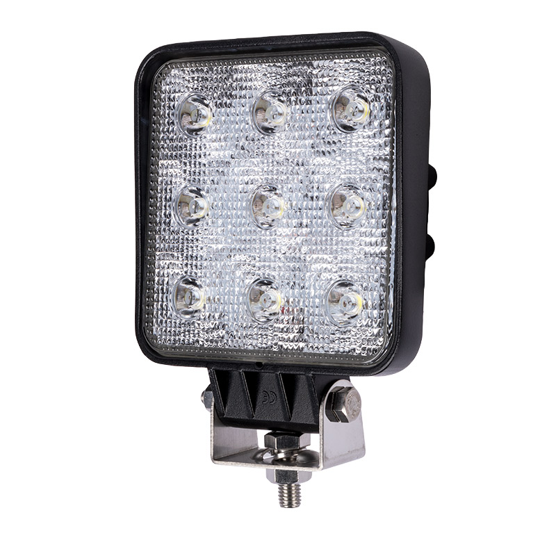

The other option is to replace the the whole thing with a LED work light:

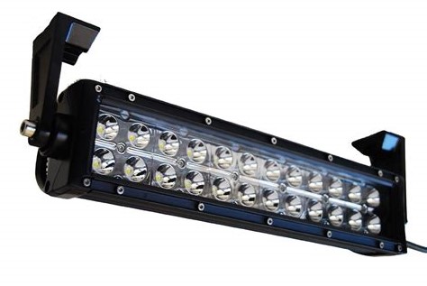

Yep, replacing all 4 with a light bar is another option :thumbsup::

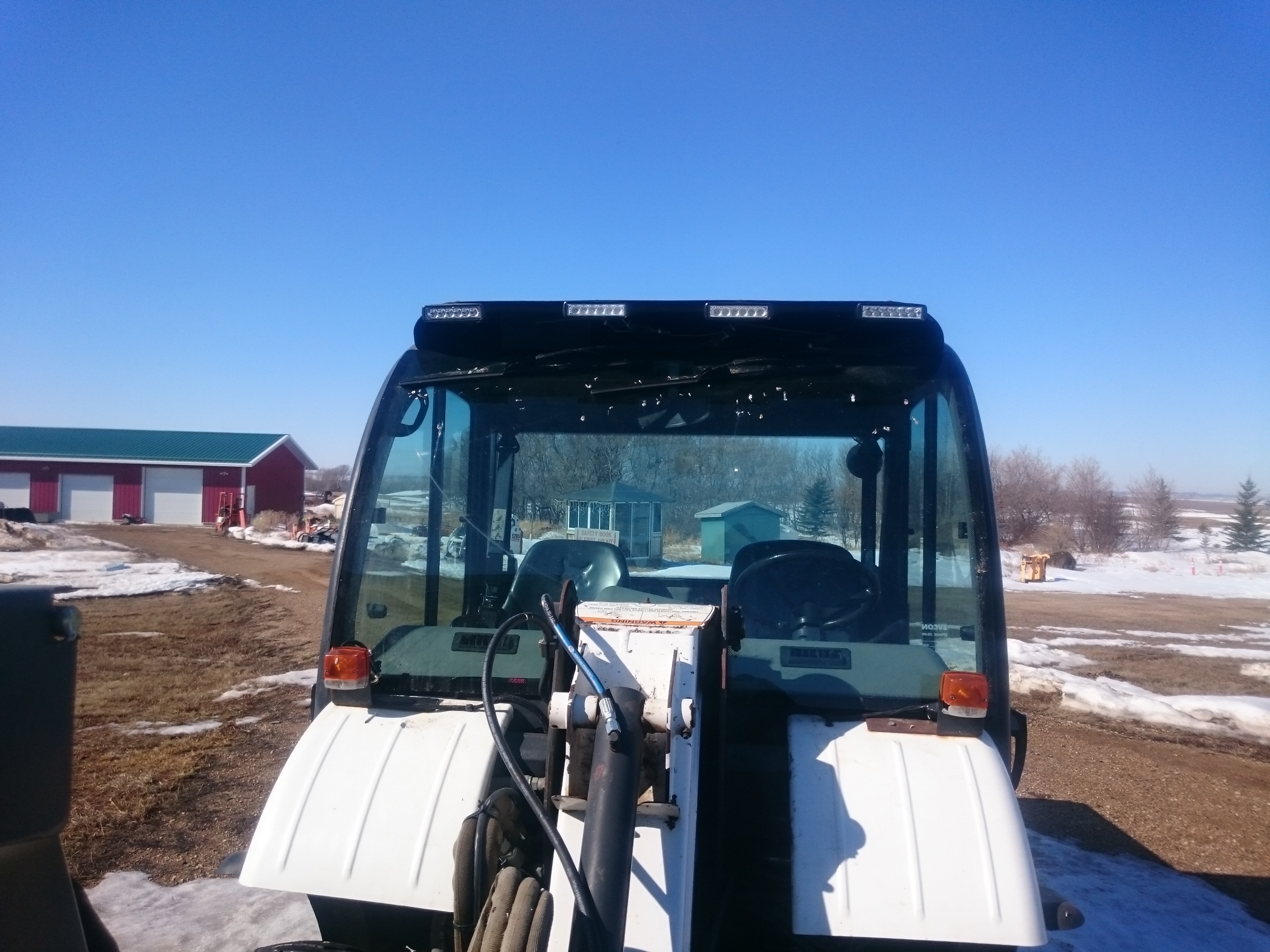

i switched the original lights for 4 LED lights, they are 18w 6LED bulbs in each, draws way less power, i used 2 spot and 2 flood easily 3x brighter
