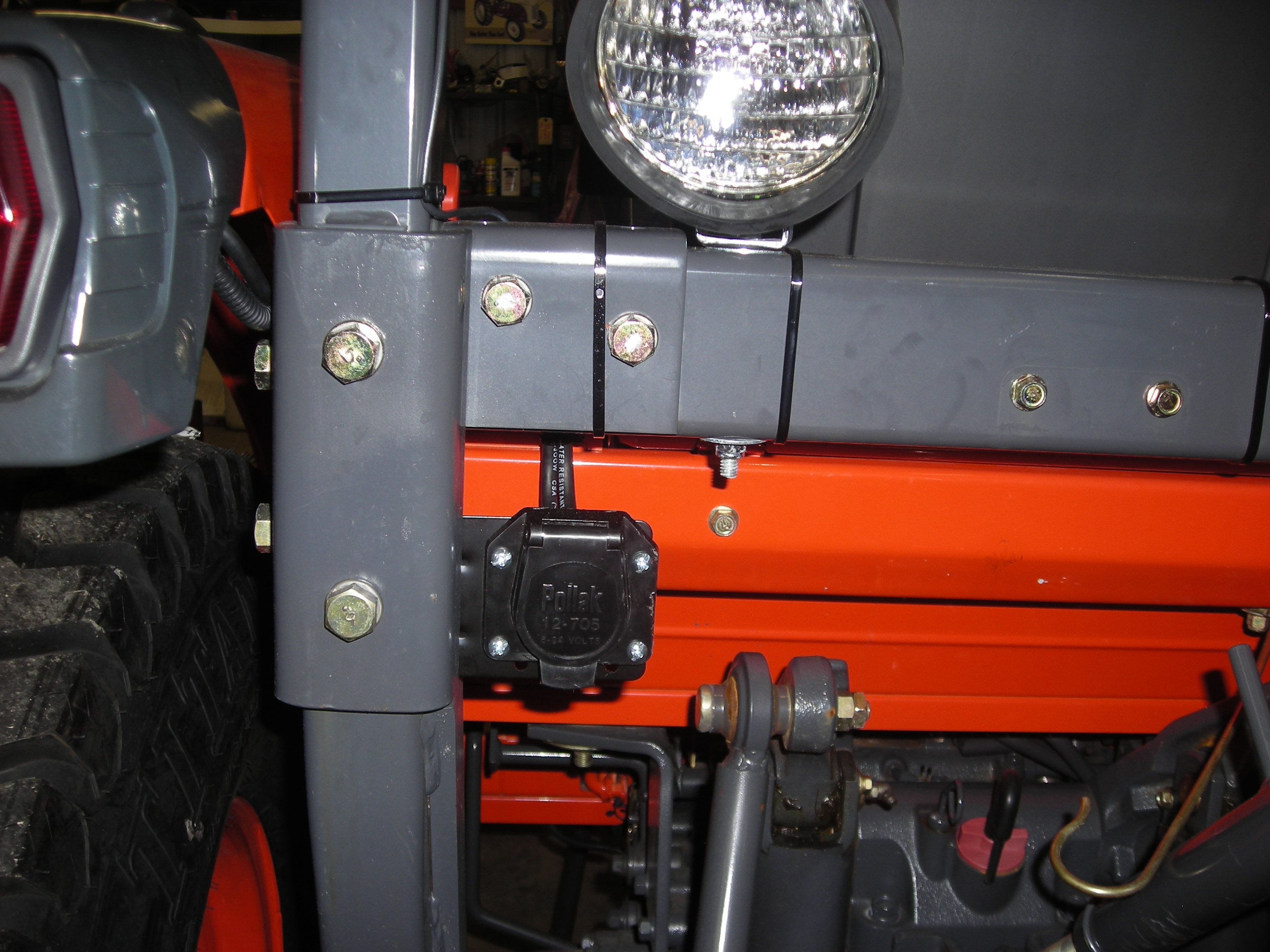

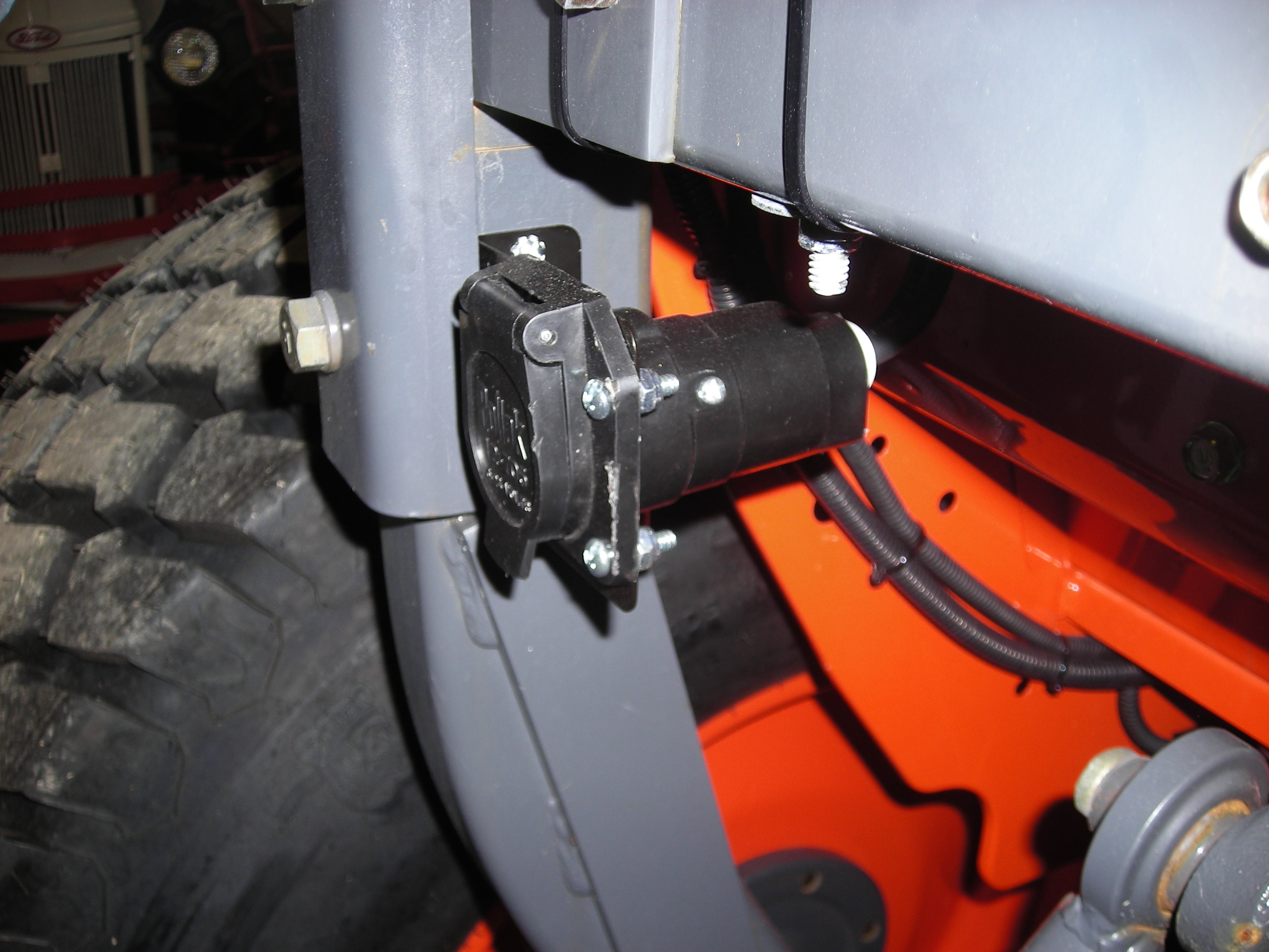

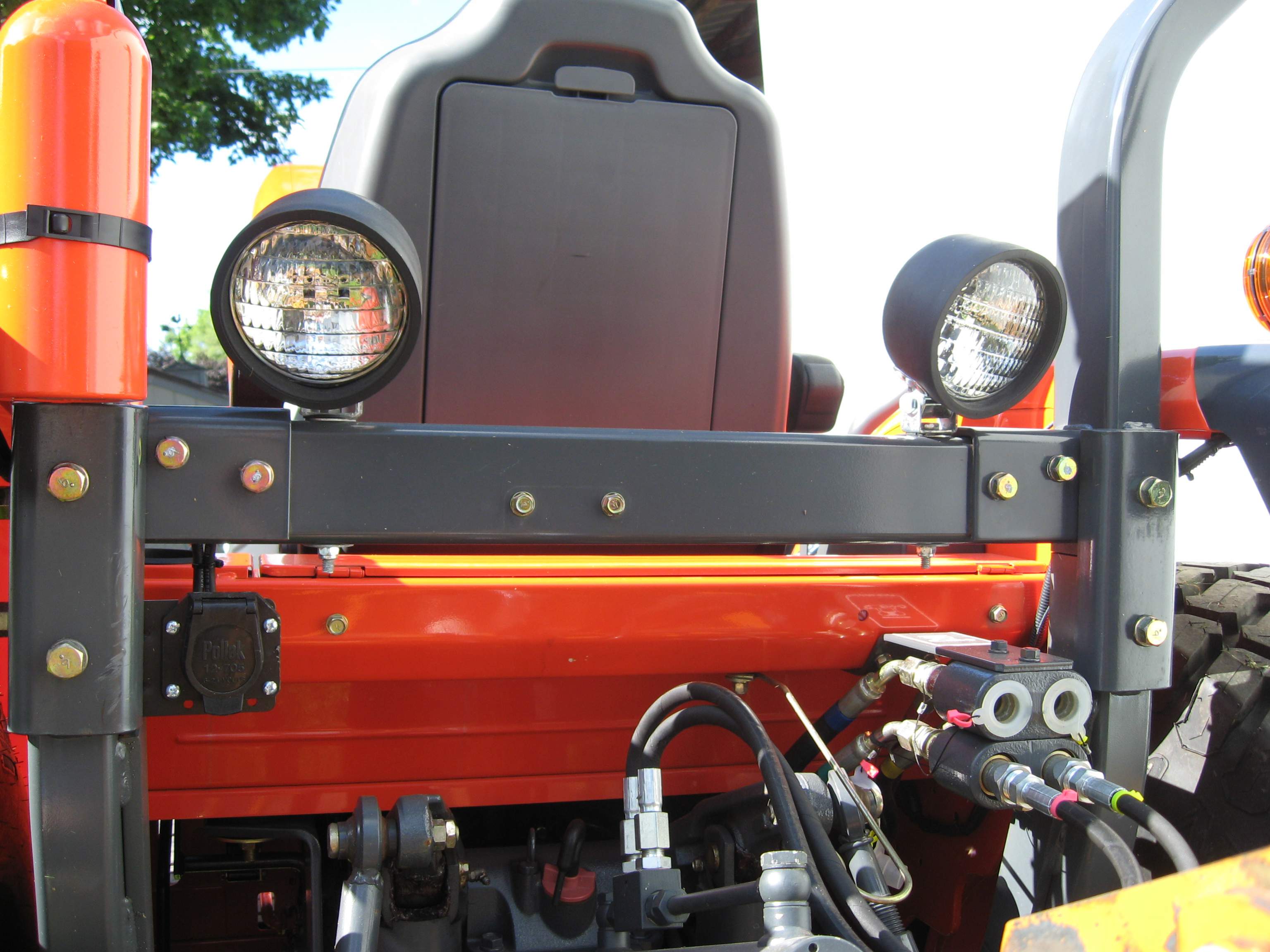

Here are some ideas. For power, I connected and installed a fuse at the starter. Philip.
