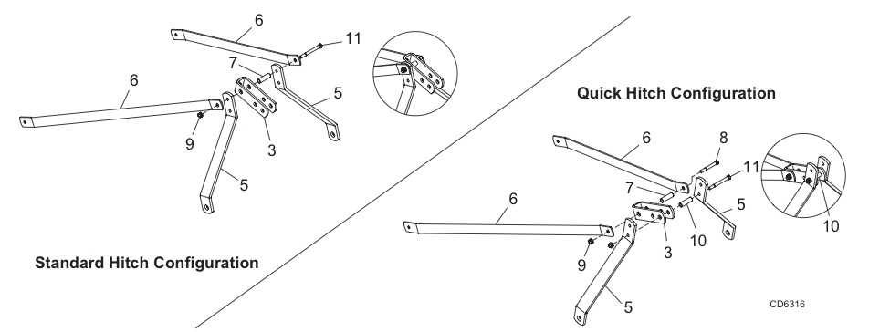

You will have to reconfigure your brush hog hitch. Here's one version.
The idea is to put the flex jount behind the A-frame instead of in front of it.

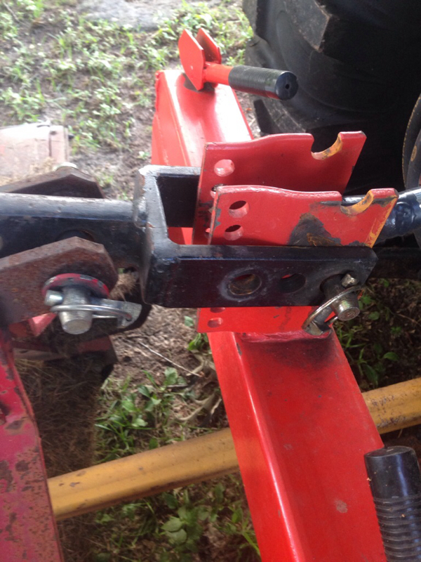

I don't use the top hook on mine, I just made an adapter and leave it on all the time. I have to get off anyway to raise parking stands or hook up pto shafts anyway. I switch implements a lot and it's not a issue.
