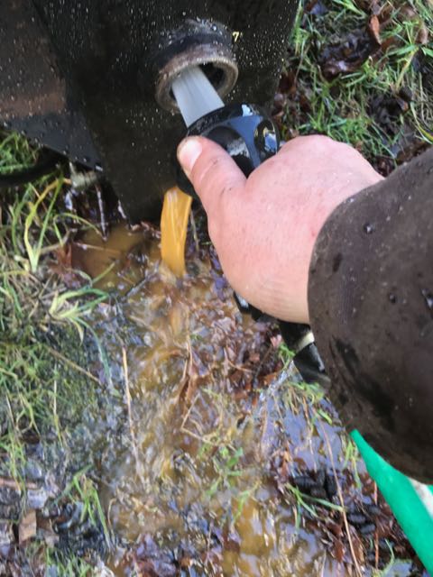

So took the tank directly over to the hose to wash out the remaining diesel. As you can see, it was not pretty. And this picture was after a 20 seconds of me standing there stunned.

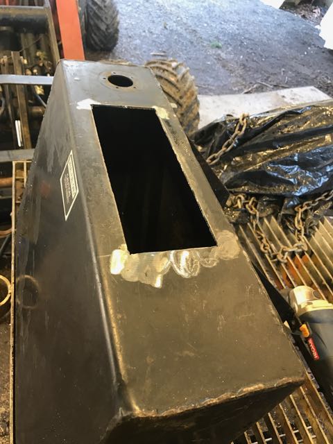

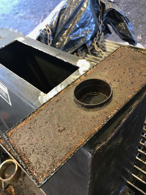

So took the tank back to the welding table and filled it with water, grabbed my plasma cutter and cut out my work piece. Then I drained the water, and found out that the space between the fill line and the top of the tank was very rusted. More so than the body of the tank, although the bottom of course had a bunch of rust.
Here is the top, you can see the rust. and you can also see the hole I cut...

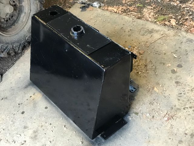

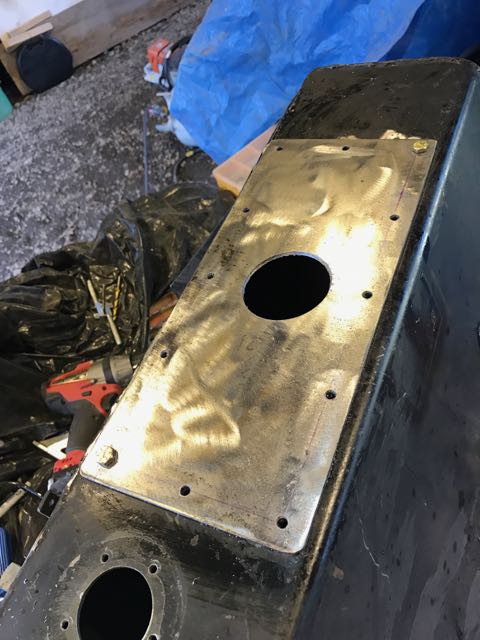

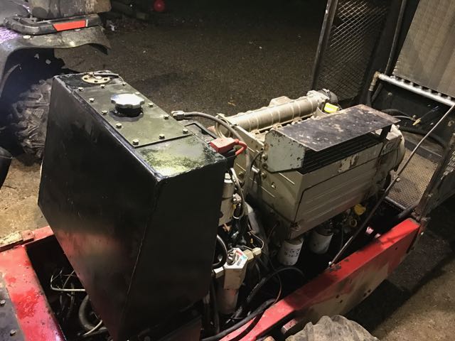

Got the new lid cut out, drilled and tapped the mounting holes (used 1/4" 28 thread as the normal thread is too course for 1/8") Welded the filler neck on (not photographed yet) and applied the POR primer. Outside of my engine issue should have this all buttoned up tomorrow night.
   / Rusted Gas Tank Repair and Motor Mounts

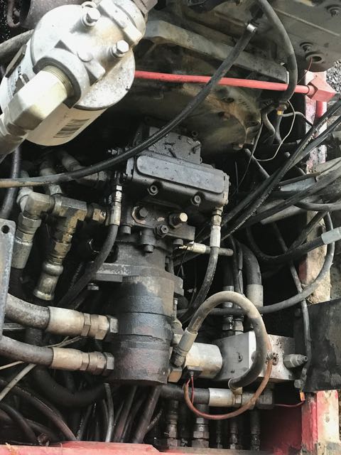

So, finally got it all back together tonight. I will say it is amazing how easy it is to get the tank off the 1850. Going to have to remember that next time I need to work around the engine.
Anyway, A couple pictures of the tank. Also a picture of what a typical day looks like. I do not have a barn or enclosed shed, just a carport which is open to the elements.

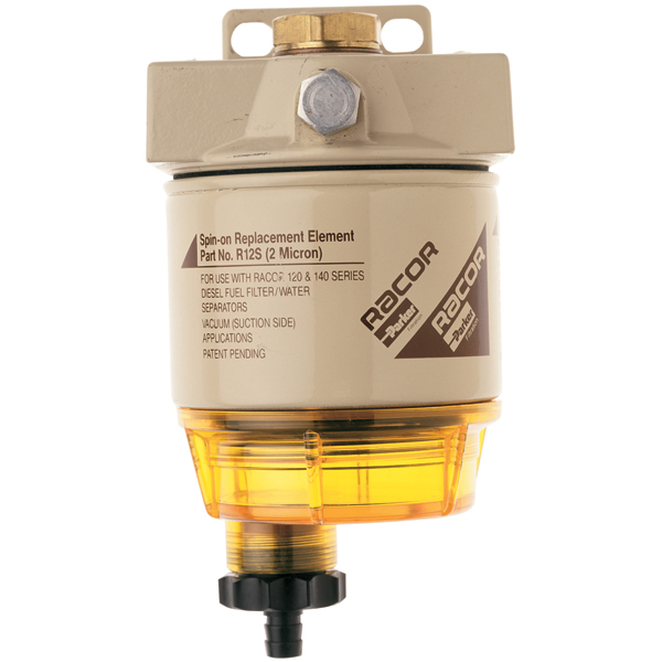

RACOR Spin-On Series Diesel Fuel Filters/Water Separators | West Marine
Nice job. How about adding this? Raycor prefilter.
It constantly removes water from the diesel. You can also add a fuel preheater to help on those winter days.
I have it on my CAT3126 that sits more than I would like to help get the water out of the diesel.
