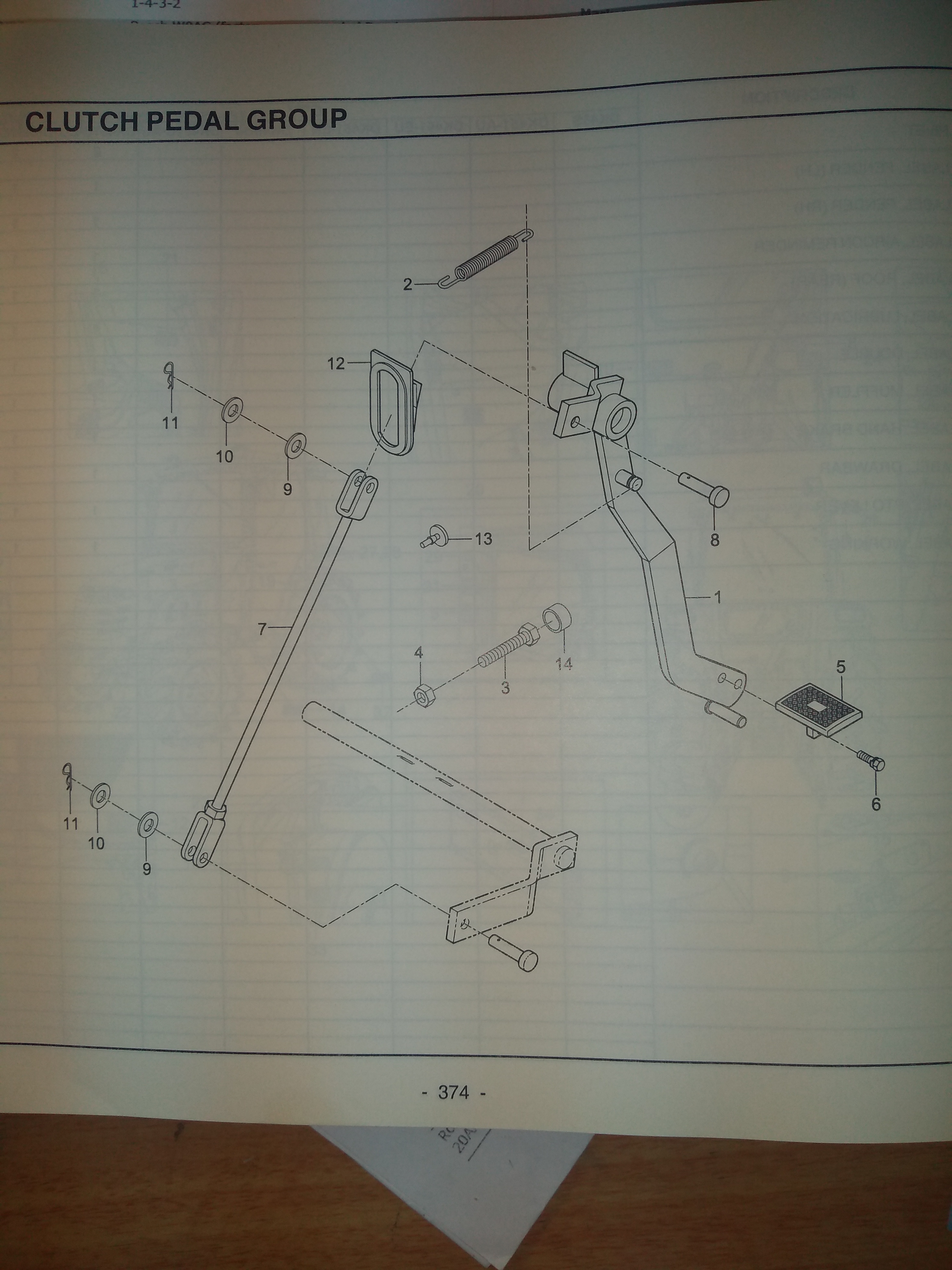

Yes, I do have a Cab model, but the clutch mechanism is the same for all the DK45 series (as far as I can tell). I have no earthly idea how that compares to a RX6010.
I have attached a couple of picts from my parts manual showing the "Clutch Pedal Group"
By the way, I was unable to open your pict of the cable
