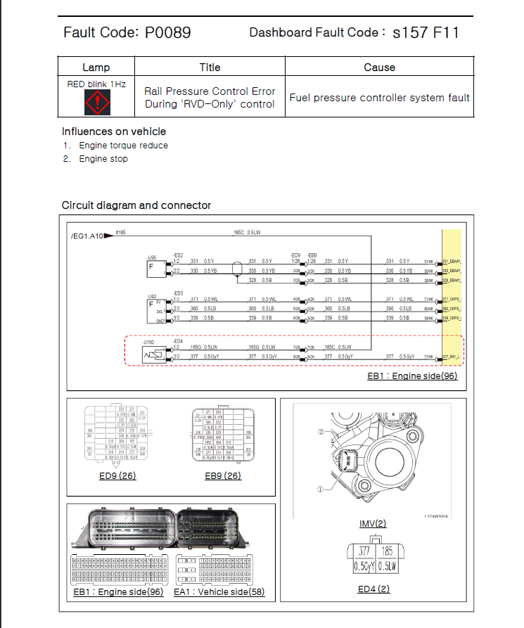

LS XR3135h
Can someone tell me if there is a sensor I can replace for the codes F11/S157 "rail pressure control error during rvd only control"
   / S157/F11 #2

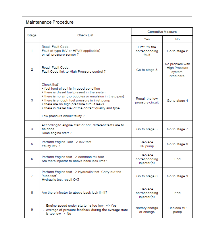

You're looking for part number 40265625. That tractor has two engines listed, the L3C19 Tier 4 and the L3CTRV Stage V engine. But the sensor is the same. The sensor is located on the end of the fuel rail. Should be simple enough to swap it out. Check your local dealer OR online resources like Messicks.....
Wait a second... The MT40265625 shows the entire fuel rail (with sensor included (for you're convenience, right?)). Looking back at LS Parts site it shows the number pointing directly at the sensor, but shows the entire fuel rail as well. I'm not sure you can order just the sensor.
Also, make sure your sensor is actually faulty. Especially before dropping $320 for a new rail. Looking a the good book, I found the screen shots below. Be advised that my manual is for a different, but very similar tractor. Hope this all helps in some meaningful way.
