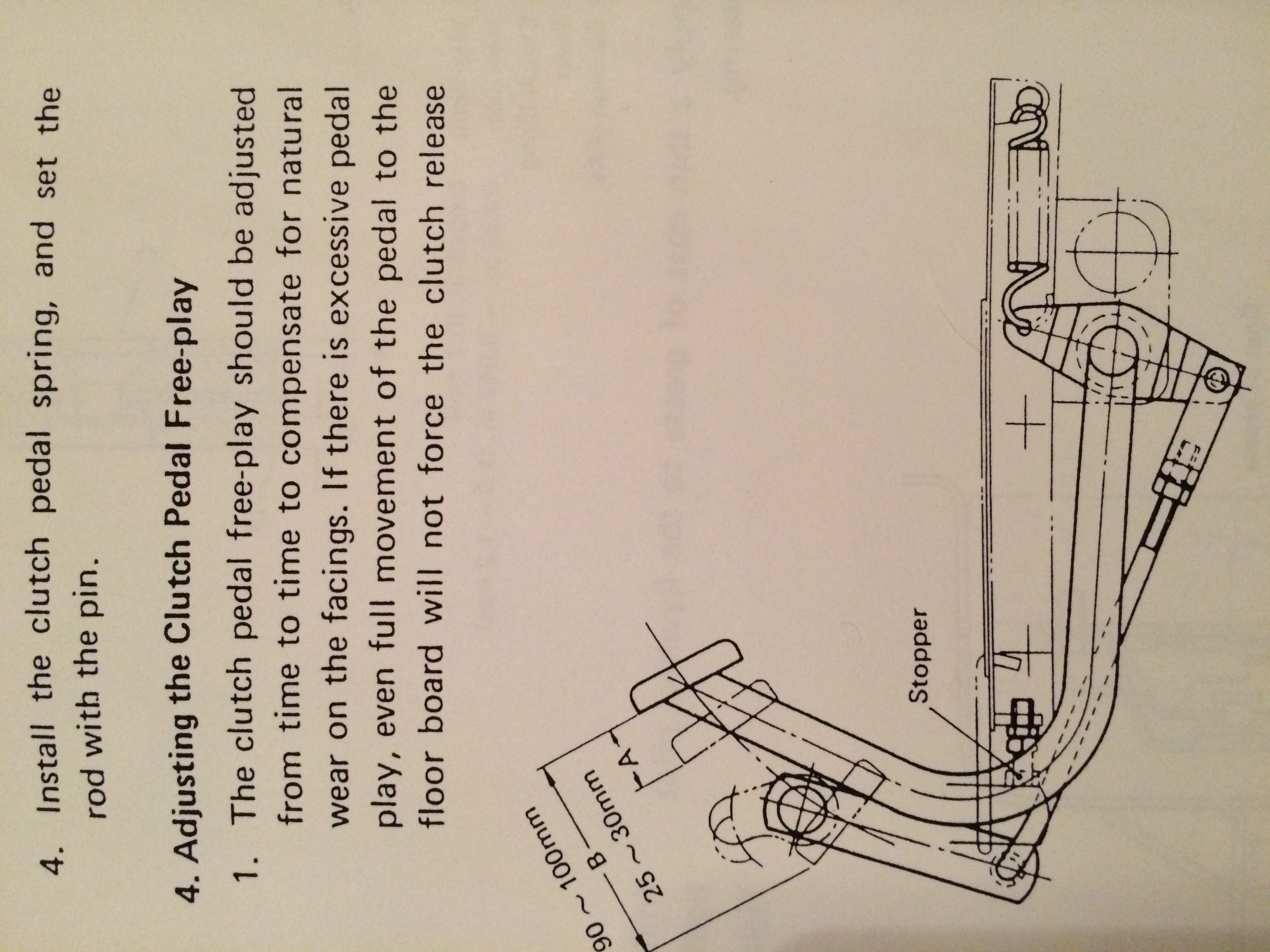

Hey folks, couple of quick questions. Changing the pilot bearing, anyone know the torquing specs to tighten the flywheel back on? Second, is there adjustment somewhere on this machine for clutch pedal ,post install on a new clutch pack, including throw bearing?
   / S370d 4x4 satoh beaver ,1984 #2
Flywheel mounting bolts - 83.1 - 90.3 ft-lbs. There is a procedure in the manual for adjusting the free-play of the pedal. I took a picture of it, and as soon as my phone, and pc sync, I'll upload it to you------------- John
   / S370d 4x4 satoh beaver ,1984 #3
Finally found it!: IMG_0757[1].jpgIMG_0758[1].jpgIMG_0759[1].jpg Let me know if it works for you!--------------------- John Oh, yeah.... also torque specs for different bolts

So shipping and time to arrive in Canada, had a machine shop drill the center of the fly wheel to marry up a bushing with the ID to match the od of the drive shaft. Left a slight shoulder inside the flywheel so the bushing can't be pushed thru on re assembly. Tried the drive shaft new throw out bearing. Took the shaft off the the tranny and used as a pilot to re assemble clutch pack. Then re assembled the entire tractor, try it tomorrow once electrical and fuel systems are back in. Wish me luck
