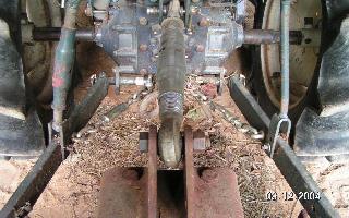

   / S373 Beaver sway chain solution
Here is the connection between the left lift arm and a mounting lug on the left side of the tractor. You can see how the lift arm bolt has been scraping the left rear tire.
Noticing the couple of pictures I've seen of other tractors, the sway chains are mounted on the inboard side of the lift arms, while mine are on the outboard side. From the looks of my picture, it doesn't seem like my chains can restrict sway very much at all. So how are they supposed to be mounted? I found some turnbuckle type chains at about the correct size. Expensive at about $50 apiece at a local John Deere dealer.
   / S373 Beaver sway chain solution #6
Yours are hooked up properly except it looks like you are just missing the turnbuckles. Mine is the same as yours. The tab on the front part of the chain is getting worn pretty much with an egg shaped hole. It doesn't hold as tight as it should but there are no longer any issues with the arms hitting the tires. If you have chains only, you don't have any adjustment to make. One of my tractors has homemade adjusters that I made with some 1/4" chain, a double clevis, some all-thread and a stack of nuts welded together. This arrangement is not as quick as a turnbuckle cause I have to take a pin out of the clevis to remove the chain so I can adjust in or out on the all thread. I have to learn how to post pictures.

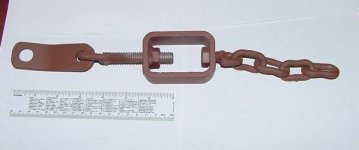

   / S373 Beaver sway chain solution #8
I don't have photos of the latest set I made, but I have now fabricated 2 sets of turnbuckles. Well actually they are "half turnbuckles" since only one end has a threaded connection so that I wouldn't have to use any left hand threads. I have attached a photo of the first set I made - which ended up being too light and stripped the threads. The next set I made, I used larger bolts and nuts.
Basically, they're made from 1/4" thick 3"x2" rectangular tubing, with a hole drilled on one end to fit a bolt through loosely - this one just turns in the hole. The bolt is inserted from the inside, and a link of chain is welded to the threaded end. The other end of the rectangle gets a threaded hole, and a nut welded on the inside - in fact I think my second set had two nuts welded on top of each other on the inside. Then a piece of all-thread with another chain link welded to it is used. It works well, though it is slow to adjust.
Greg
