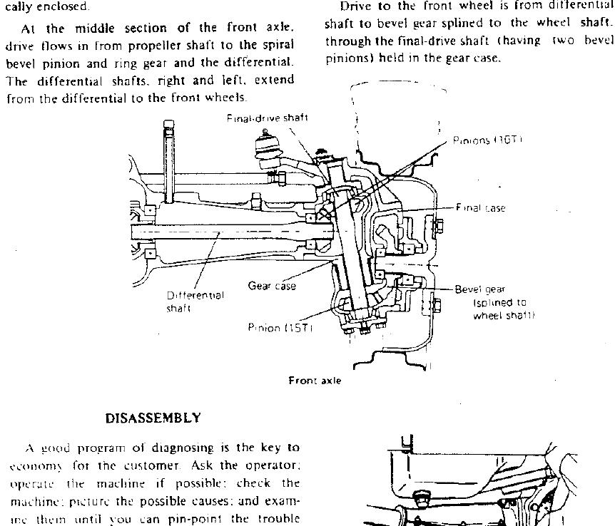

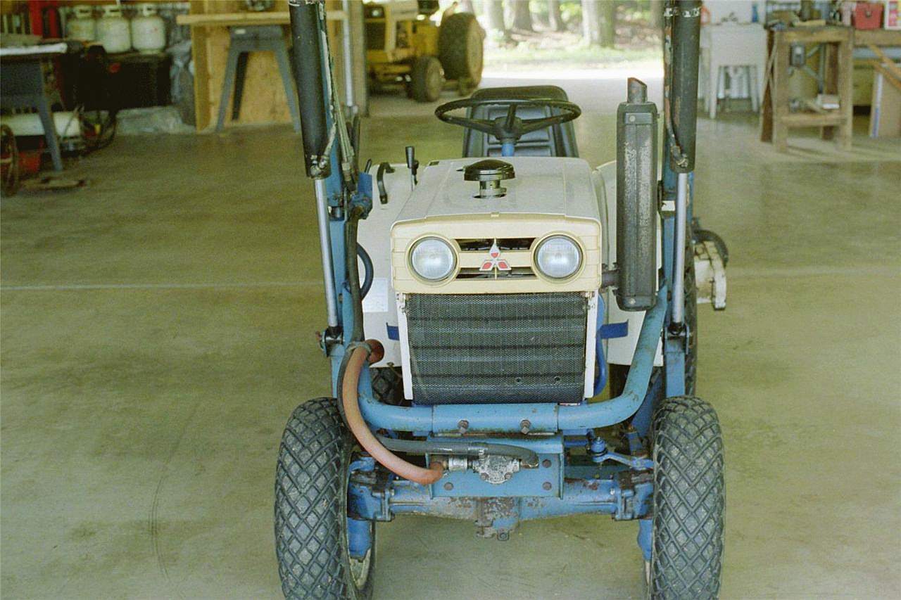

Anyone ever gone through and replaced them? When I got the tractor the front spindle/hub areas were all greasy, and the level in the front axle is way down. Want to get some fluid in there but not if its all going to leak out again.
Its more of a step down design then some of the other tractors with the big ball shaped pivots like on the S370 I believe.
Not mine, but an example attached.

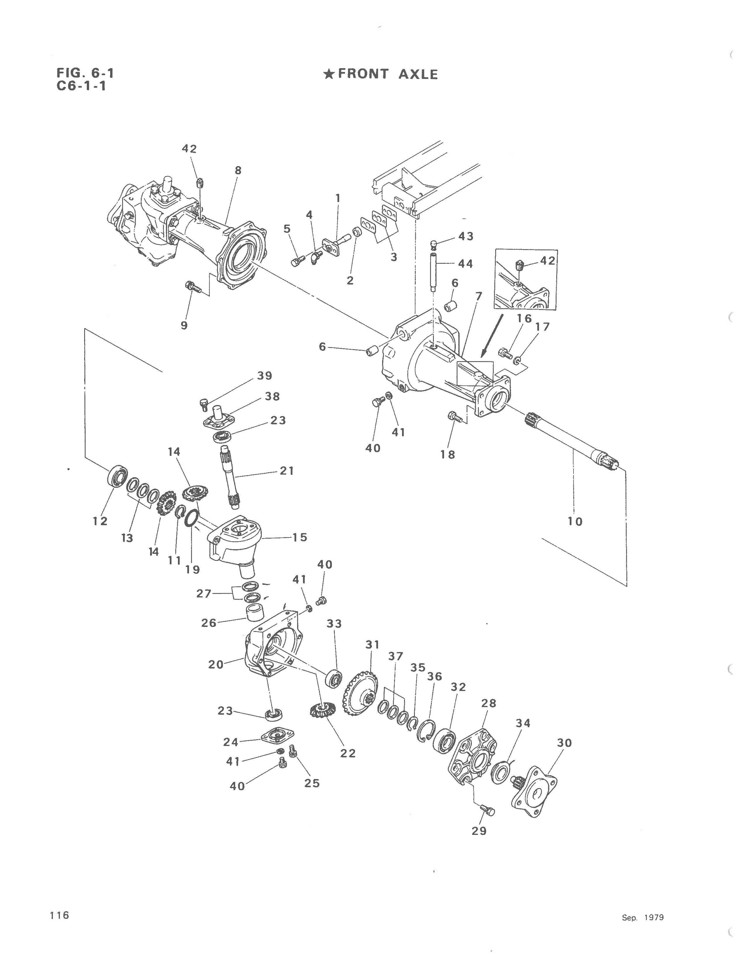

Yeks, anyone ever tried Valley Power or others for the seals?
How many are there per side one would want to replace?
Here is the diagram from the shop manual.

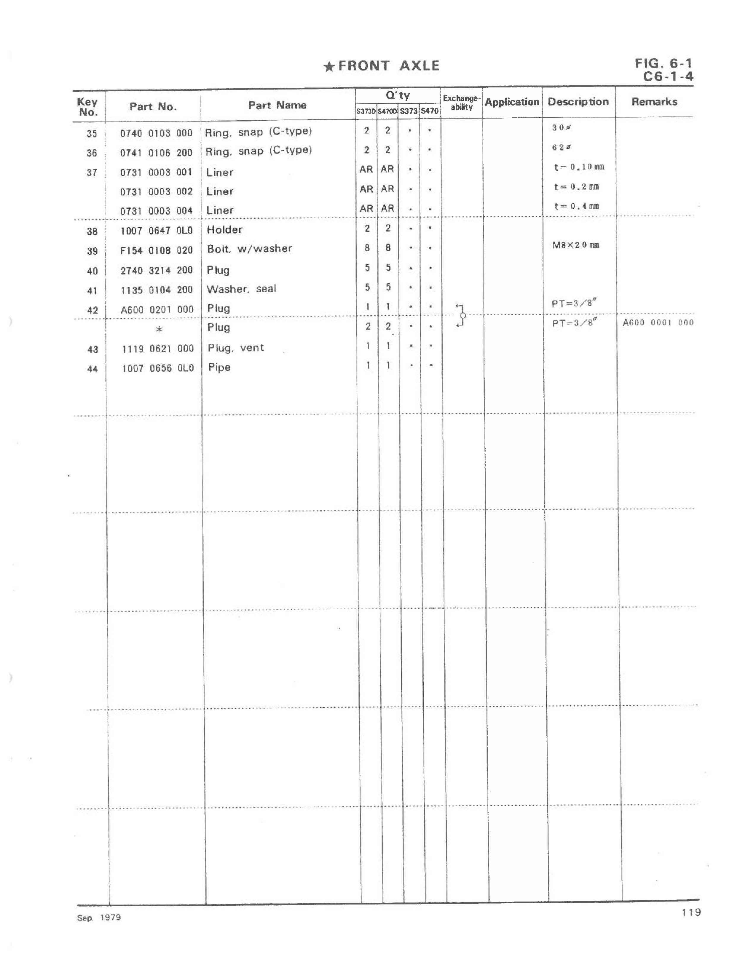

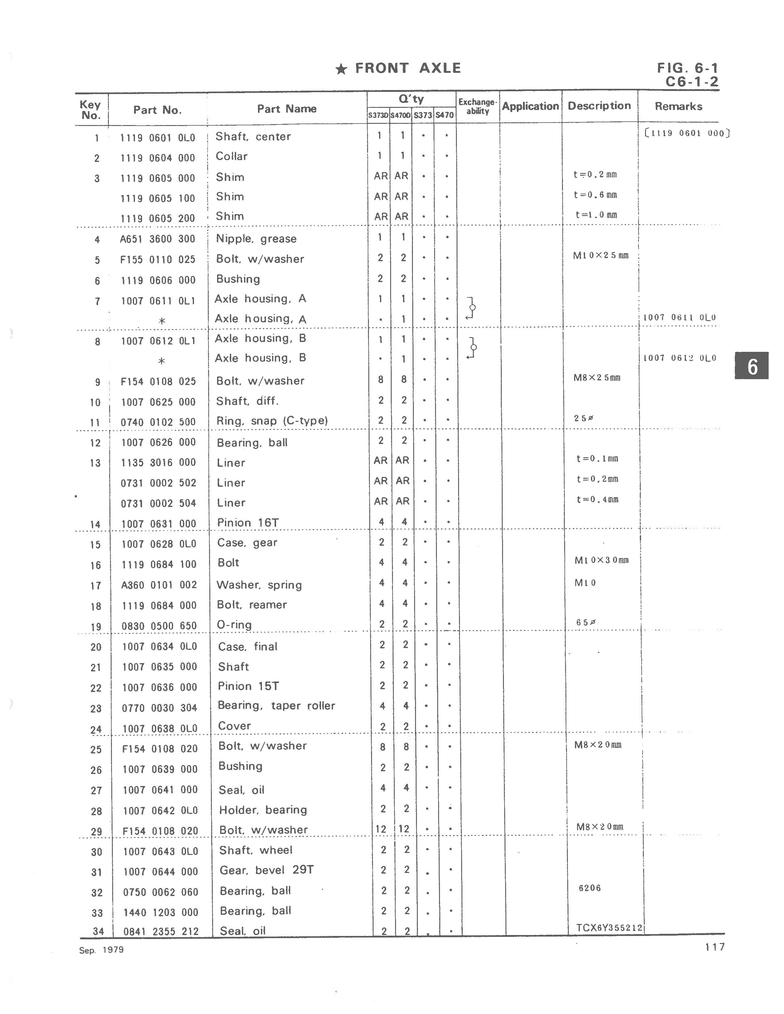

   / S373D 4x4-front axle seals #7
There are only two seals (if you count the P/N from my last post as one) and one O-ring per side that goes from the final drive to the axle housing. See attached....

   / S373D 4x4-front axle seals #8
I replaced 2 number 27's on each side. That was where it was leaking. Also replaced the bushings, #26. I got the parts from Valley Power and don't think the seals were all that bad but it was a long time ago.
#9
What seals the cases together like 7 to 15, 38 to 15, 28 to 20? Just RTV or is there gaskets there, dont see gaskets on the breakdown.
I suppose it wouldnt be a bad idea to replace seal 34 as well.
