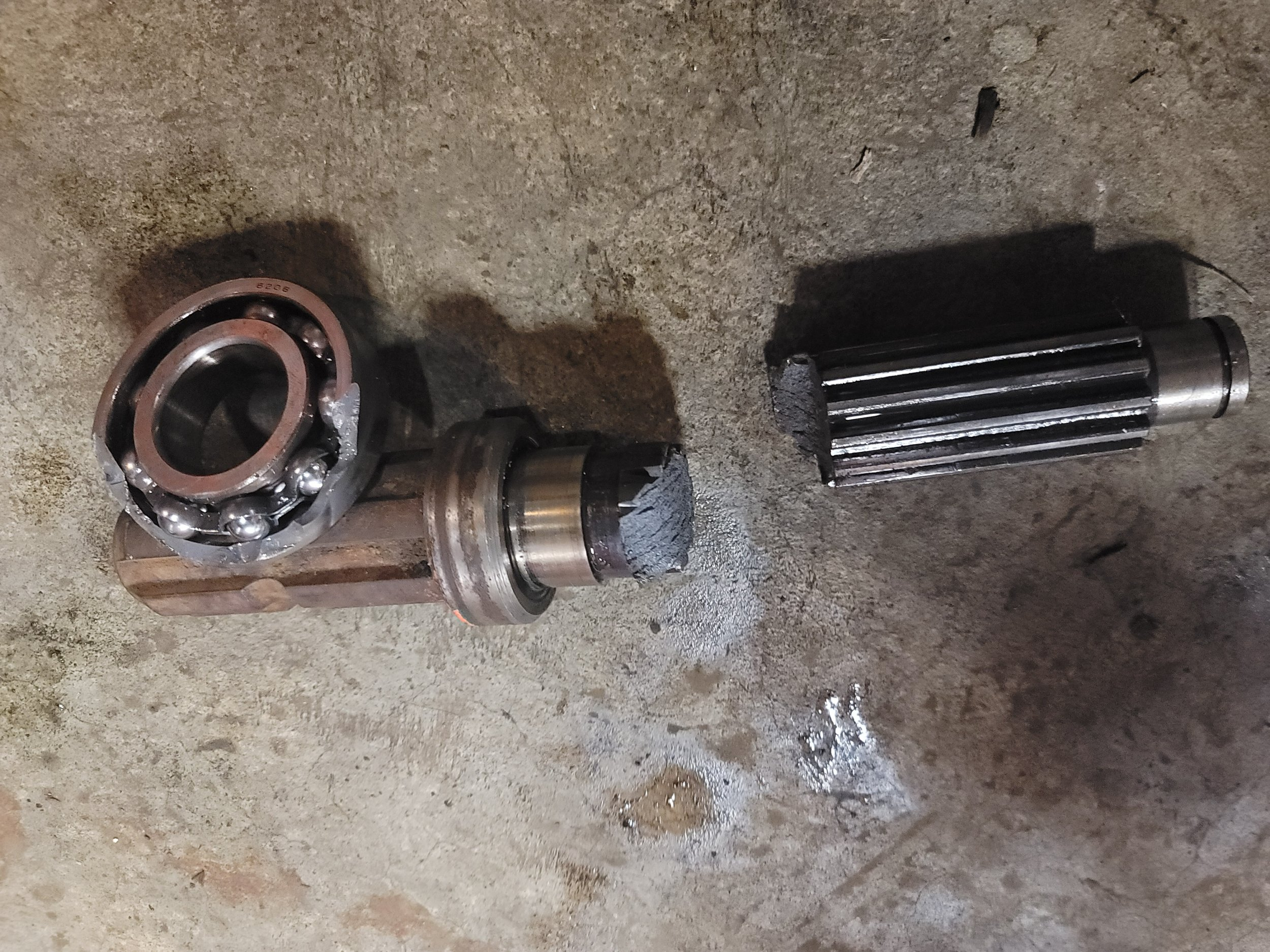

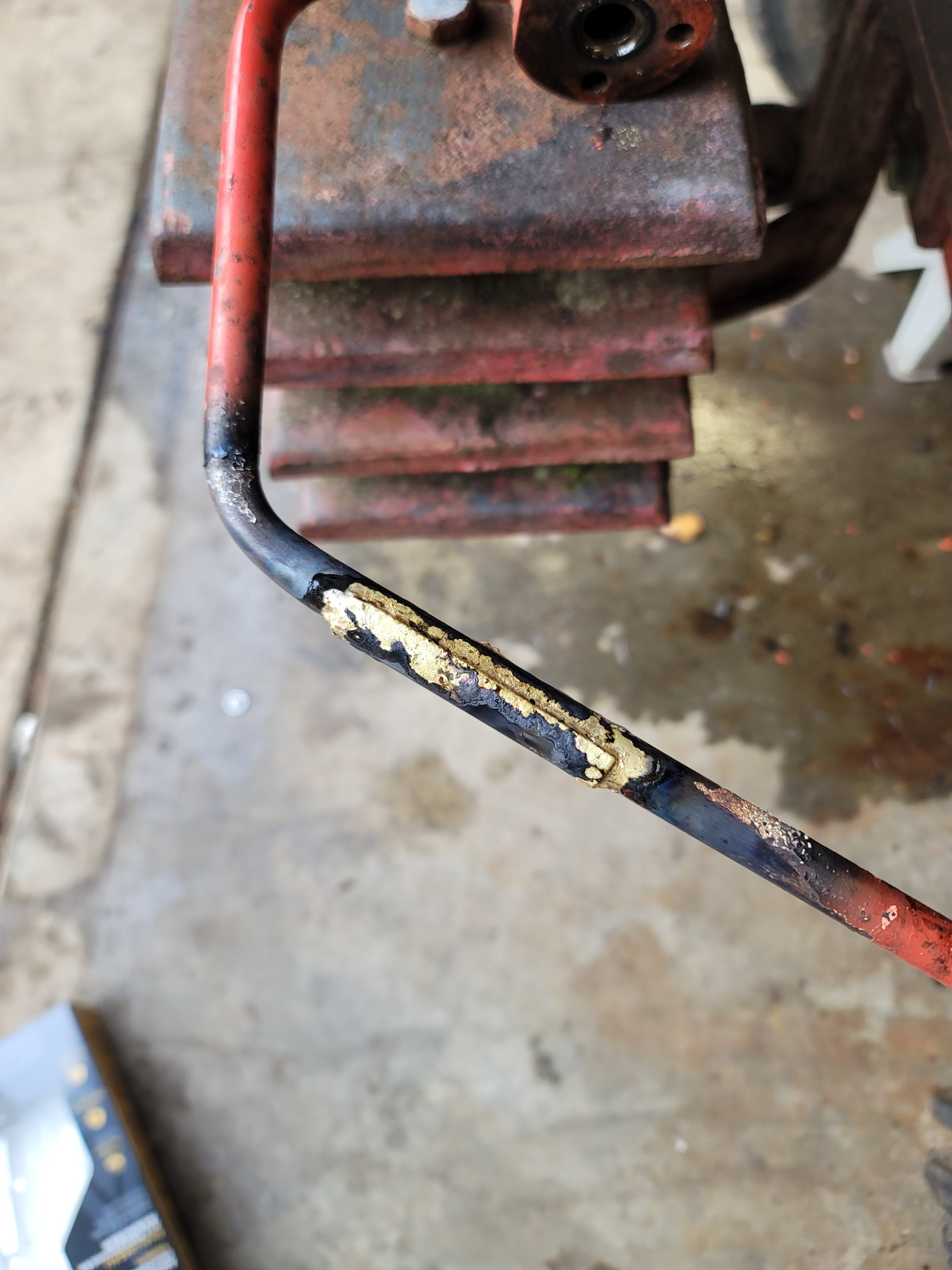

So a quick background: I picked up my first tractor, a rough shape S550G, a few weeks ago for a couple hundred bucks. The condition was pretty typically bad, engine "seized," wheels locked up, rims rusted through, etc. I got the motor freed up, luckily was just a frozen alternator. The fuel system was gummed shut in most places so I cleaned the fuel tank, cleaned the carb, converted the fuel pump to electrical, replaced the coil, installed a battery and now she purrs like a kitten. I was able to pull the brakes apart and get them freed up and working again. Today I brazed a hole in the hydraulic line, so fingers crossed that works. Next up is replacing the PTO output shaft. I have no real plans for this thing once I'm done. I'll use it around the properties or sell it, or build a loader or who knows? I just enjoy projects I guess.
I was able to find a replacement on Ebay. Anyone ever replace one of these PTO shafts? Anyone own an S550g? Anything I need to know? I really appreciate the knowledge on this forum and figured I'd try to add something here.

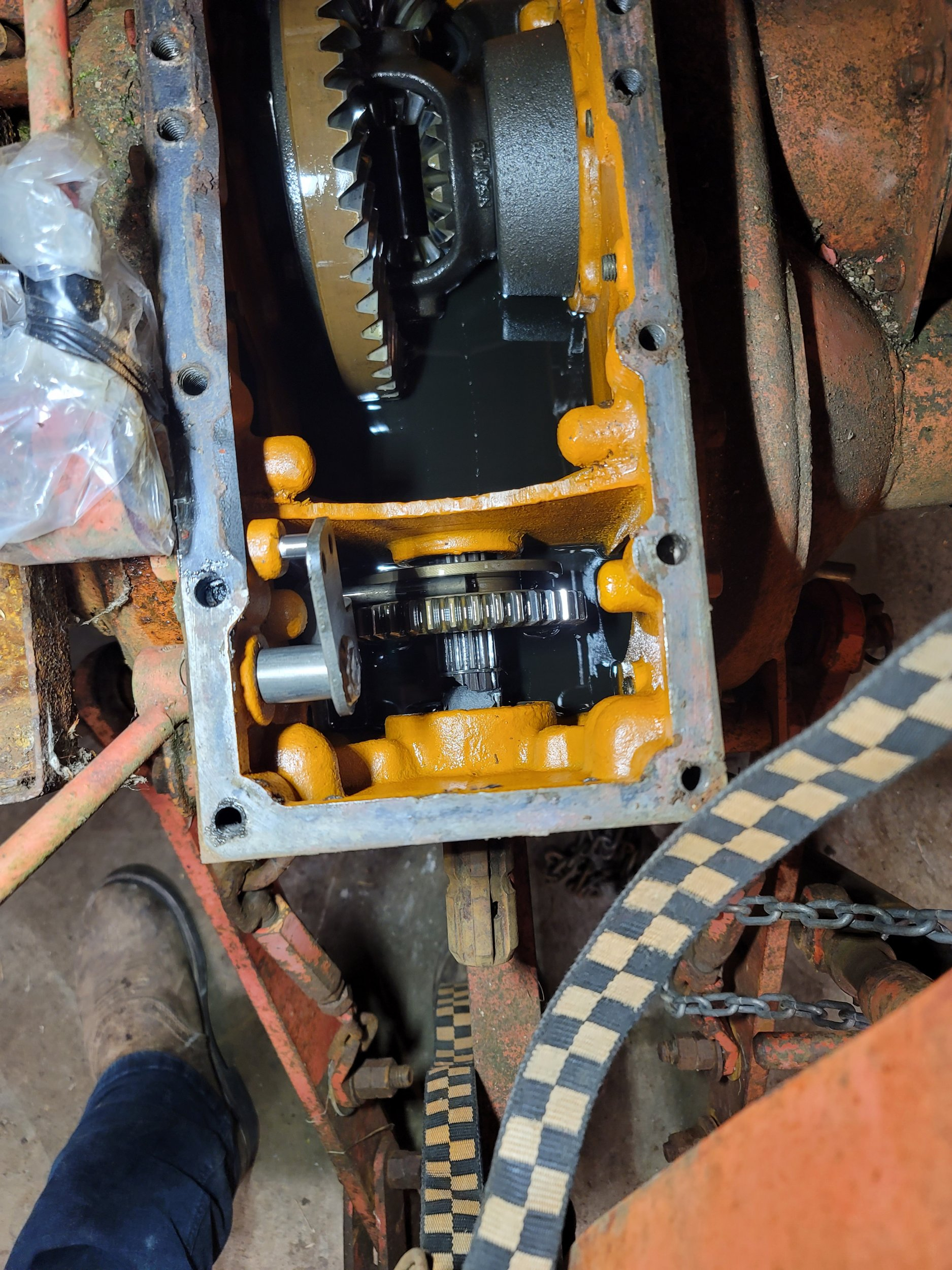

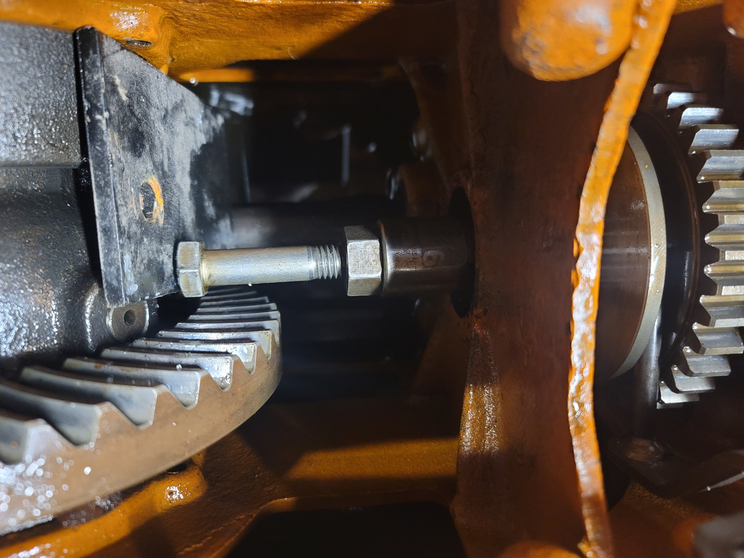

Got the broken PTO shaft out and the "new" one installed last night. What a pain that was! I'm really curious how they did it in the factory. I ended up installing the shaft through the rear bearing with the engagement gear, adding the circlips on the rear bearing, then pressing the front bearing in by loosening a nut and bolt between the shaft and the differential against a piece of scrap 1/4" plate. I had a lot of choice words while knowing there was some easier method or tool I was missing. Either way, it's all in and freely spinning now.
I need a new PTO shaft seal. For anyone else needing one, it looks like a generic 62mm x 45mm x10mm rubber seal. I ordered one offline and will test when it arrives. For future reference, the forward PTO shaft bearing was a 6204 and the rear was a 6206. I was able to get them in stock at my local NAPA.

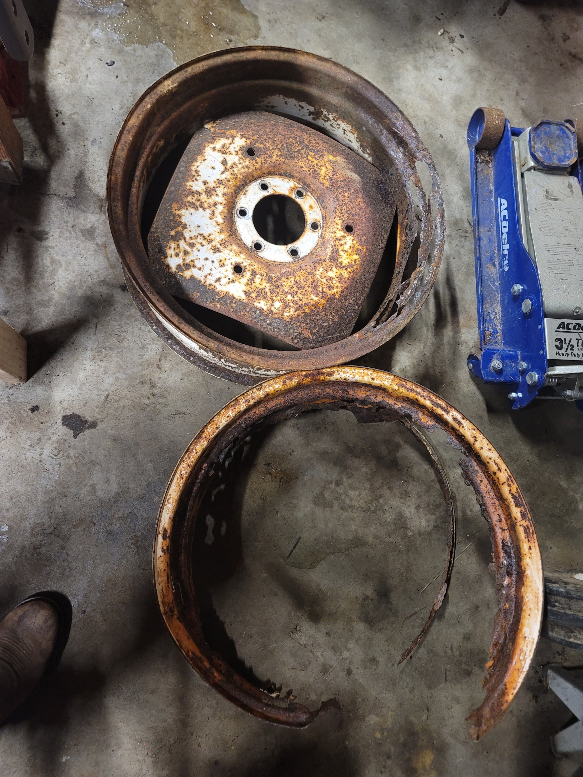

I managed to get the tires off what's left of the rims. Next up is trying to combine two rusted wheels into one good one...
