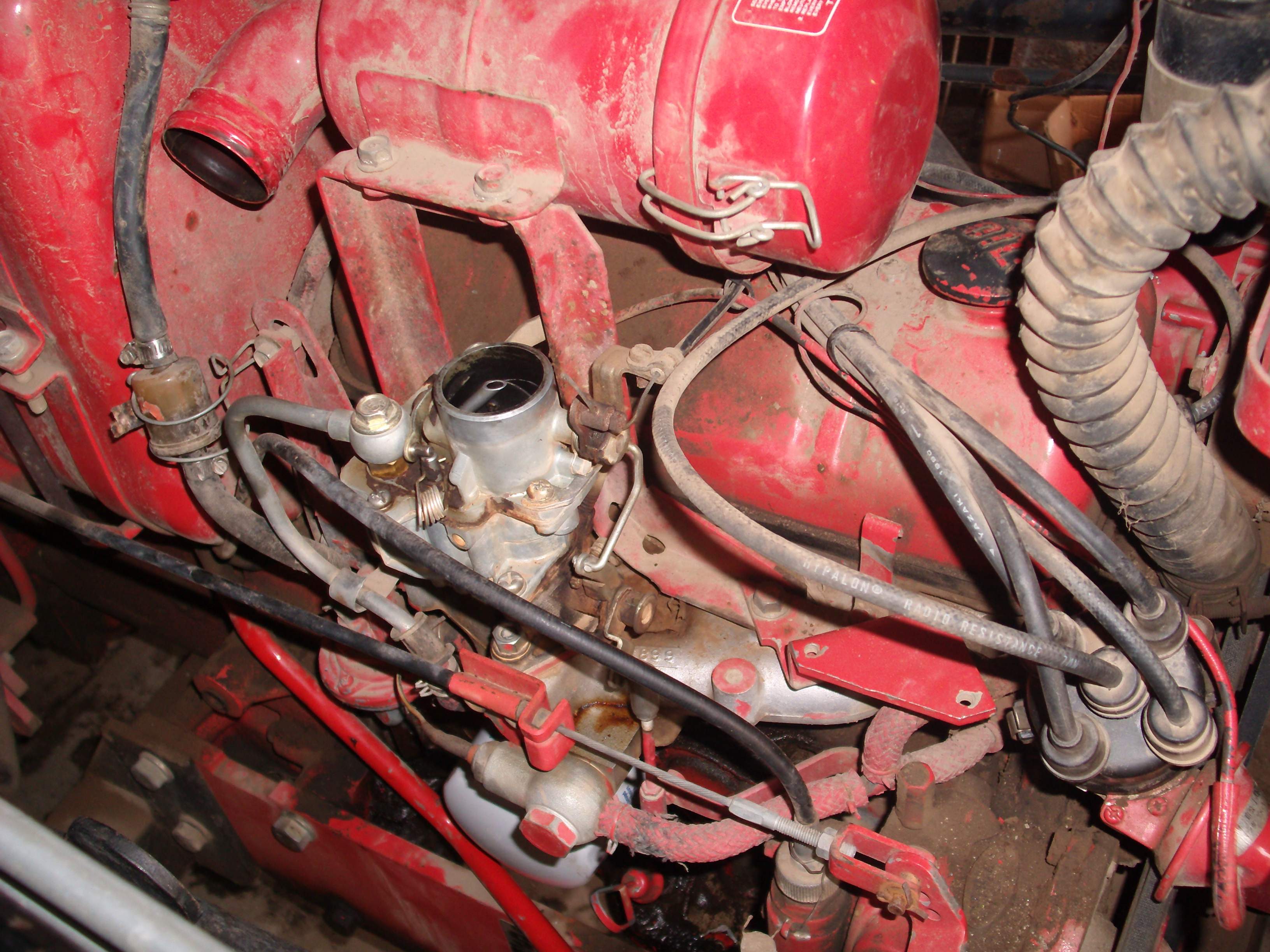

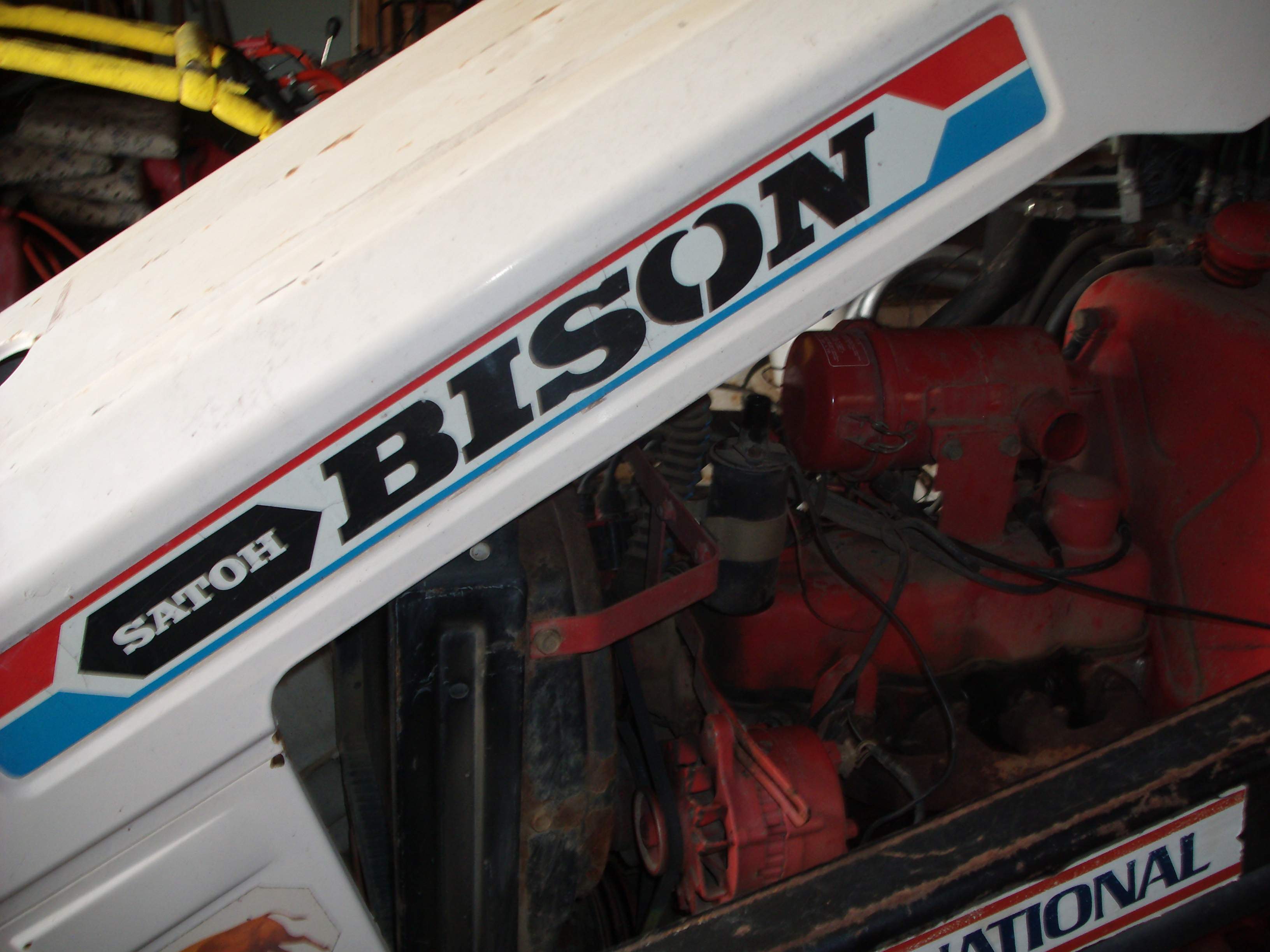

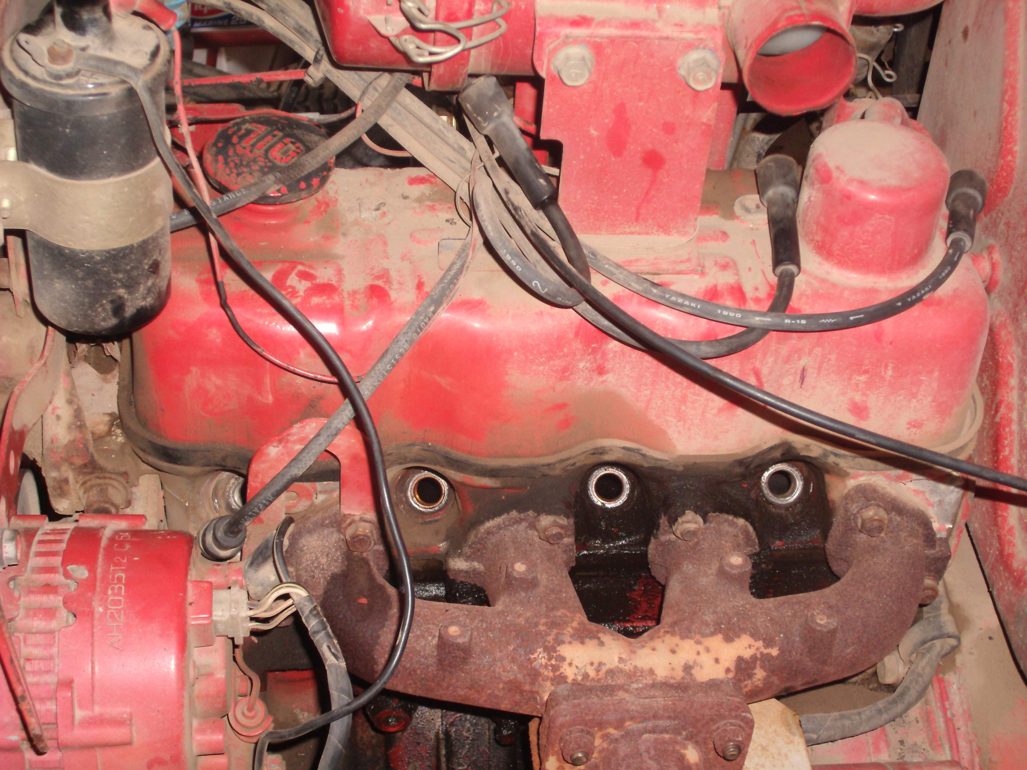

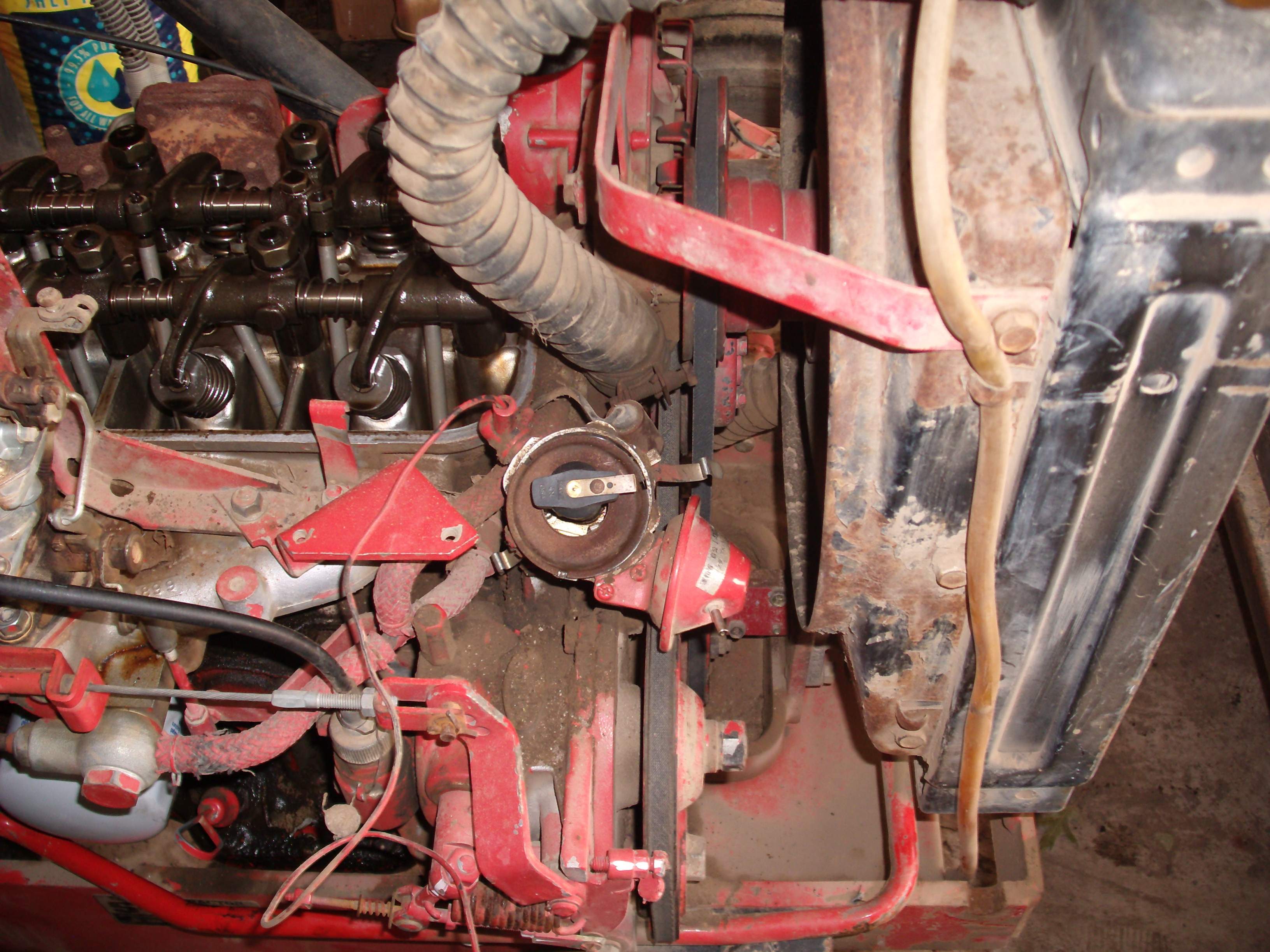

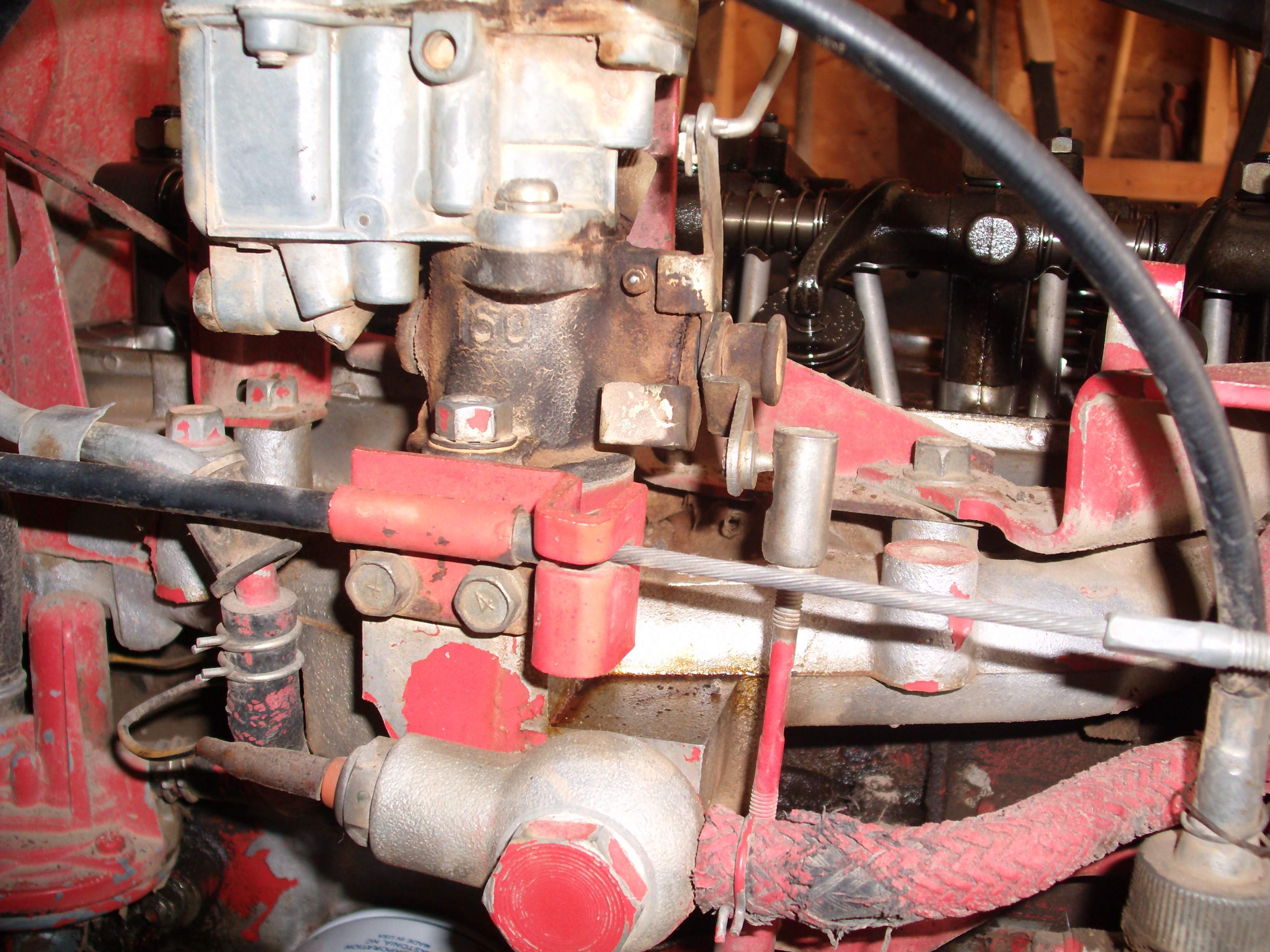

Sometime even a blind squirrel gets a nut!I pull the valve cover off this thing,crank it,and the 2 middle cylinder rockers aren't moving-Why?The pushrods somehow were either not put under the rocker arms,or they came out.But the valves are all in adjustment.I put it back together,turn it over and it runs like a beast-The guy bought it running on 2 cylindersfor 2,000 with a rototiller and front loader!Not bad.By the way,does someone know which motor this is by looking at it? Sitoh 001.jpg
