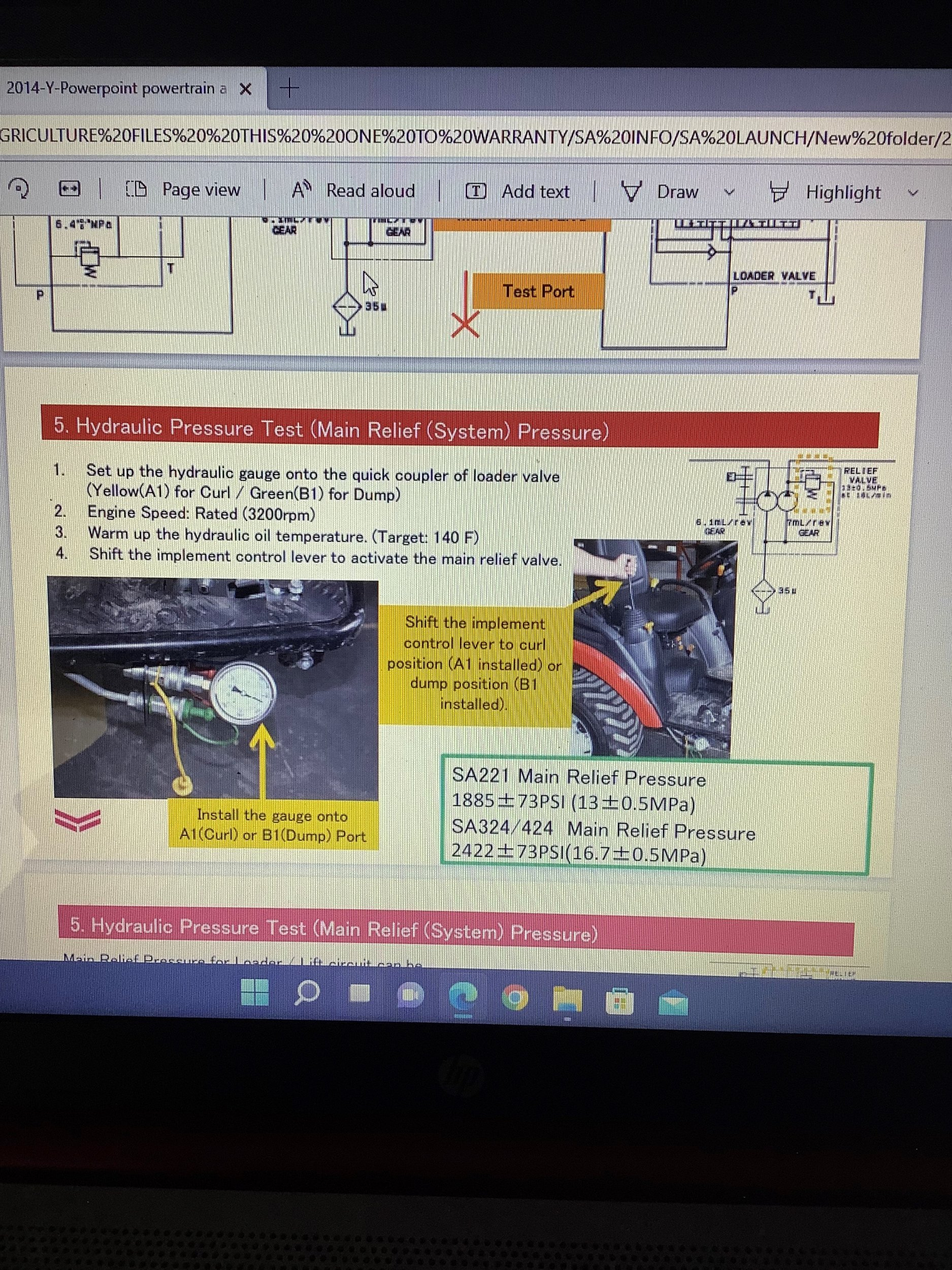

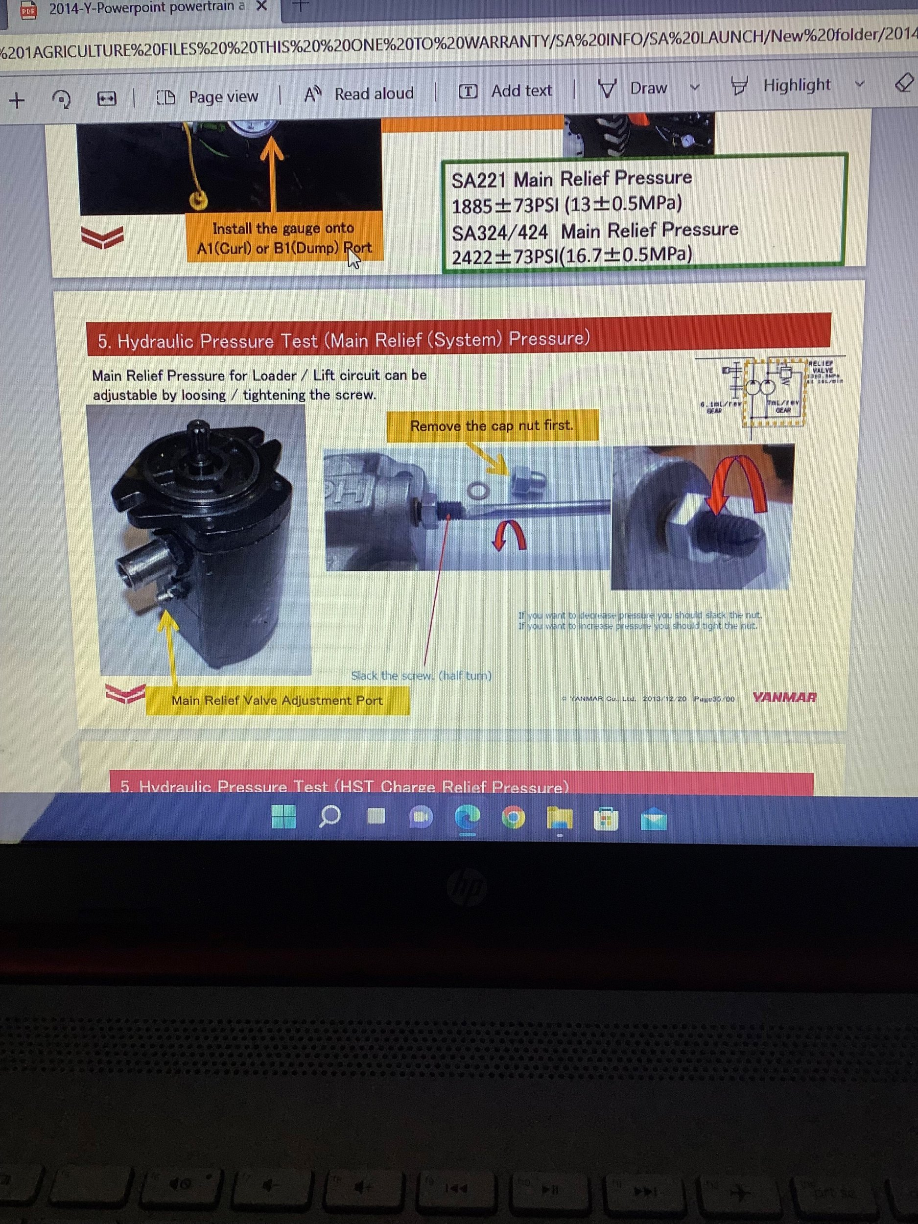

Has anyone adjusted their hydraulic pressure? I checked mine at the loader and it was 2200psi, specs I saw say 2429psi. Wondering how hard it is to do.
Thanks
   / Sa424 Hydraulic pressure #2
Thanks

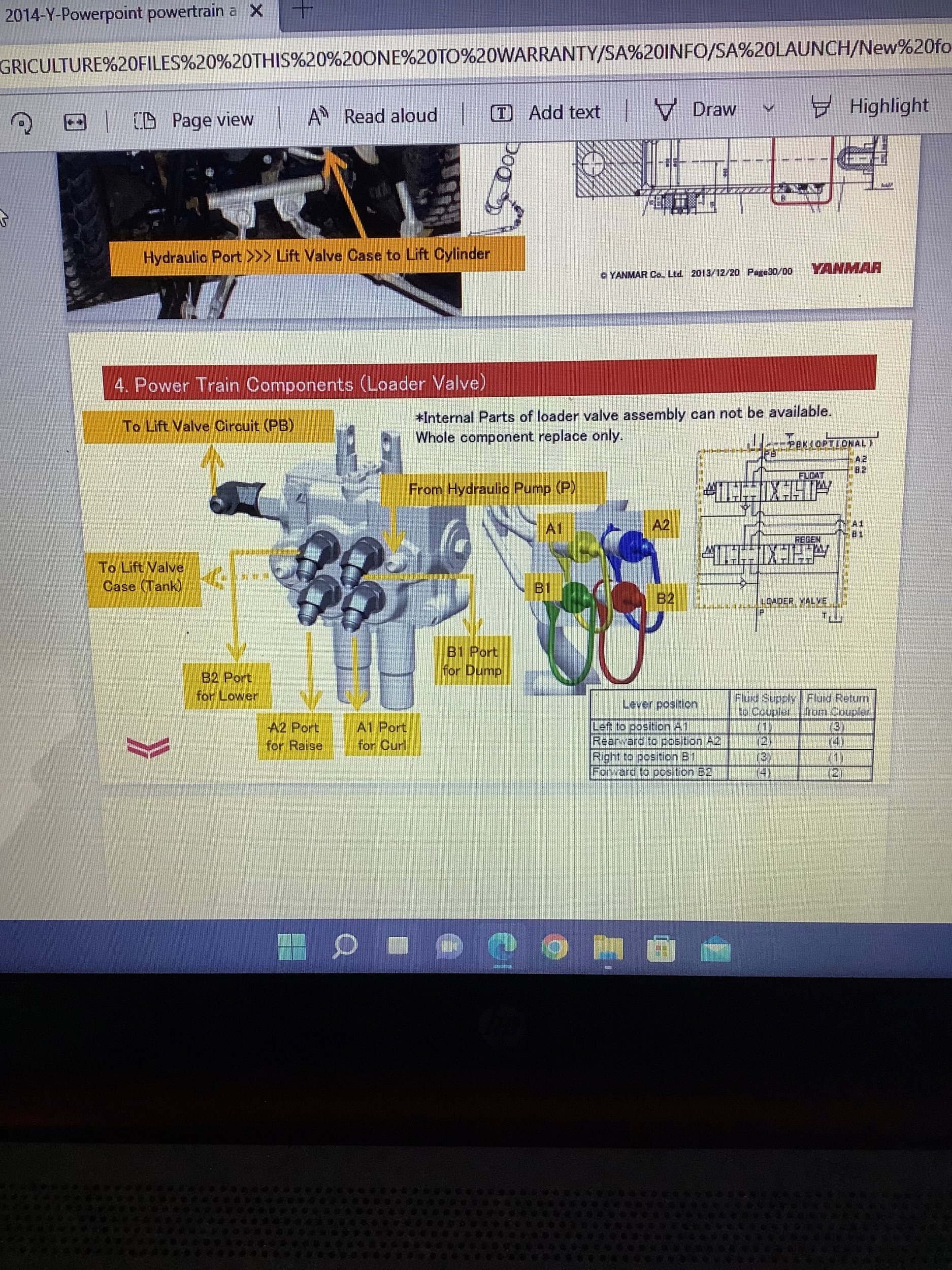

jrjeep7, Please see attached pics, your 2200 is pretty close to their spec range of plus and minus
as you can see

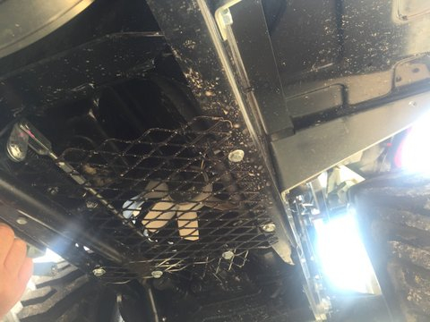

Yes, from manual, Also don't forget to ck the trans fan at the end of the driveshaft, needs to be in one piece to properly cool the trans. They make a kit to protect it or you can install a screen as in the pic, this is what a few dealers did before the kit came out, it keeps the tall grass and small wood branches from breaking the fan blades off. The fan blades cool the trans. you should also ck periodically that the fins on the trans are open & not clogged.

I checked mine its a 2019 and their is a guard on it from the factory, I will keep an eye on it thank you. Only have 140 hours so far, I find myself using it every weekend its hard to remember how I got things done without it lol.
