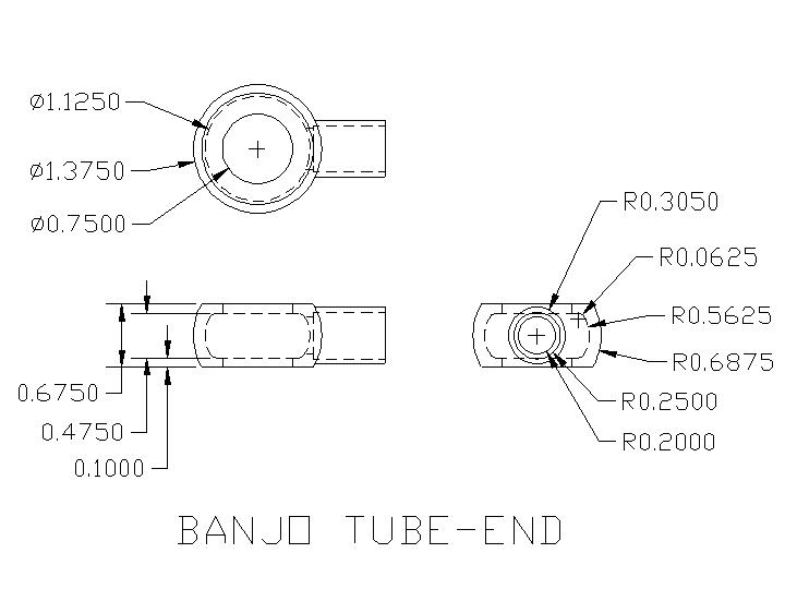

I captured a reasonably detailed drawing of the banjo fittings that JD uses on the 790 and others in Autocad and by several steps of conversion was able finally to get that into a JPG tha tI can upload here. If anyone wants the autocad or a dxf, email me at:
tomrscott at sterlink dot net
and I'll be happy to email it to you. /forums/images/graemlins/smirk.gif

Well I guess this drawing is going to come in handy after all. Looks like if I want a banjo fitting, I'm going to have to fabricate it.
I cannot get the company in India who makes these to respond to my requests. I got one rather cryptic email from them in which they appeared to be saying they weren't interested in any small orders. I found one place (Summers Rubber Co.) that seemed to have some metric banjos with hose barbs that might have been close enough to work with, but they turned out to not even remember they had them in the catalog, didnt' have any stock, and couldn't tell me how much they would cost or how long it would take to get them (probably ordering from the same company in India!).
So I stopped by my local second-generation family-operated steel company (Newberg Steel) and bought a piece of 3/4"x2" steel bar stock two feet long. Cost about $12 these days with the price of steel, but that's cheap compared to the cost of fittings.
One thing that finally kicked me over the edge, was a decision that I will make one with a second tubing port located 90 degrees radially from the first port so I can TEE my second "return to tank" line into the existing line. I think that will actually be easier than making a TEE, as long as I am making the banjo anyway, and it will make for a bit cleaner installation. There was not going to be a lot of clearance for a TEE on that line anyway.
I'll try to remember to take pictures of the lathe work as I go. Might be interesting to some who've not run a lathe. They're fun to use, but my only resistance is that these will take a lot of tool setups and time, which I don't have that much of, but trying to buy them has taken a lot of time too.
Cheers! /forums/images/graemlins/smirk.gif
