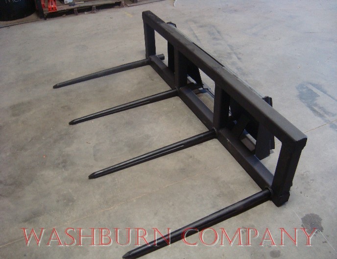

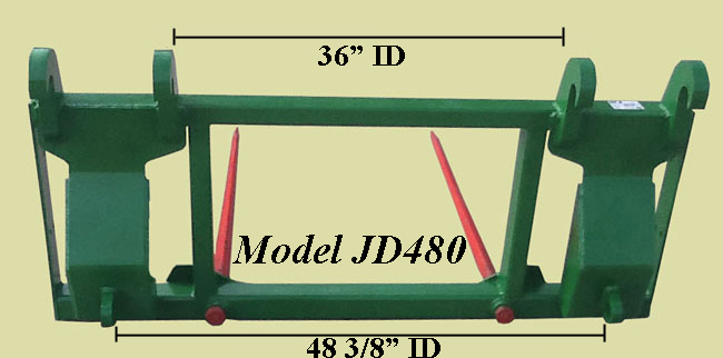

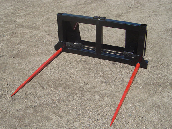

   / Safety concerns when moving hay bales #6
These are spears for large square bales.
Much better than pallet forks
