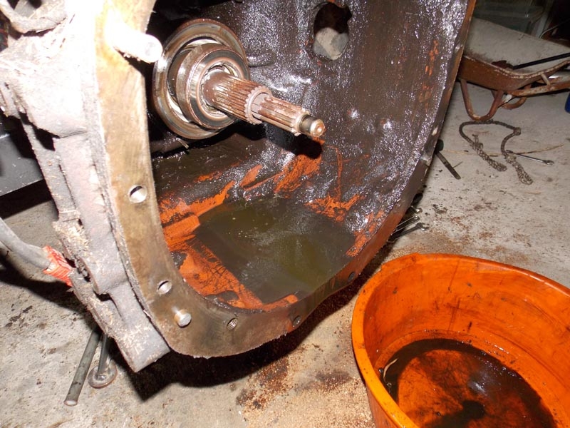

This is a 1985 SAME (now SDF) 85HP Mercury 85.
I had a lot of of leaking from the starter motor (???!!), it was from the bell housing, flying around in there.
I assumed it had to be the rear main engine seal, but it turns out to be gear oil leaking through an end cap.
There's an Oring in there, it might be a special profile or maybe the old one is just deformed over time. Anyway, I ordered the part by number from the catalog, so I'll see what comes.
The seal is compressed along the face of the cover plate, but there's no provision for clamping it down, it's held in by a big circlip. It seems sort of optimistic to me.

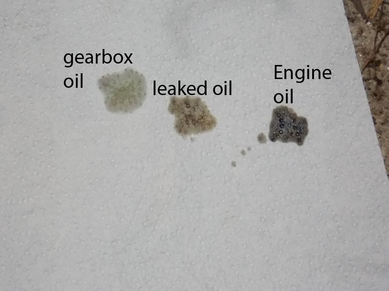

I did a little test; this just took a minute and confirmed the source of the oil.

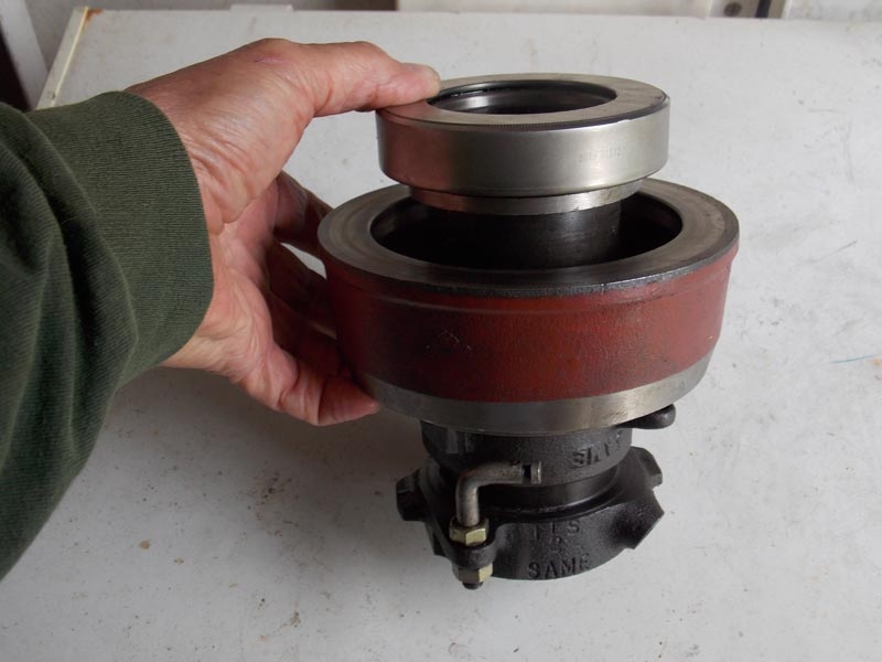

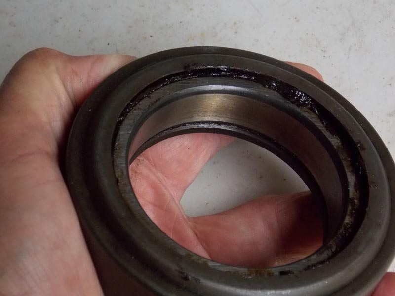

The throwout bearing assembly; I pressed it apart to change the bearings. That required a couple of jigs to be made. I'll try to get a picture.

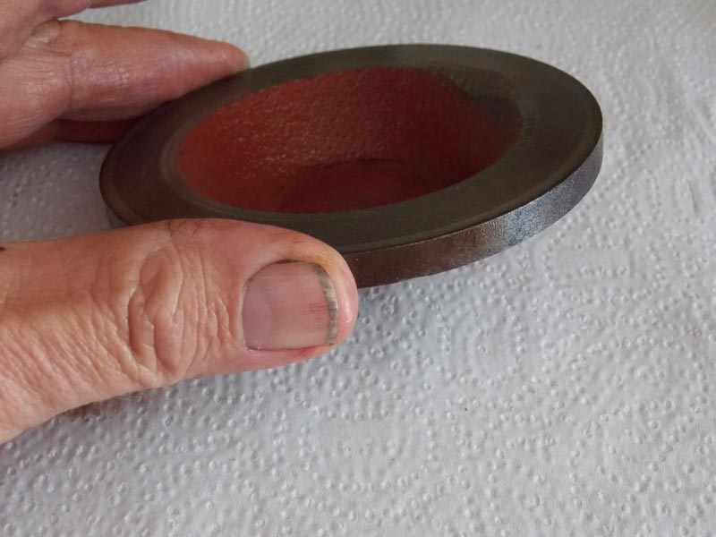

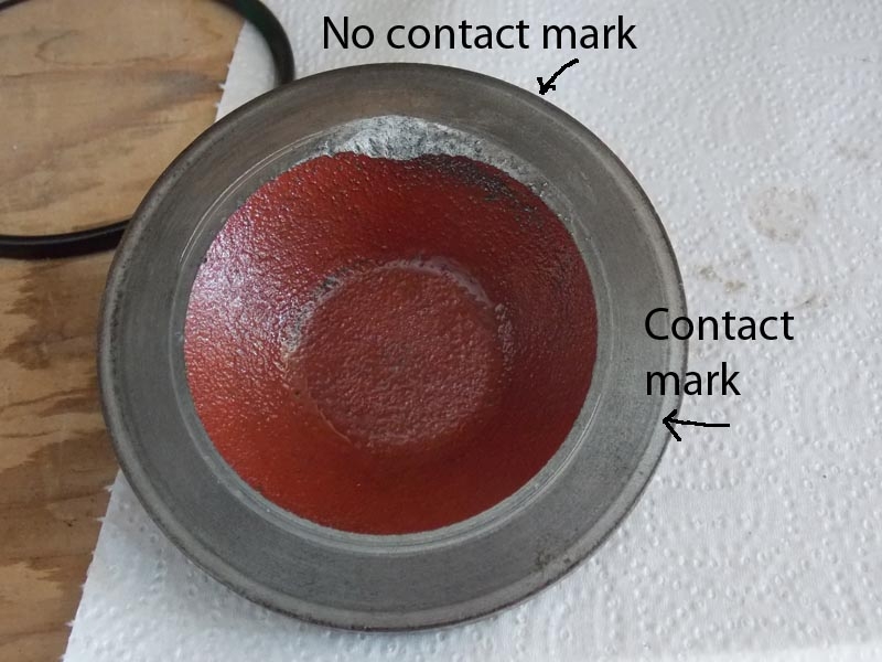

After cleanup; the pink colored cap below the main shaft is where the leak is from. It's a cast iron disk.

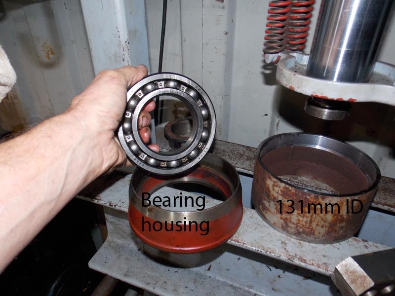

There is also a bearing for the PTO clutch, which is a huge standard bearing (75x130x24) because of geometry, and cost 85 euros new; I'm going to clean and repack the old one. It hardly gets spun at all, and even then the pressure against it is negligible.

The big bearing for the PTO clutch is repacked and reassembled. I had to cut a pipe to press it apart, but it goes back together very easily.
Pressed it back with the "horizontal press"

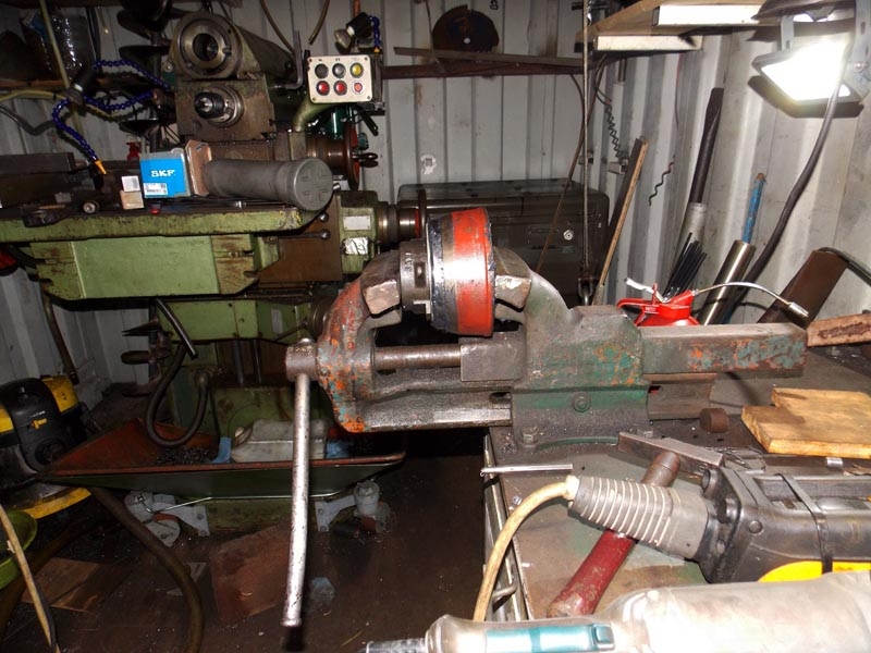

The cap is 10mm thick, so I can cut a groove and set another Oring in there. That will make me feel better, but I also need to cut a threaded hole so I can pull the cap off again.

I took the triangular section Oring to the tractor shop; all agreed it looks like it was made in that shape, but that it could have been originally round.
I'd looked up the number and found that it's common to quite a few tractors. The old man of the shop said he'd never seen a triangle section Oring; and since he's the old guy and I'd found it was a common part, we all agreed therefore, there are no triangle section Orings.
I ordered 3 different thicknesses of regular round Oring to try.
It will be necessary to press the cover in with some force to compress the Oring before putting the circlip in, I'll need to rig up something for that.

I got the new throwout bearing and some seals, but I'm still waiting for the rear main engine seal.
When I unpacked the new bearing, I found the grease cover is smaller than the old one, so the spacer/ grease plate doesn't fit inside it.
That was Friday; if I return it I won't get a new one until Monday or tuesday, and it might be the same.

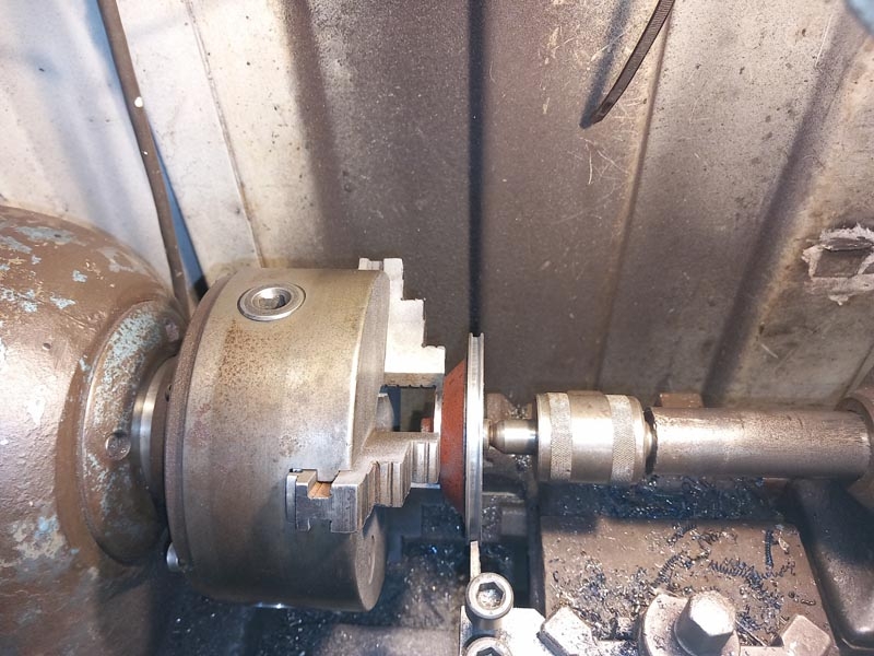

So I made a replacement spacer ring to solve the problem. I used a lump of flame cut plate so it took a couple of hours.
Satisfying though.
old throwout bearing;
old + new bearings and rings.
new spacer / grease ring pressed onto bearing collar
Throwout bearing assembly;
Cut a mounting groove into the iron cover, made a pullout thread and an oring groove.
