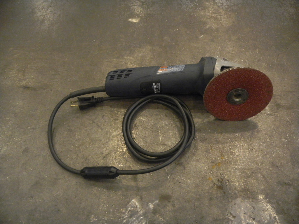

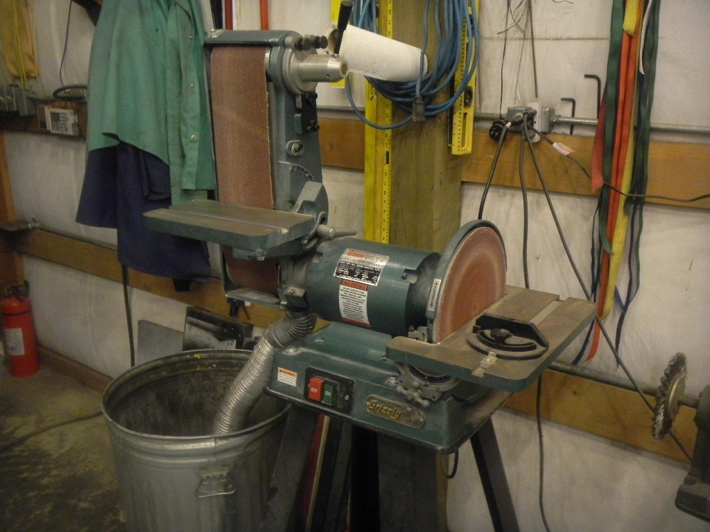

What grit are you guys using on your disc and belt sanders for general purpose metal work and what speed is ideal for the machine to run
   / sanding disc grit #2
For rough work, like removing paint, and mil scale. I use a 36-grit sanding pad. If the item is going to be painted, I use 80-grit. The small grinder runs around 12,000-RPMs. The large bench sander runs at 2,500-RPMs.
