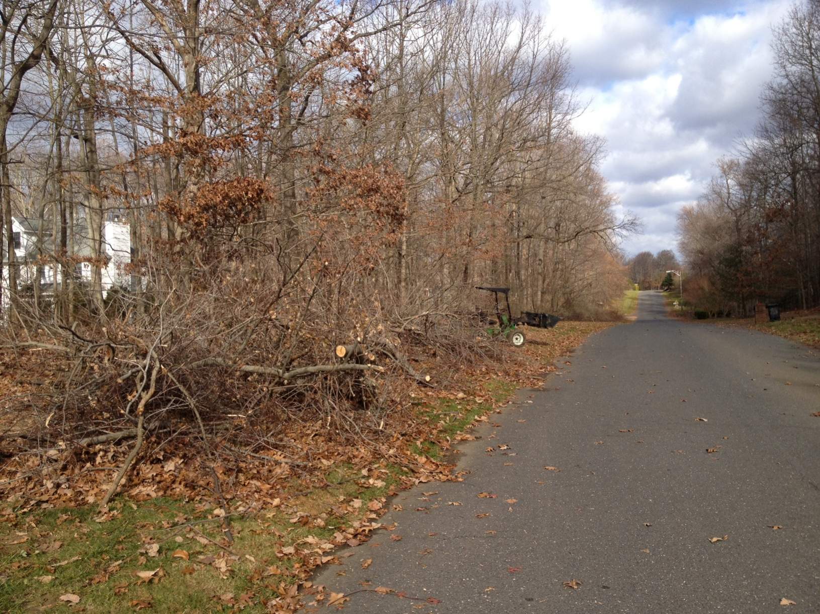

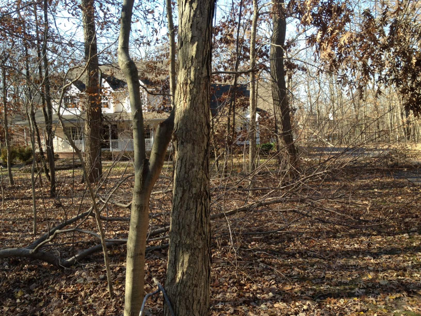

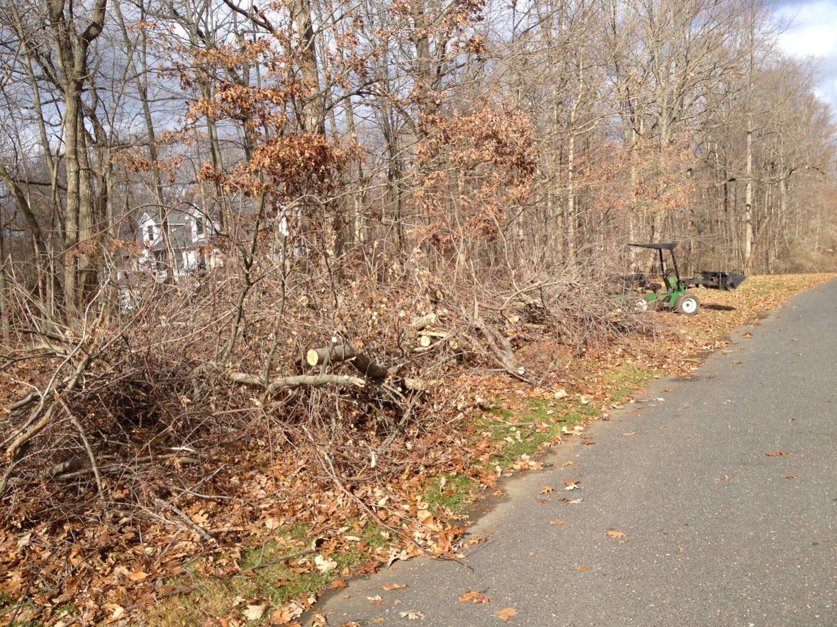

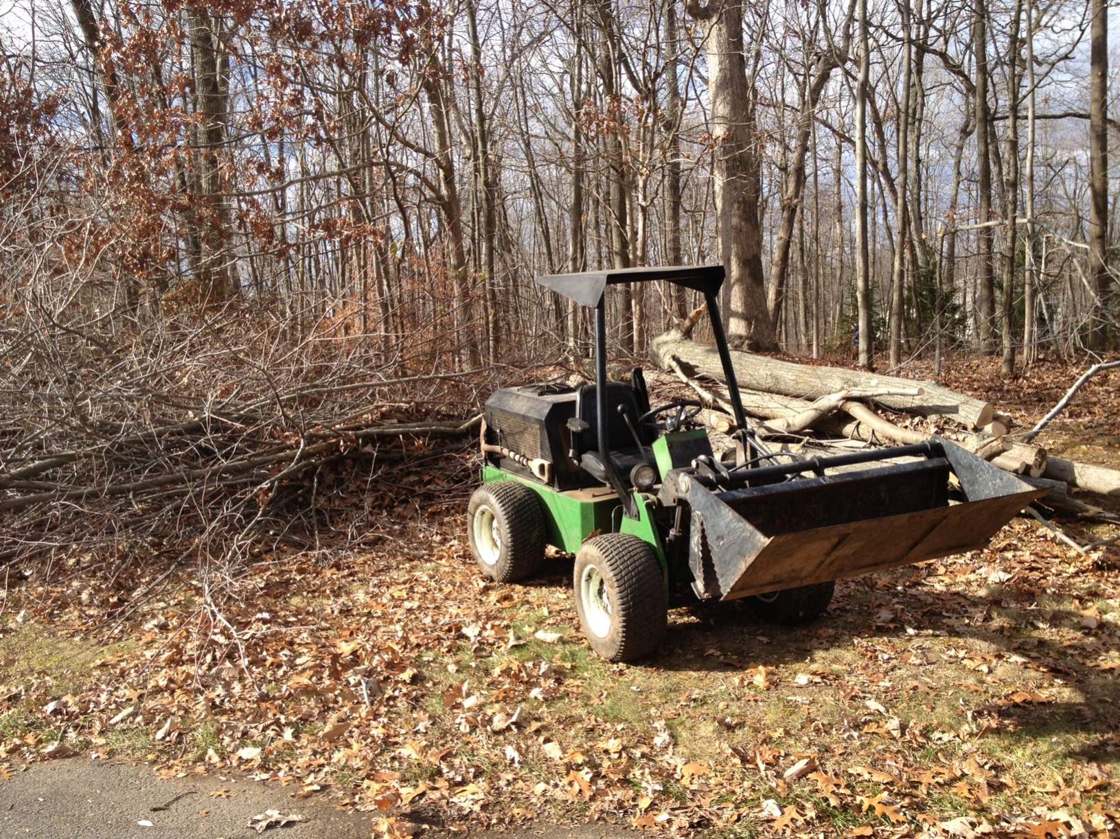

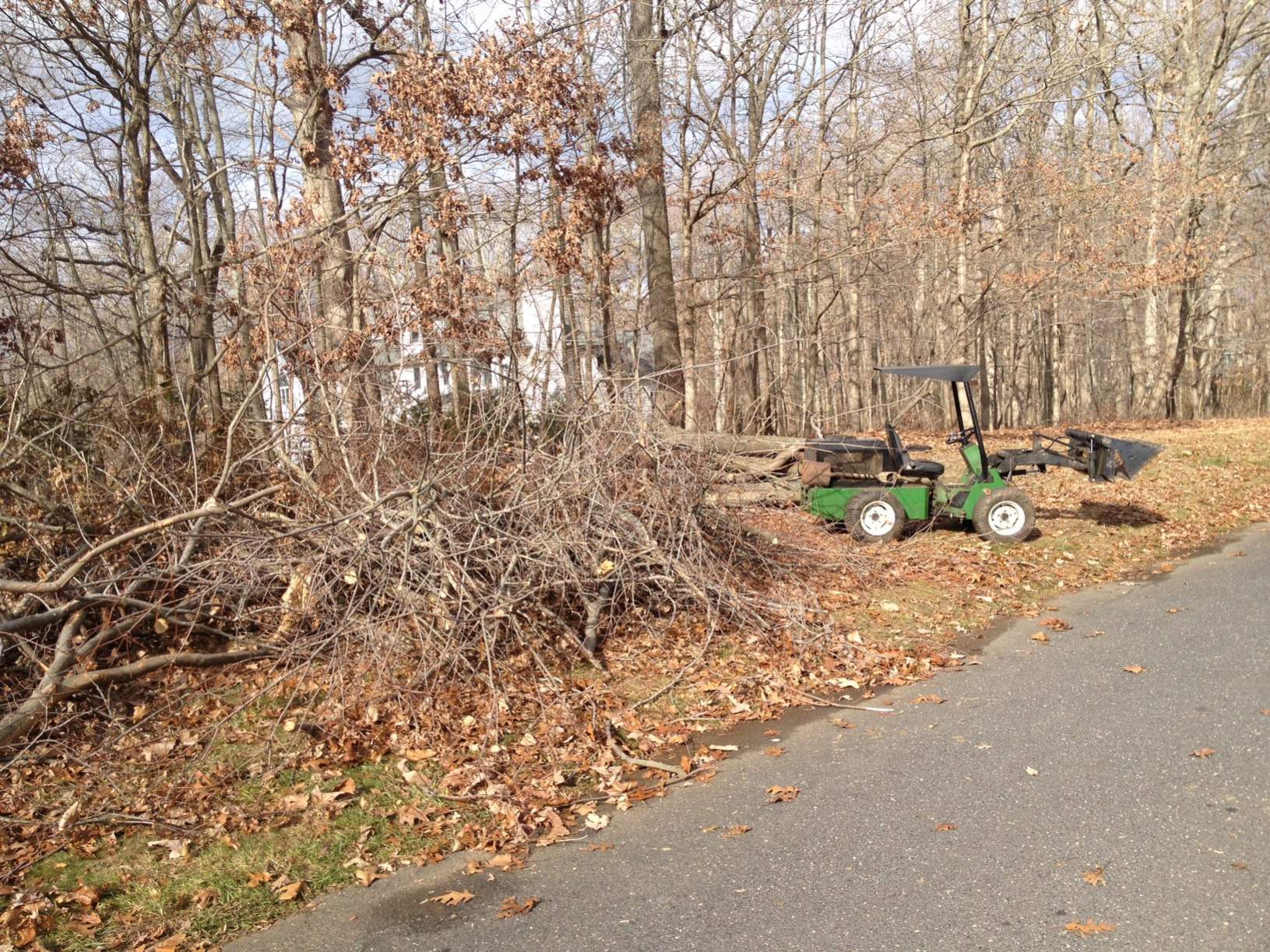

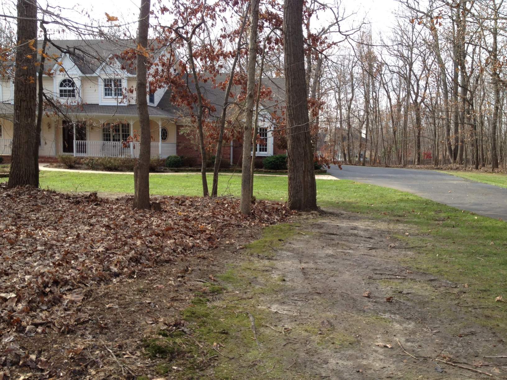

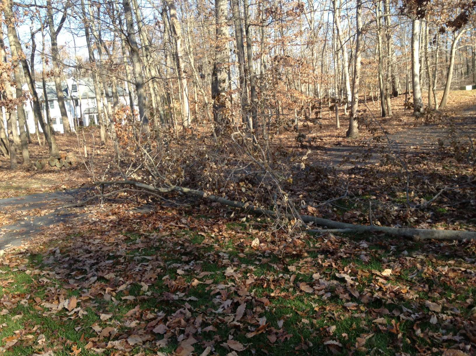

I thought you guys would like to see some of the storm clean up pics I took. It was all trees down at a customers house . No damage to the house. The first and last were before. The second was an after and the rest are pictures of the pile along the road. I tried to give a sence of size of the pile. There was a lot more damage than the pictures show. There was stuff down all over the property

Its pretty amazing what tasks these "little" machines can tackle. :thumbsup:
