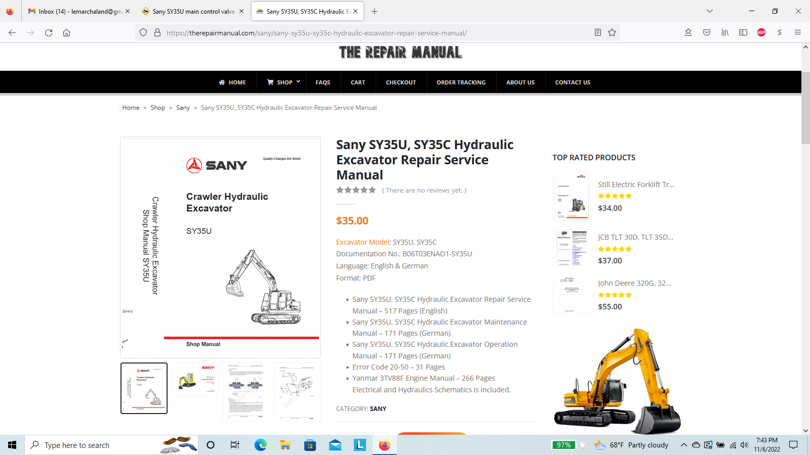

   / Sany SY35U main control valve
i do not have a manual. i have been trying to find one.

   / Sany SY35U main control valve #5
No idea on a Sany but most hydraulic systems when that happens it's a weak pump or flow getting past a valve as the fluid warms up.
Do you have a service manual for it?
That may have some test procedures and locations.
Weak pump? That's what I thought at first too, until I saw this.
Having never heard of the machine I was curious. I don't know if his machine (2014) has all these features, but when I got to the part about "Independently developed intelligent control system" and "matching pump output to available engine power" then I have to wonder. If you put a computer, a gaggle of sensors, and a mile or so of wires in charge of all that, then what can go wrong with THAT system?
