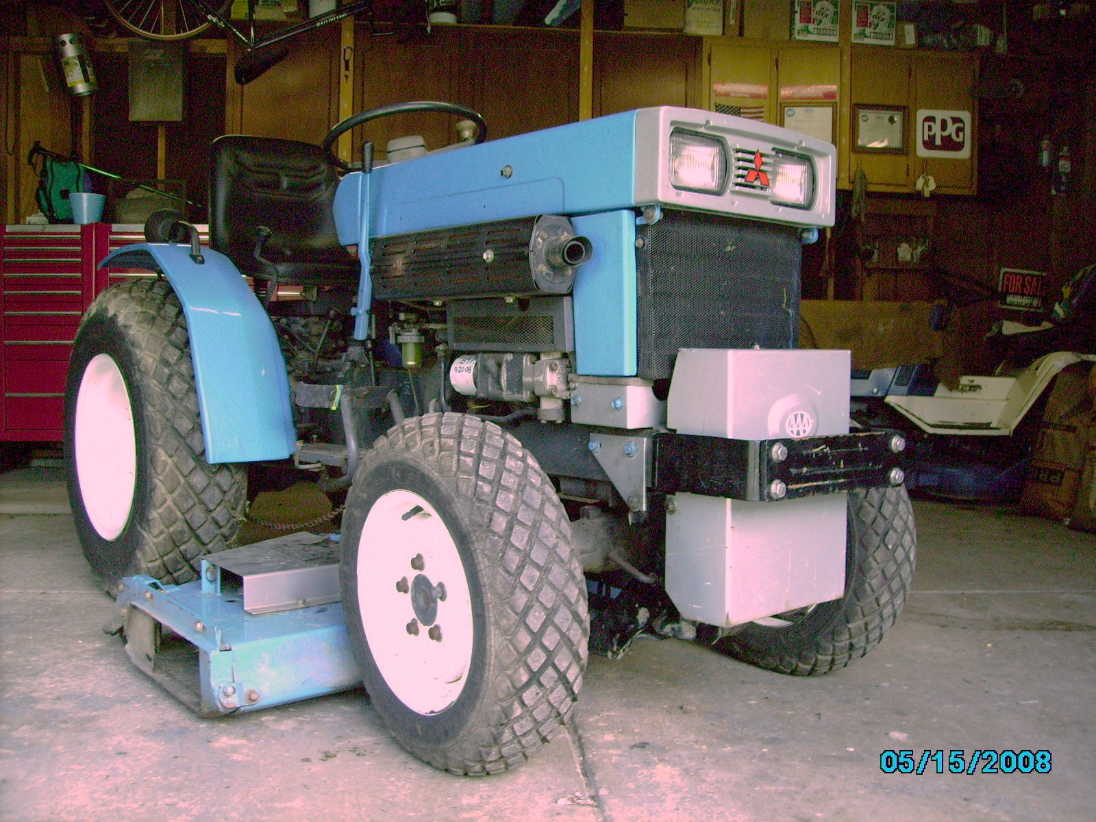

I have a Satoh Beaver S370. Does anyone know if a mid mount mower is powered off of the front or rear pto on a satoh beaver? I only have the rear PTO, and there's a mower on craigslist. I currently have a 4ft flail mower on the back and i think its a little heavy to mow the lawn with it. Any info would be appreciated. Thanks.

Could be either one. I have an MT372D with a Woods belly mower that runs off of the front of the engine with electric clutch. I have scene many belly mower that run off of the rear PTO shaft. If the one on Craig's List runs off the rear, be sure you have the correct direction rotation and correct spline. If it is a Haban mower, they are out of business and you may have a difficult time locating parts when you need them. Eventually you will need parts.
I can still get all the parts for my Woods. (Puts down a nice cut too).

348MB-2
I know parts are still availlable. I don't think the "kit" is availlable any more.
You can go to the Woods website and look at the manual and you can see how it attaches and how it runs off of the front crank.
