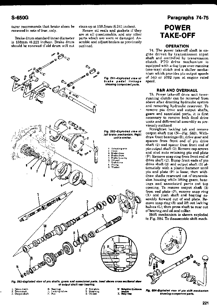

I need help. I went to use my mower on my Satoh Bison for the first time this year and my REAR PTO is frozen. It doesn't want to turn at all. Has anyone had a similar situation or know what I should do. I don't have a manual but am looking for one if anyone knows where I can find one. Any help is appreciated. The tractor only has rear PTO and is two wheel drive. Getting ready to tear it down to investigate. /forums/images/graemlins/confused.gif
   / Satoh Bison S 650 G 27 HP: Rear PTO Problem, Help! #2
Re: Satoh Bison S 650G 22.5 HP: Rear PTO Problem
Satoh PTO Breakdown-Part 1 of 2

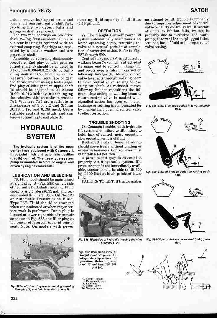

   / Satoh Bison S 650 G 27 HP: Rear PTO Problem, Help! #3
Re: Satoh Bison S 650G 22.5HP: Rear PTO Problem
Satoh PTO Breakdown-Part 2 of 2
