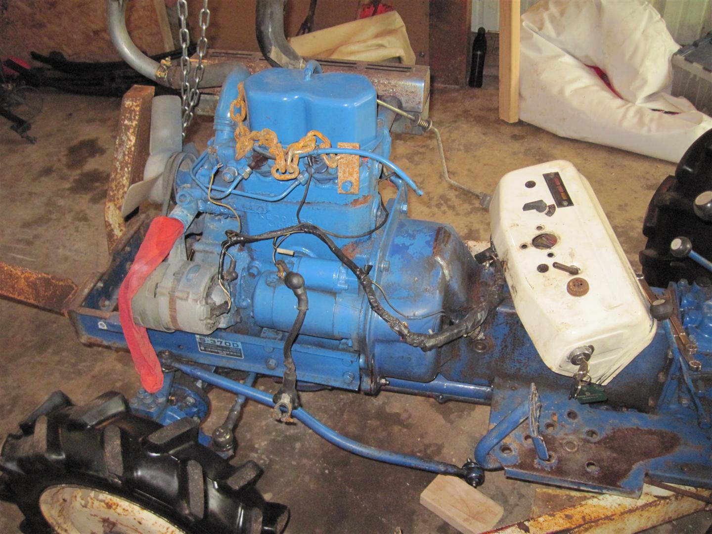

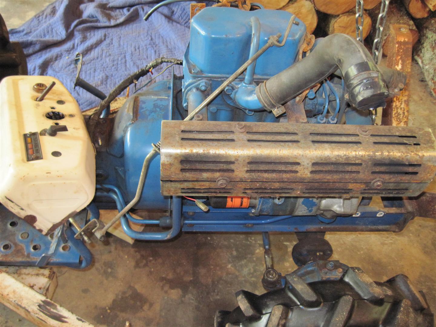

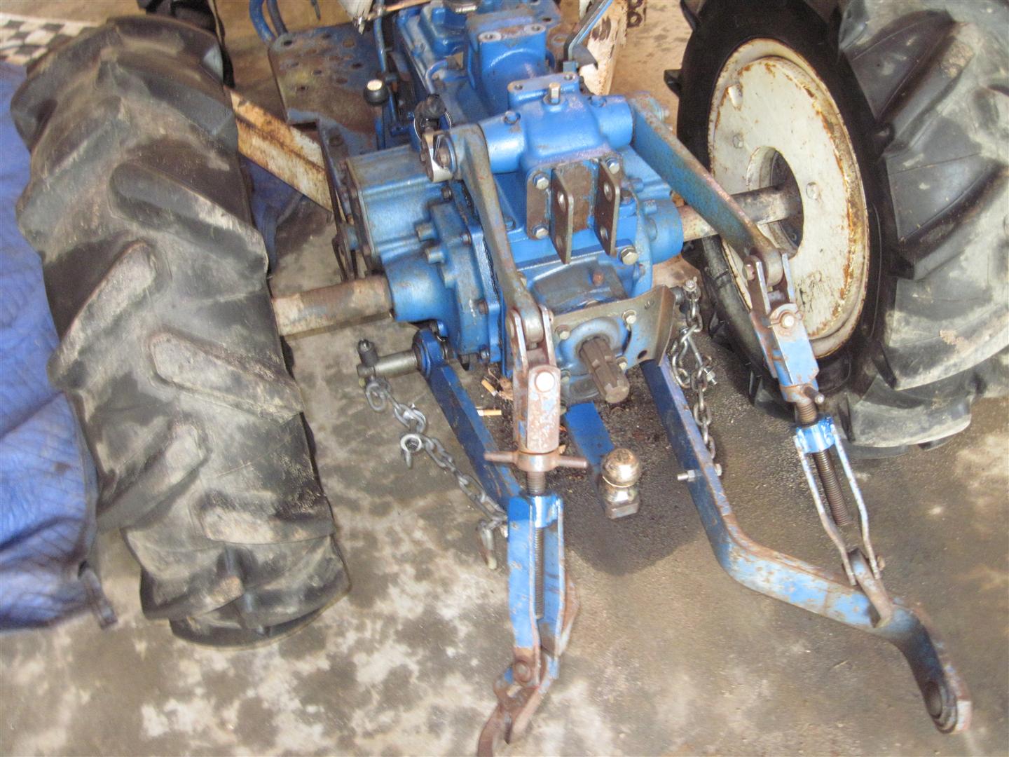

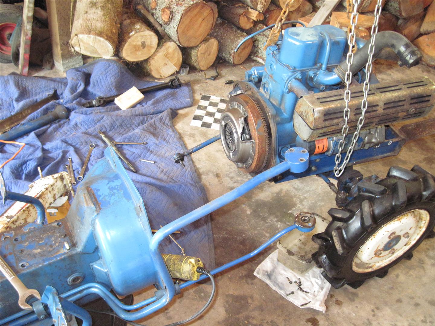

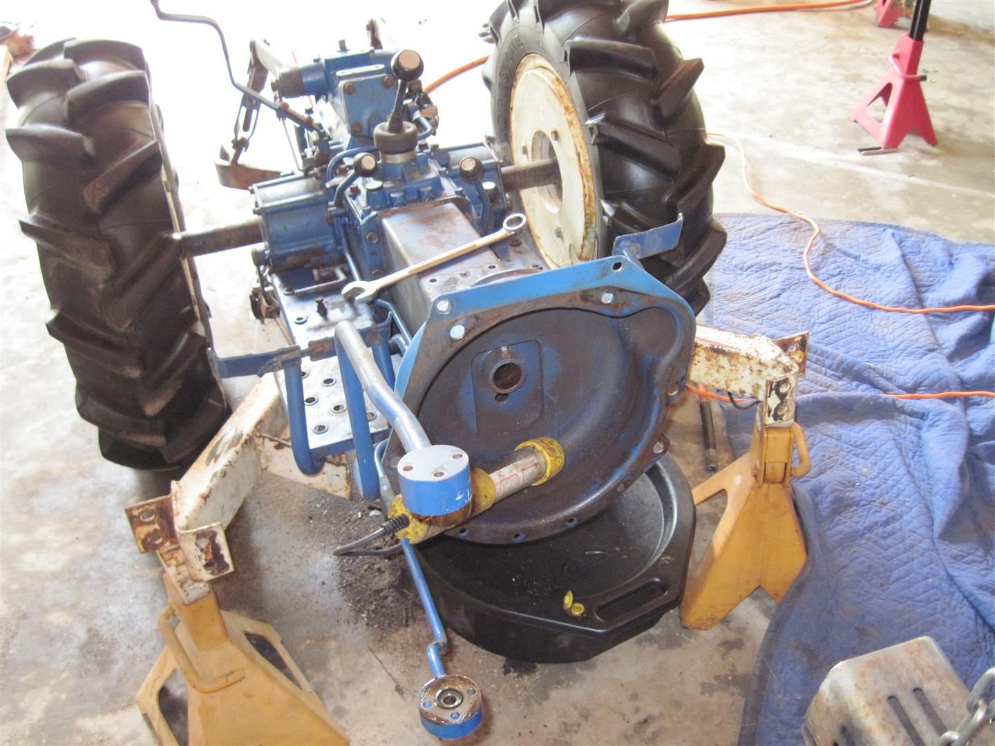

:) hi guys well got my parts and i'm getting ready to put my tractor back together after the new clutch and refurbish project. ok i have the service manaul and it tells to fill hydro-oil to the bolt on the side. i'm wondering:confused3: if there is something more/or if there should be a little more oil added for the loader? if so how much? thx for your help:drink:ps here a few pictures 001 (Large).JPG002 (Large).JPG005 (Large).JPG004 (Large).JPG006 (Large).JPG

Here Satoh Parts is a picture from Valley Power showing the fill plug. I think it is on the left side where your heel would be on the running board.
   / satoh s370d hydro-oil fill #3
I think if I were refilling my system after mostly draining it, with all cylinders in their retracted position, I'd fill to normal level. Fire the tractor up and cycle the cylinders in/out several times and after retracting them shut the tractor down and check it again adding as needed.
I don't recall there being any mention of overfilling on my tractor, but most of the literature we had on it is long gone. :(
