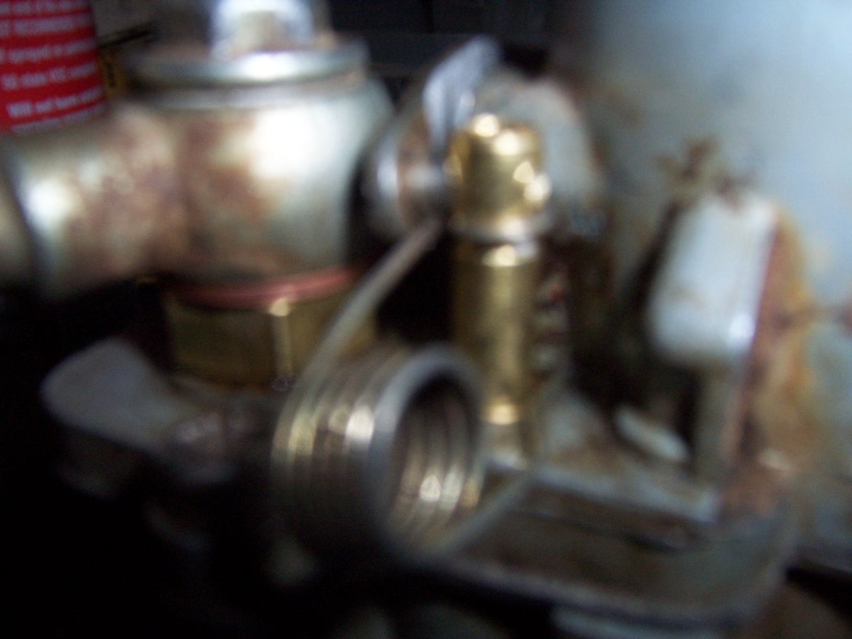

satoh 004.JPGits next to impossible to find a Carb kit for a ISO carb on a Satoh S550G BUT
a carb kit for a S650G can be modified to fit ... carb kit # S.70586 replaces G064 3233 990
The plunger arm shaft hole needs to be drilled out a little larger. drill it out ONLY after installing on the carb.. see pic
the next thing is you have to use the old needle spring. the needle spring that comes in the kit is too short.
other than that you are good to go.. the important gaskets in the kit that you need match up
