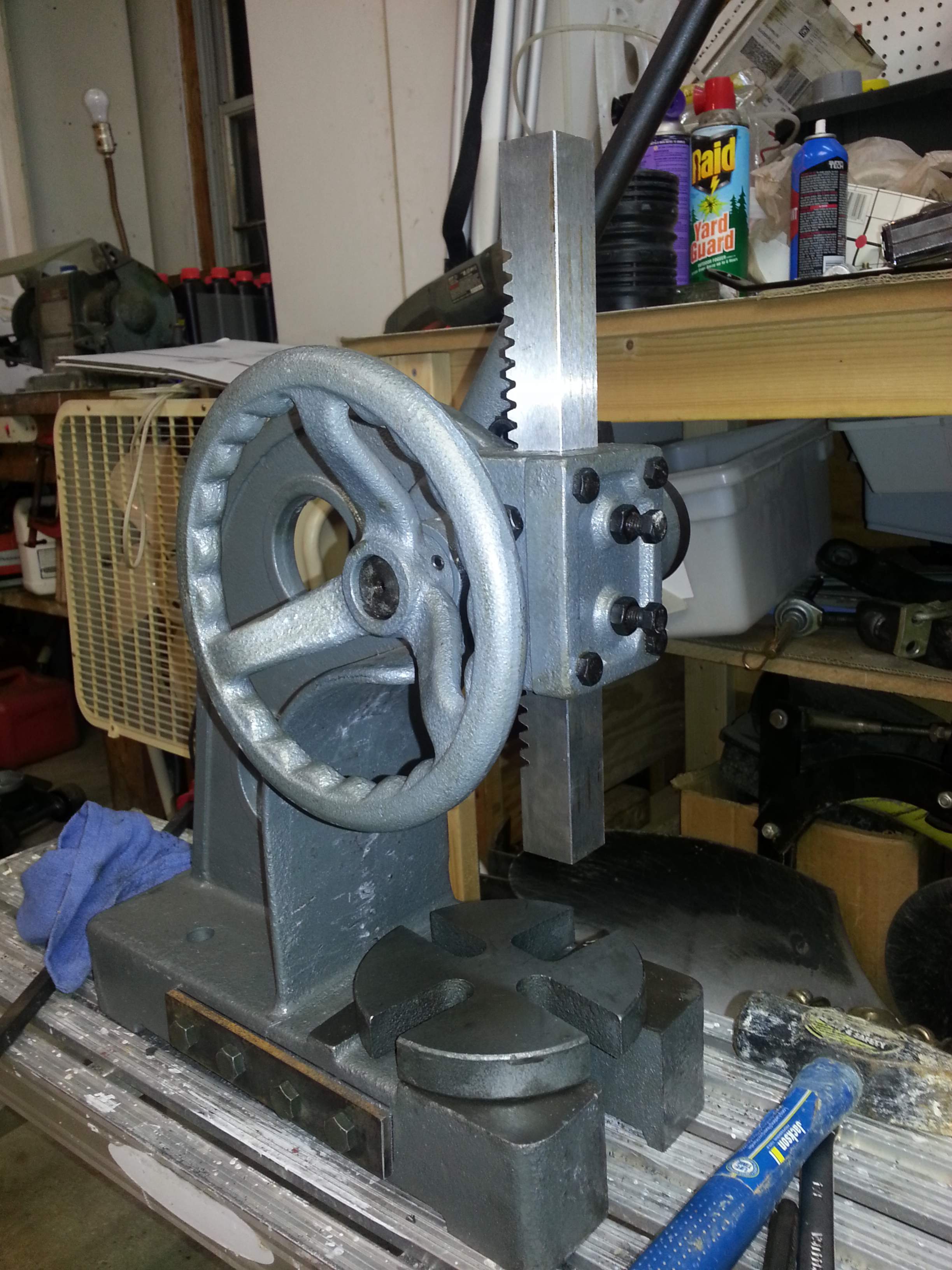

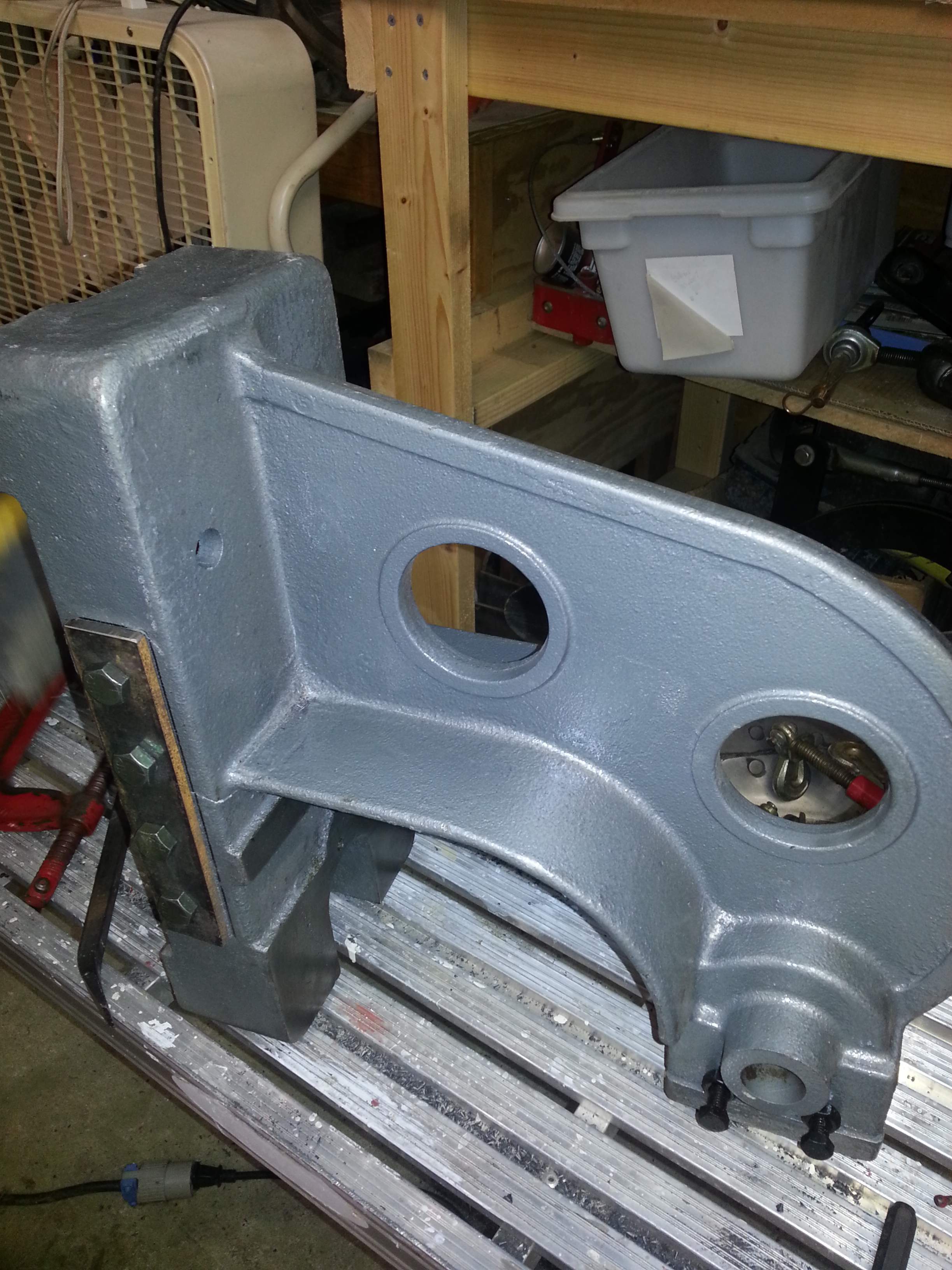

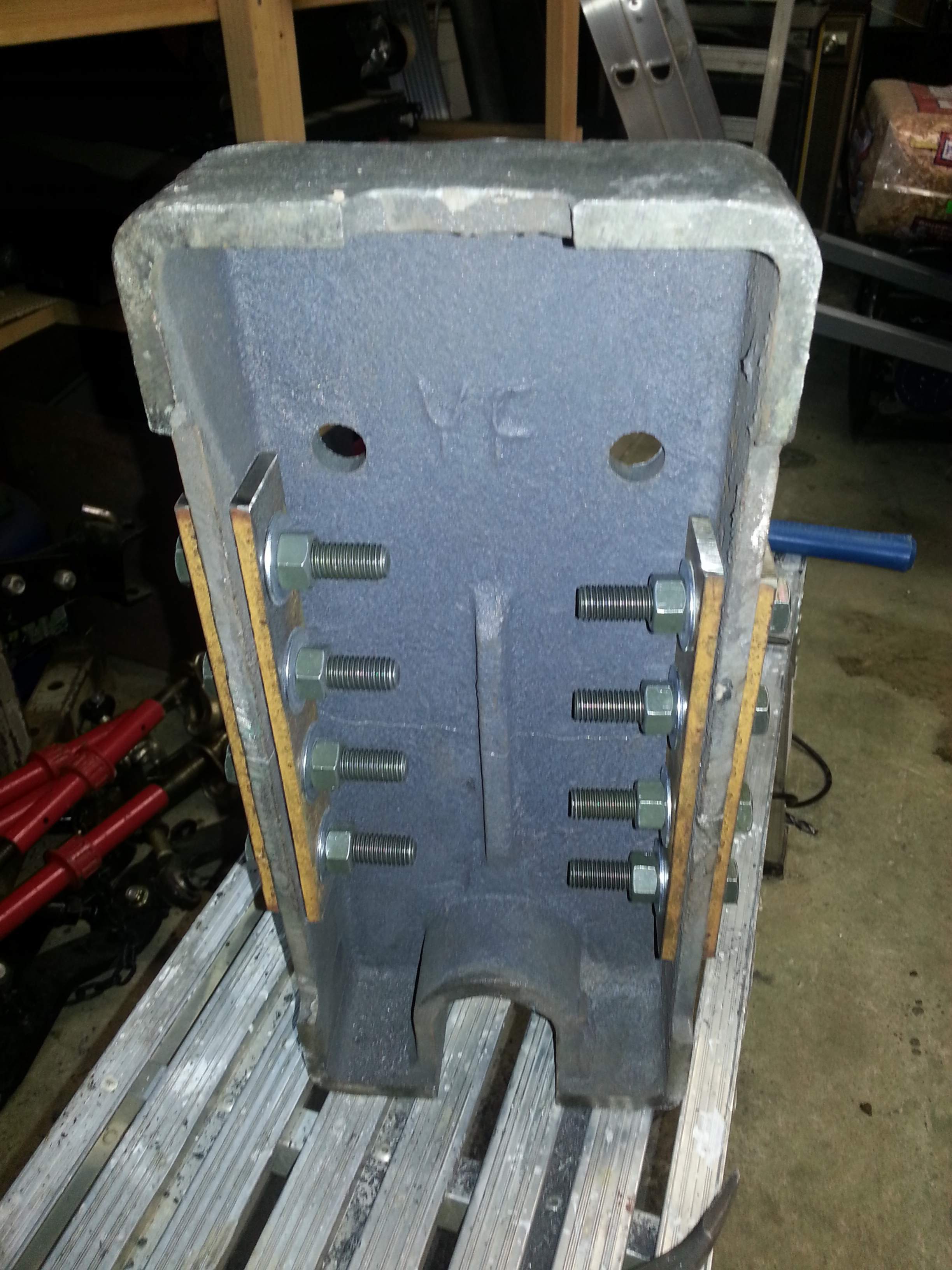

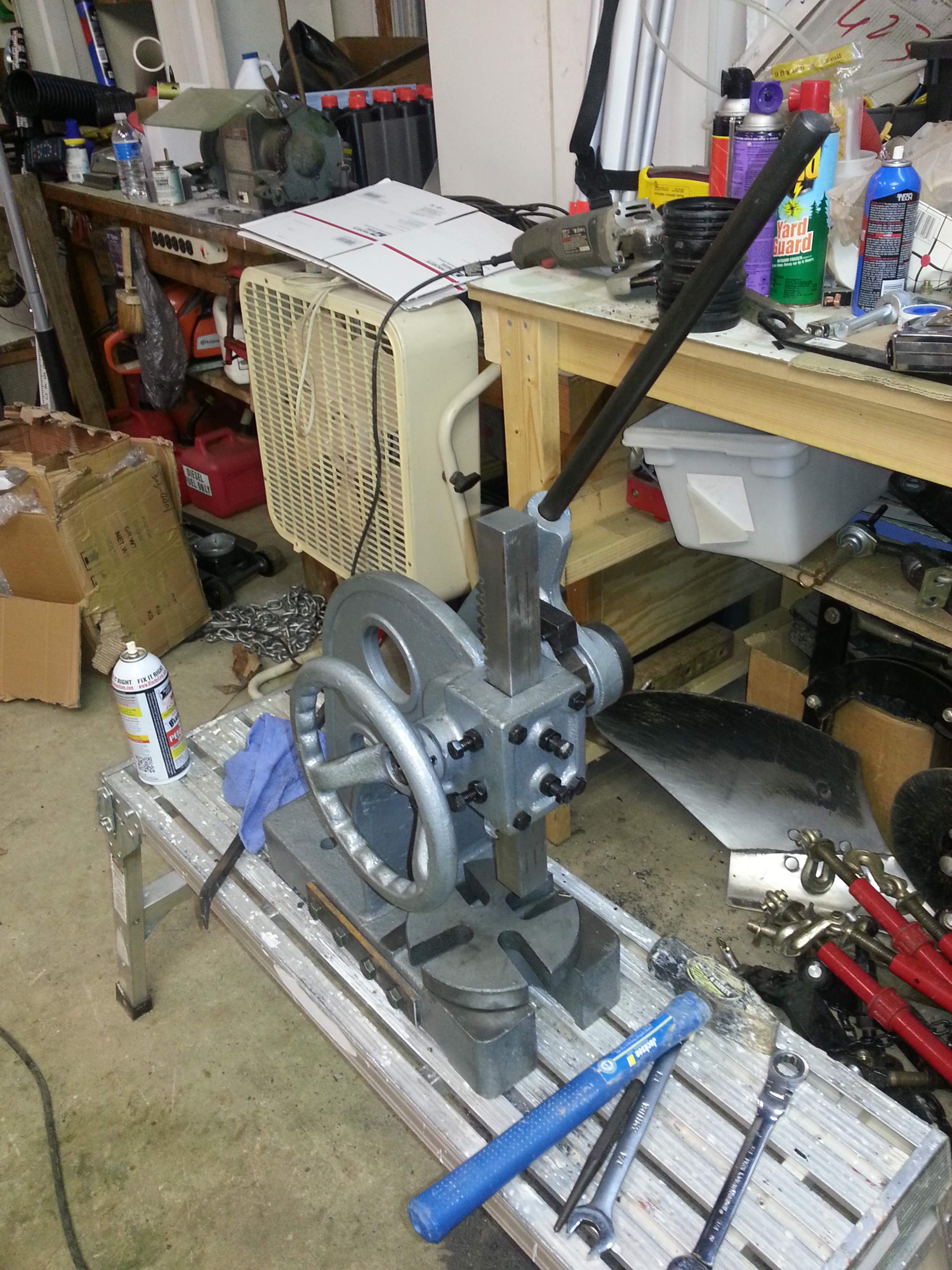

We bought a 3 ton arbor press at my company and it arrived with the front half broken off. The company sent us a new one and UPS never came to pick up the old press so I spent $19 in parts and 2 hours of labor to have a new press in my garage!
The bolts are 1/2" grade 5 with the shoulders ending just before they penetrate all 3 parts. The mild steel plates are 1.5" x 0.25" x 8" scraps. The holes were drilled through the mild steel plates then they were clamped onto the press and the holes were drilled to a very close fit. They were tightened to about 30 ft lbs and should take about 10000 lbs of force each to break. Assuming the force is divided into 4 bolts (worst case) then the factor of safety is around 6.8.

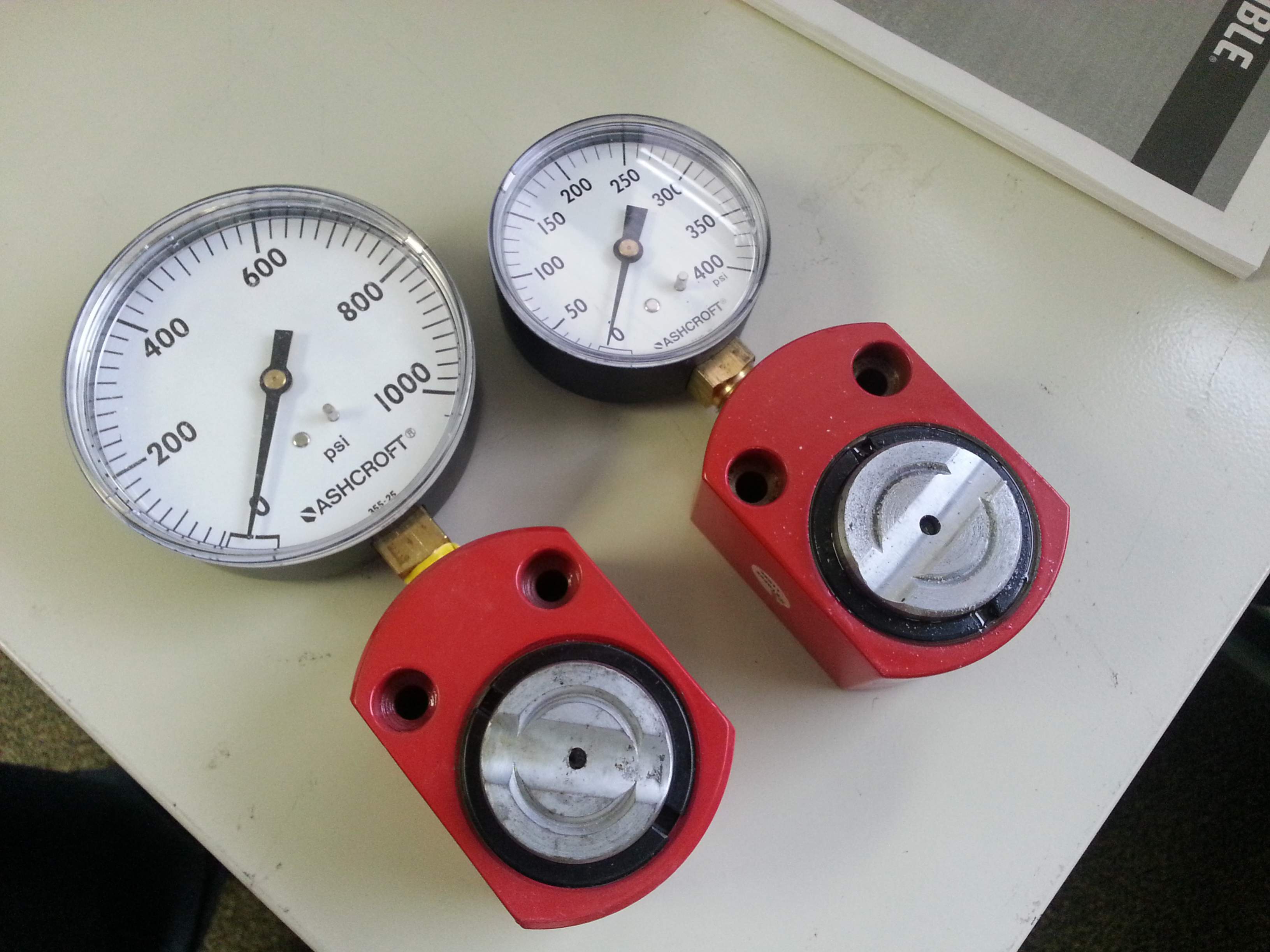

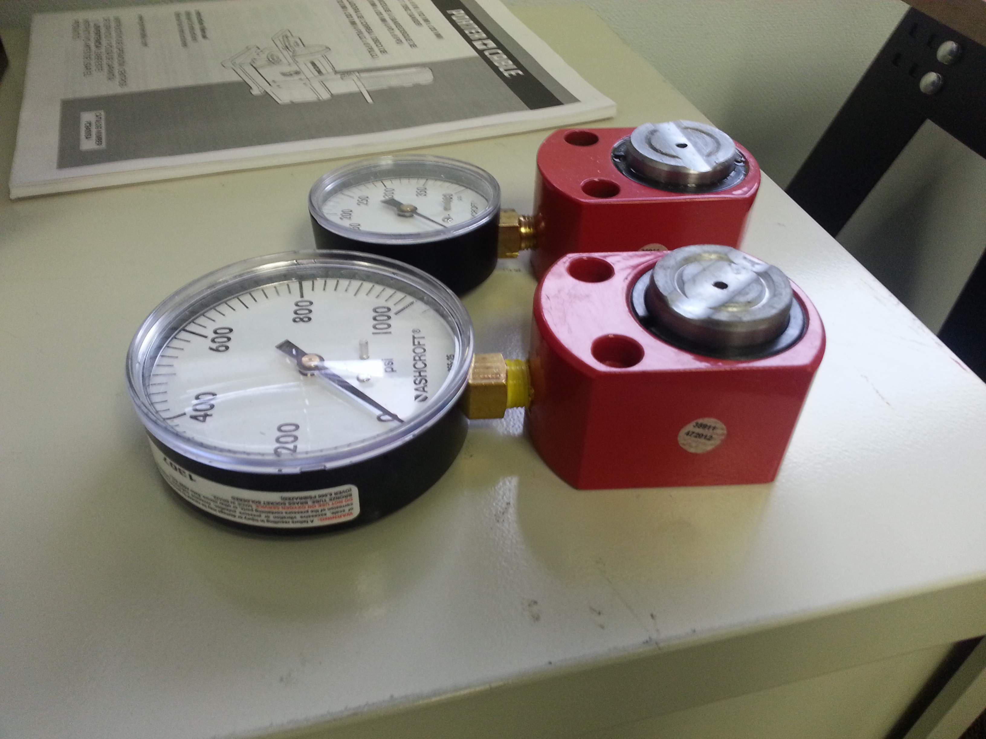

It's a force gauge made for the press, but really could work for anything. The gauges are screwed into a small harbor freight cylinder with 1.5" bore. To build these you need a gauge with a 1/4" npt fitting on the end. Unscrew the hydraulic coupler on the cylinder, drain any oil, and use a drywall screw or bent nail to wiggle the cylinder out (this takes a lot of force, so consider using vice grips to hold the tool). Place the cylinder in a vice so the port is facing up, then fill it with air tool oil or jack oil and screw in the gauge lightly. Tighten up the vice a little to get most of the air out and tighten the gauge fully. I made a chart to convert the gauge pressure to force and hung it on the wall next to the press.
In case anyone is interested, the formula for gauge pressure to force is: pressure*pi*radius^2, which with these 1.5" cylinders would be pressure*1.7671

That's a slick idea!!!! My 50ton press has a gauge but it's not delicate. Gotta rig me up one of these!!! I'm usually in the "guess mode". ;)

I did something similar to that with a 1.5" cylinder to weigh things hanging them off the chain hoist. A bit different conversion cause I had to factor out the rod diameter with using it as extending, but wrorks pretty well. I have 3 gauges fitted for it that I can swap out, depending on how heavy and how accurate I want to measure. 0-100psi, 0-300psi, and a 0-5000psi.
Never thought about using one like that. I do have one of those little 1.5" cylinders for a porta power that was in a box full of junk I bought at an auction, never though of using it like that, and was debating what to do with it as I dont have a porta power. But I think you have given me the perfect idea.:thumbsup:
I think you are going to need a but bigger than a 1.5" cylinder to measure up to 50 tons:D
