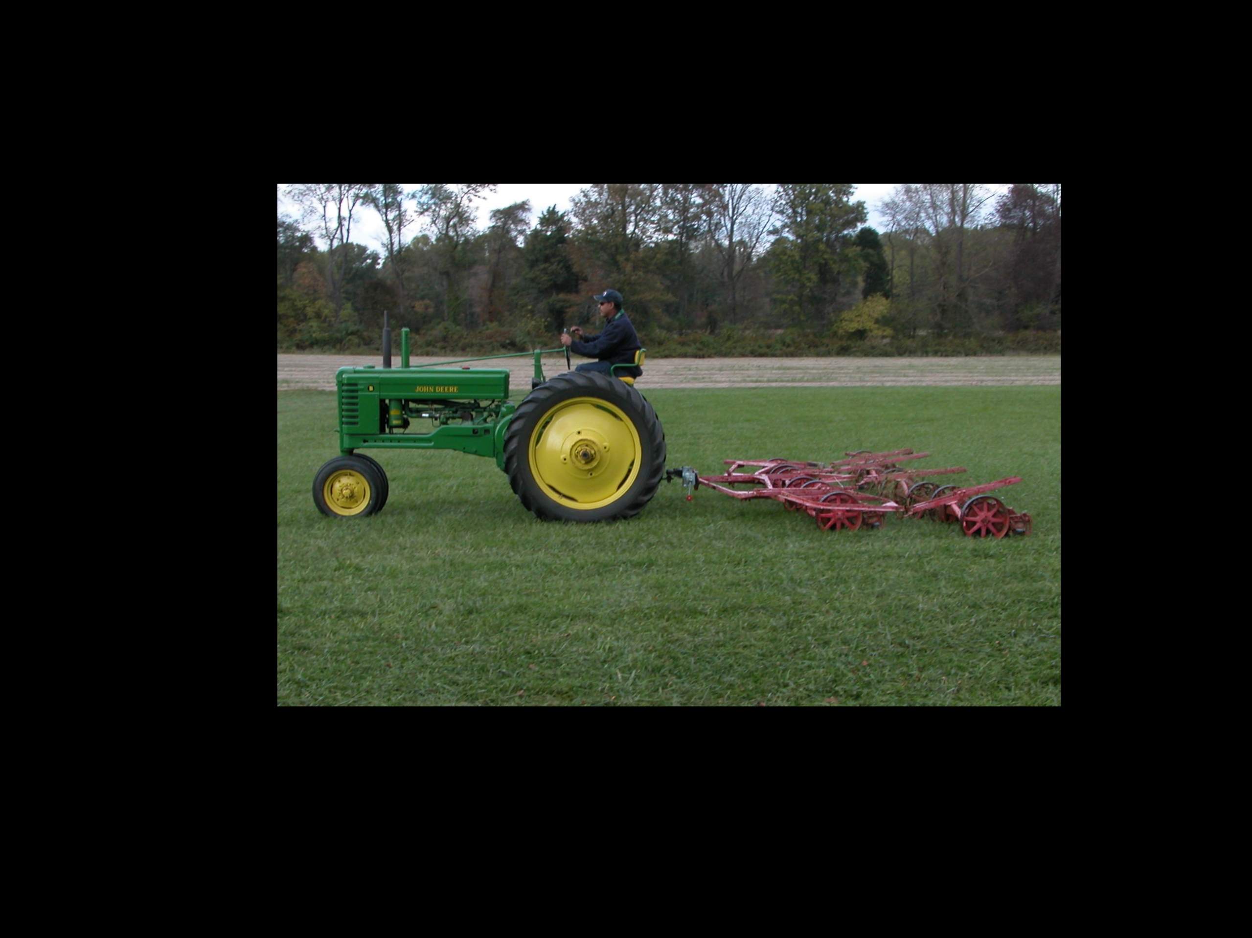

   / Saving Fuel #8
I pull this seven gang mower with a 28 HP John Deere B. It cuts many acres per hour! This is my friend Robert riding the tractor!
Wayne
   / Saving Fuel #9
Wayne
That looks like a blast! I love the way a tractor feels when it's pulling something. I can only imagine what a rush it is to see the grass clippings flying off of those reels. :thumbsup:
