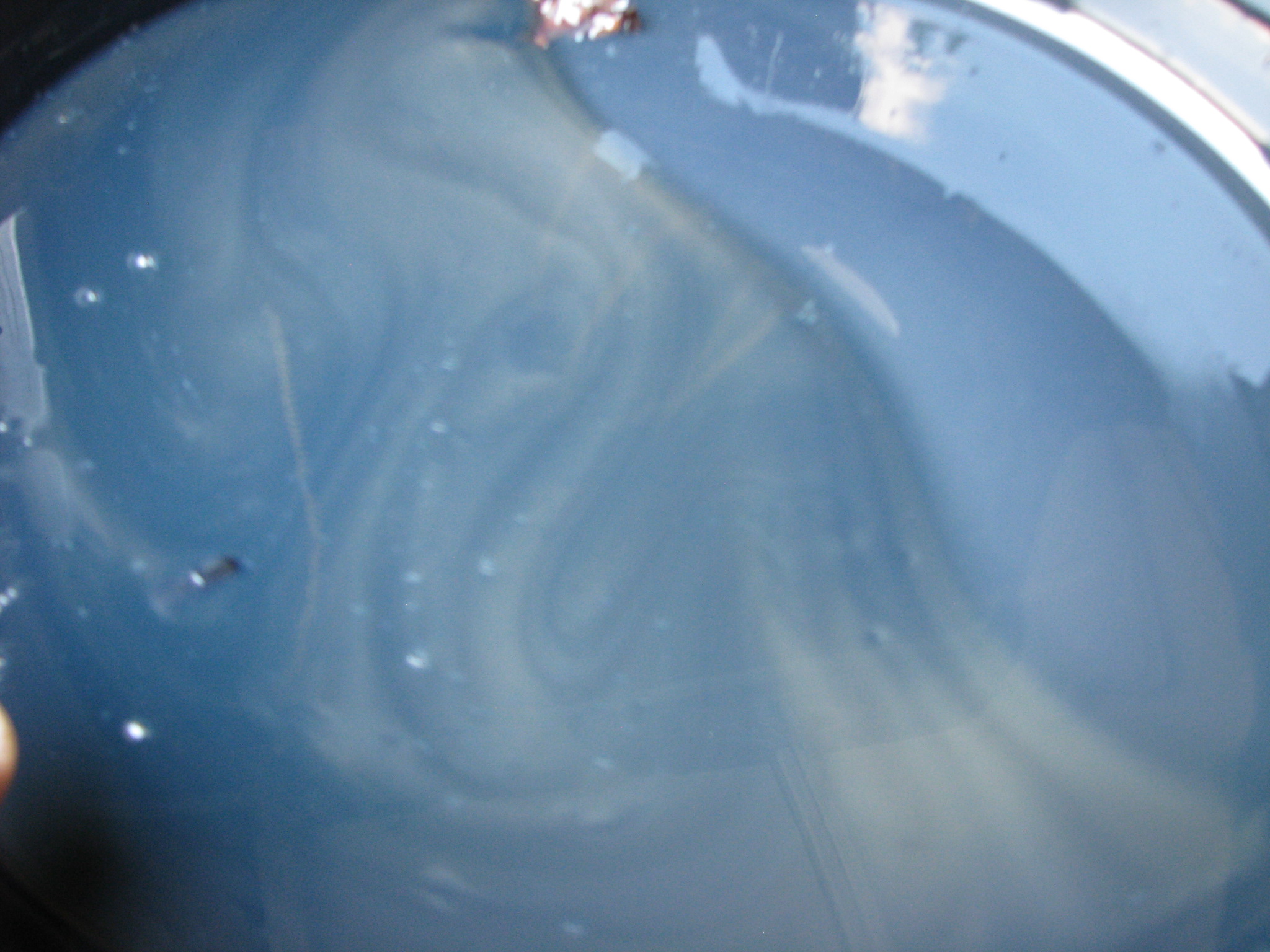

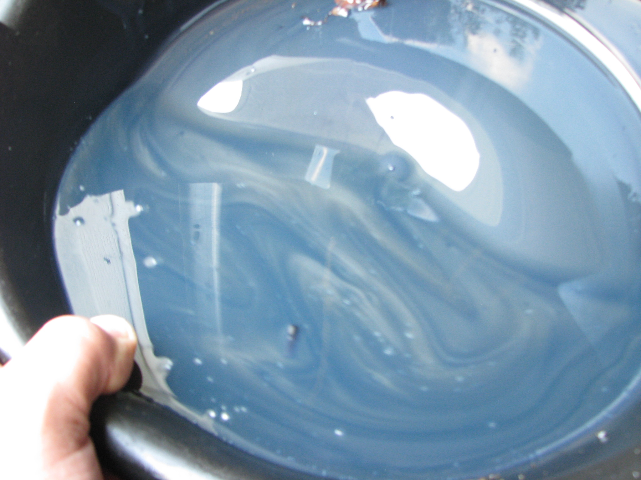

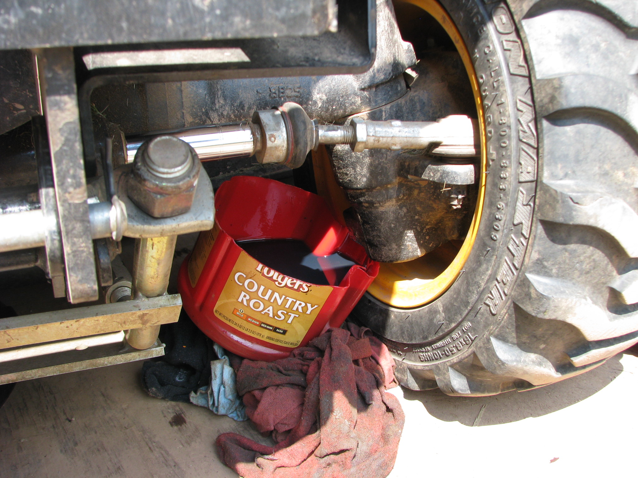

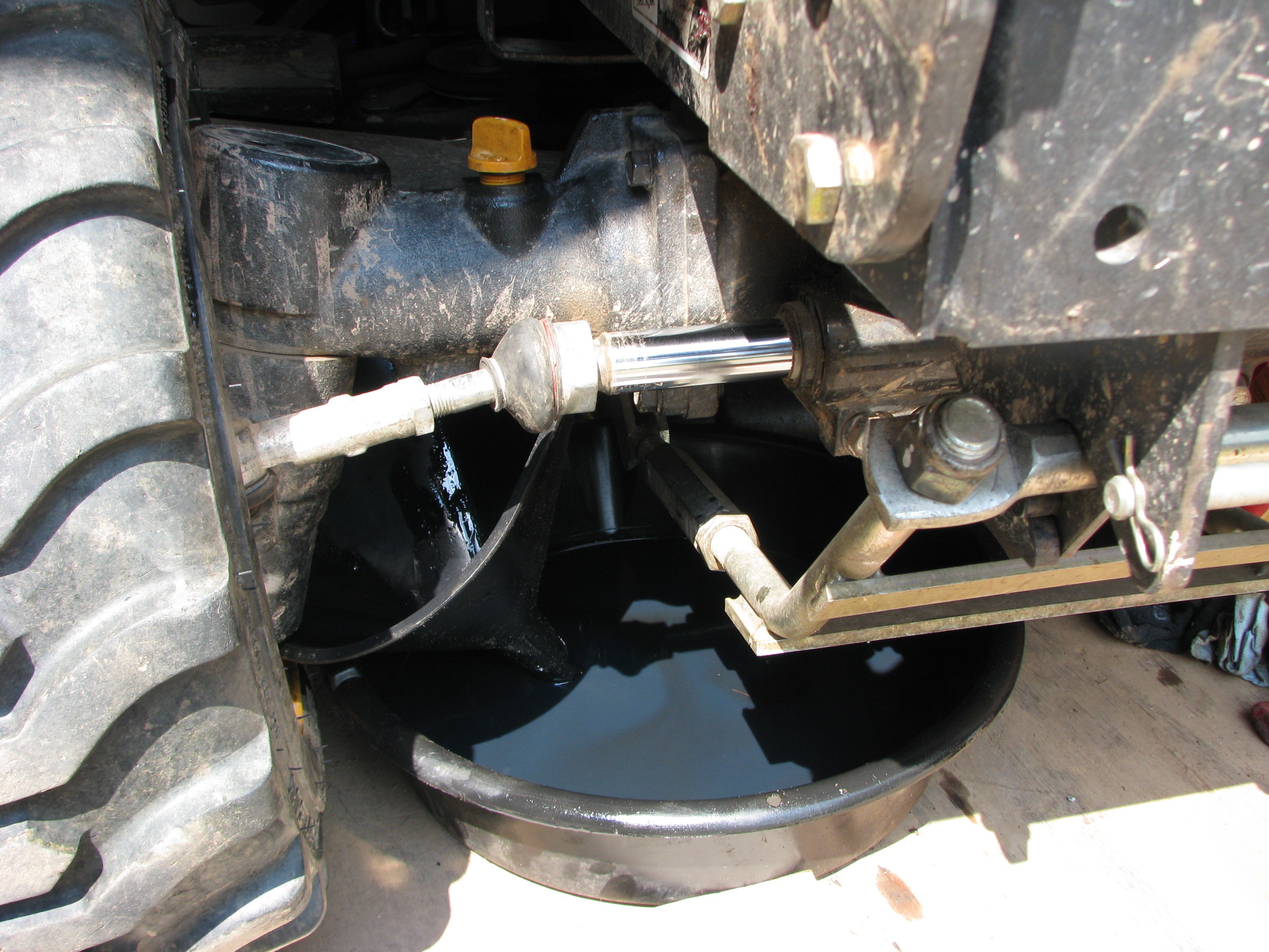

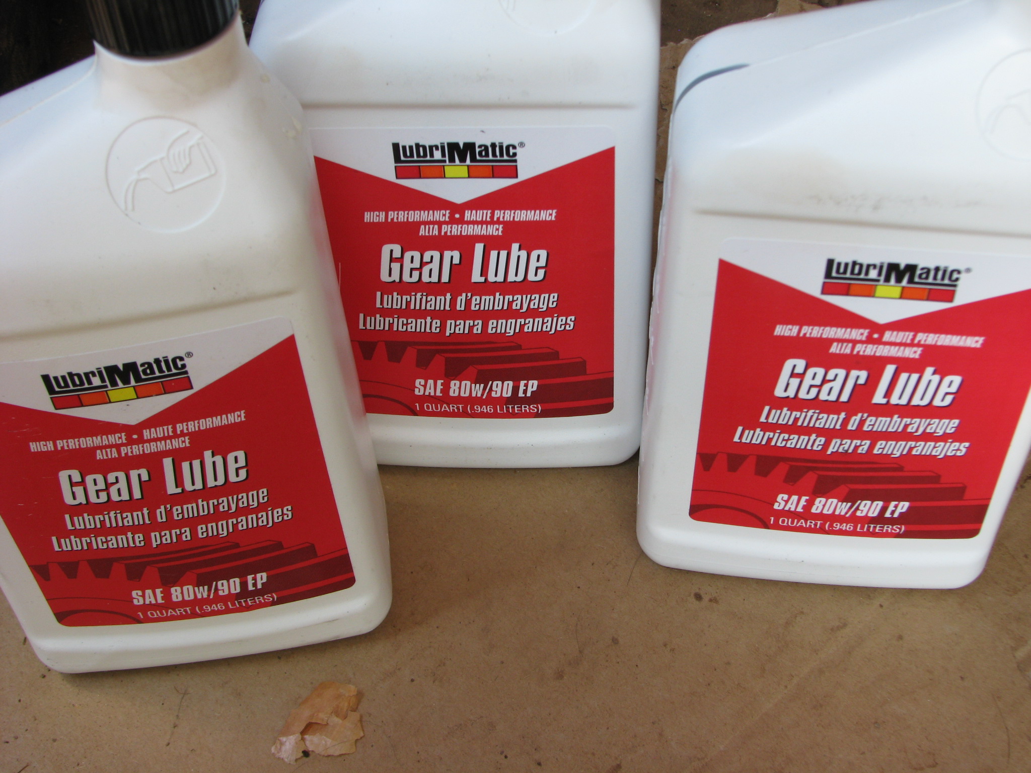

Re: sc2400 500 hour *UPDATE WITH PICS*
So, pretty straight forward procedure.
Just like changing the oil.
changed the oil at about 533 hours
The swirls appeared to be very fine metal particles.
It was nothing I could feel, but there was a lot.
I've changed differential oil plenty of times and never saw this.
No major concern on my part. However my manual does not have changing the oil
at 50 hours listed, which I found odd, and against my better judgment I did not.
I would recommend a 50 or 100 hour axle oil change.
I think I will let it go a while and do another change around the end of the summer to try and get some more crap out of the oil.
I do have a lot of 4wd bucket hours on the machine... at least half of the machine hours, so I think changing the oil every 250 is not a bad idea.
It's easy/cheap, and can't hurt.
