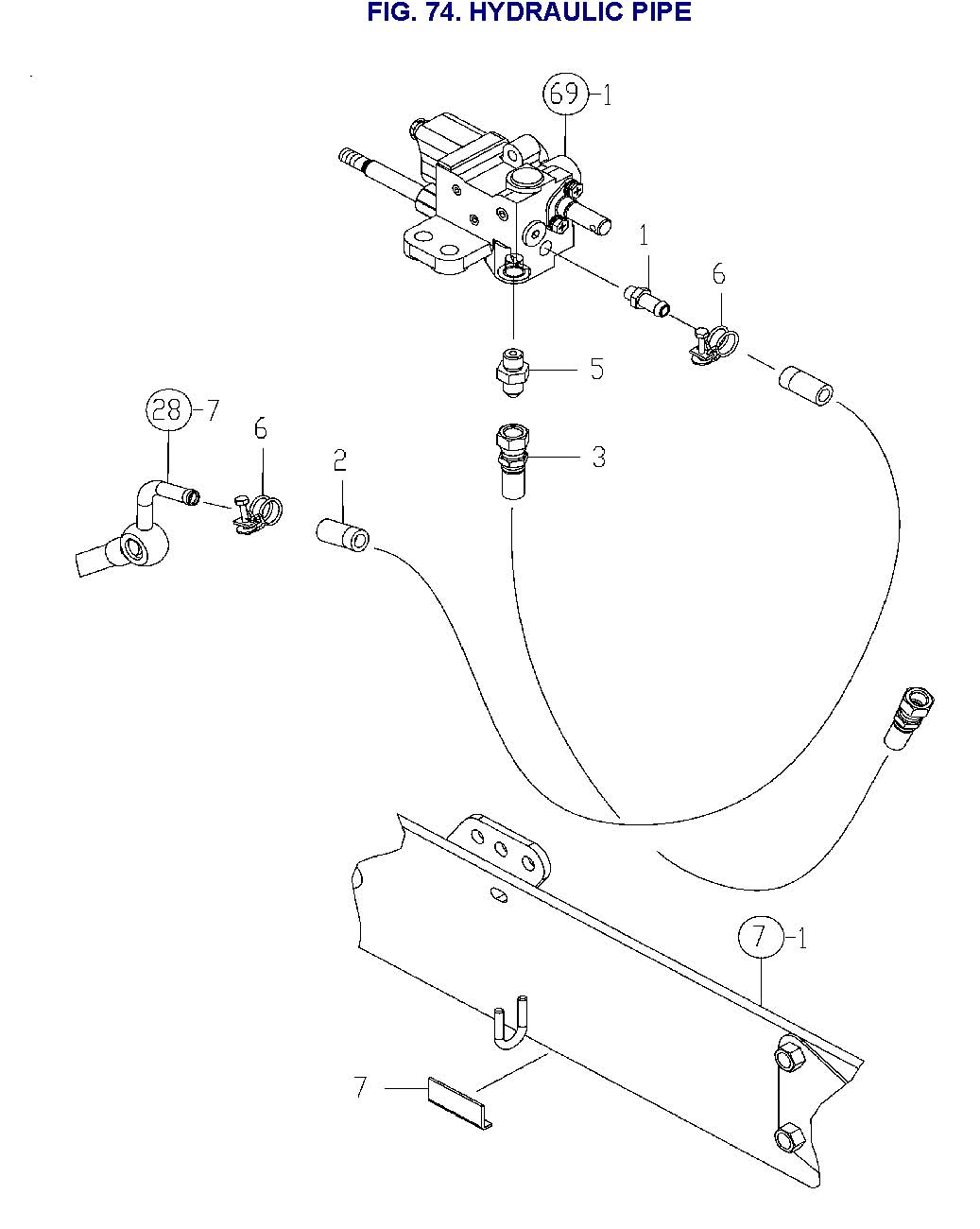

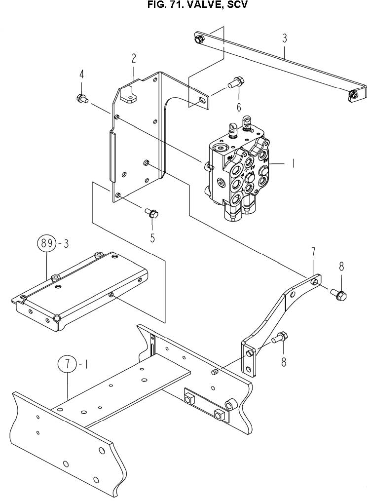

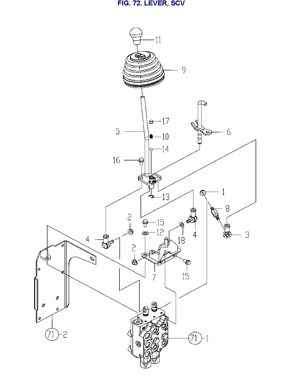

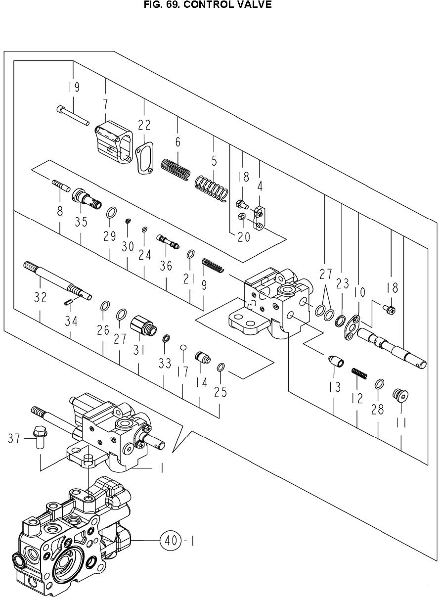

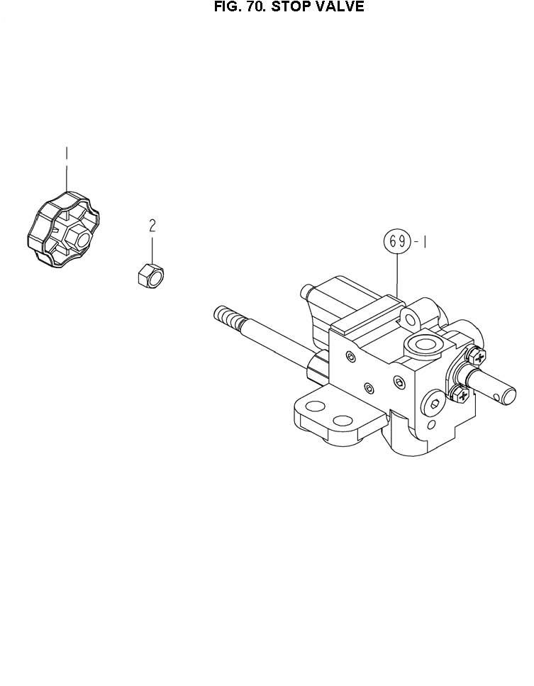

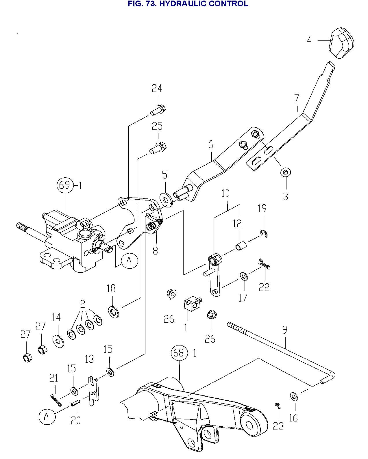

A picture of the loader valve and part info is on pg 138. Quickly glancing through it, I didn't notice a full schematic of the hydraulics but I could have missed it.

Looking through the manual, it looks like the valves are covered from pages 128-138. Attached are some pictures. Figure 73, img 90 is the 3pt lever/valve
