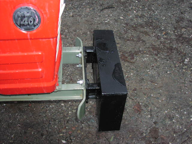

Gary, thanks for the post. It is amazing how unstable a tractor can be if not ballasted properly. On smaller tractors that we sell without loaders we always hang weight on the front. Not having a good source of suitcase weights, we make ours out of plate. We have a local pipe making shop that has tons of 1/2" to 3/4" plate for .06 per pound. We cut up a bunch of squares with the plasma cutter, about 16" by 10" and weld them together, then we weld a piece of 3/8" x 4" flat bar around the edges to make it look nice. It bolts onto the bumber and weighs about 200lbs.
Steel weighs about 500lbs per cubic foot, conrete is just over 100lbs for the same volume, so steel weights are the way to go.
Here is a picture of our shop built weight.

Thanks Dave for a wonderful suggestion on how we can keep our "feet" on the ground cheap. I was thinking how I coud do that with my little Shibaura and here you are giving me the answer. What a wonderful site and unselfish people!!
jesse
