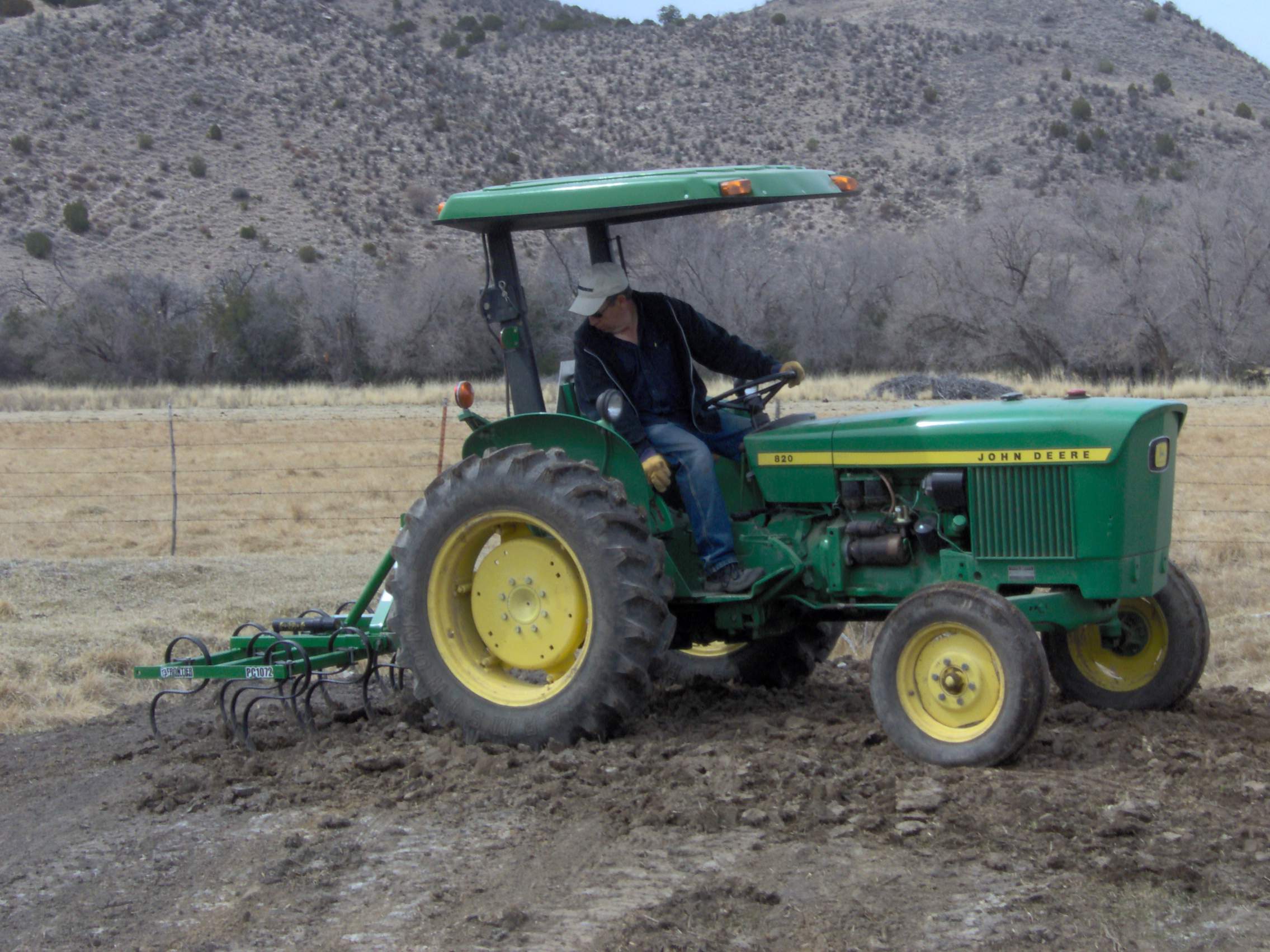

I would be looking into a scarifier, cultivators or similar ran at ground level or just below and a wagon to put them all in. Consider overlapping yourself so as to go over all areas twice.
   / Scattered Hay Net #8
Not going to be fun no matter what you do.
That's true. But any method using a scarifier, landscape rake or other fixed tine/shank type tool will be far better than going in there with anything power-driven. I like the scarifier/cultivator idea because it will catch a large percentage of the net but flow sod, clumps, etc through with hopefully not too much plugging.

I use a small 6ft field cultivator for this type project, should work for you.

My son works at a rental shop. He recently had a tiller come back with a wad of landscape mesh netting you would see on a hillside wound up on the tines. He spent about 4 hours of his day cutting, pinching, pulling, and winding the crap out of the tines. He snapped a picture of the ball when it was done and it was easily a foot in diameter. A wrap or 2 isn't so bad, but when you wind it around for a few hours, it can get down around the spindles so badly the only solution is to disassemble the entire machine. Really ugly.
Use something with fixed tines to just pull it out first. It will save you many, many hours.
