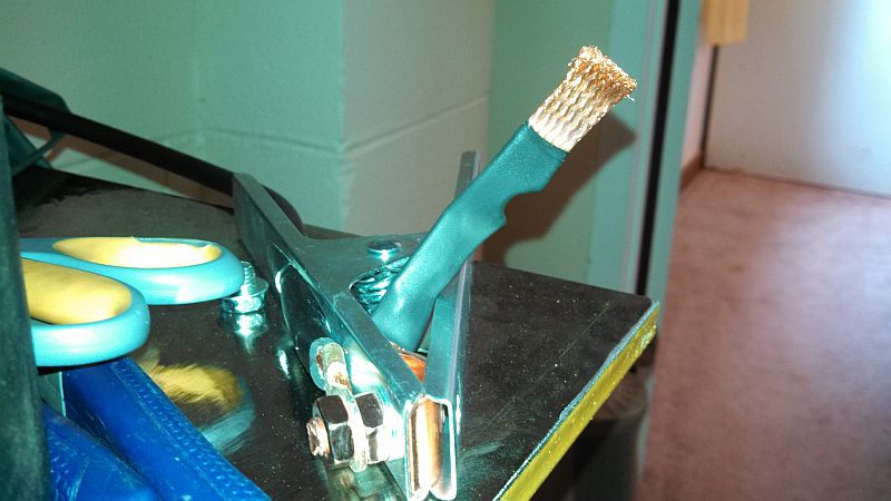

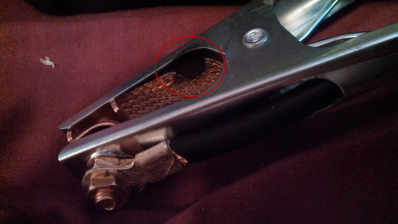

I noticed a scorched/melted part on my ground clamp today.

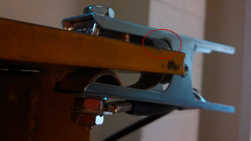

My best guess is that when I had it clamped on the table, the woven copper bridge between the two jaws arced to the table, as shown below.
It could also be that the woven copper bridge arced to the clamp itself, but that seems unlikely, as it would seem to be an unavoidable design defect, and this is a pretty standard design for a ground clamp.

yes, if your table is painted or rusty it might not make good contact. I like to twist the clamp back and forth after clamping it on to let the copper jaws rub through any 'gunk' to make better contact.
   / Scorch/melt on ground clamp #3
Yep, that is what happened, I had it happen to me a couple of times too, from not having the contacts on good clean metal, and the braid was touching bare metal.. happened on the lip of a FEL bucket, too much paint further back but the edge where it touched the braid was bare... whoops.
It's odd, because the "teeth" of the clamp were on clean, bare metal (the table top). But I know that anywhere there's a small gap will arc, so my guess is I shouldn't have put the clamp so deep on the table.
