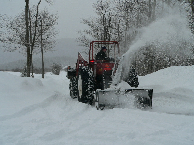

I didn't bother to mount my box scraper this winter as it lengthens the blower too much and make manuering more difficult with the added length. So today I was out scraping with the blower (i.e., get the front wheels off the ground and run on the edge of the blower). This scrapes and removes in one action. Unfortunately the steering leaves something to be desired. The picture below shows the results after 200" of snow so far this winter season:

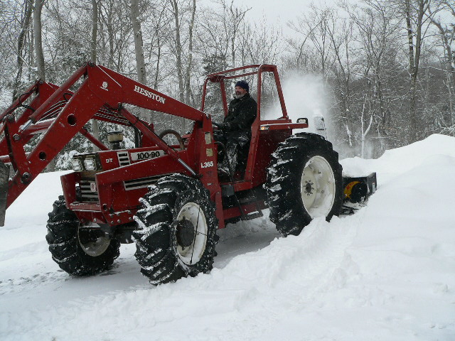

The driveway looks great as always! Would a small blade on the back stick out too much for maneuvering, or would it be about the same as the box blade? I have a 5 foot Woods blade on the back of my tractor with skid shoes on it and I push it backwards with the blade turned around so that it acts as a plow. The shoes keep it about a quarter inch off the ground and it does a nice job. I tried the blower scraping method, but experienced the same steering problem you did. Mine doesn't steer that great in the turns with the blower in float position, ha! Looks like you've got your share of snow? Dyer, retired

Nice job. I have the rear snowblower and to scrap down the drive I lenghten the toplink and it scraps to where it will dig right through the snow and ice and into the gravel if you aren't watching it. Works okay on the blacktop but still needs a litle added weight.

Ain't this hard on the blower?

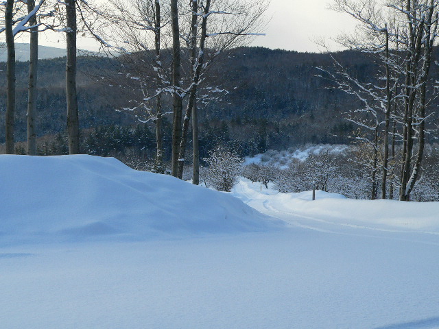

My drive is half a mile long with a loop at the top and a pad at the bottom. ot changes several hundred feet of elevation over that length.
I use these to keep it snow free.

Possibly, but I am just creeping along because it doesn't have any steering control. Hey I am retired so I usually have the time!
