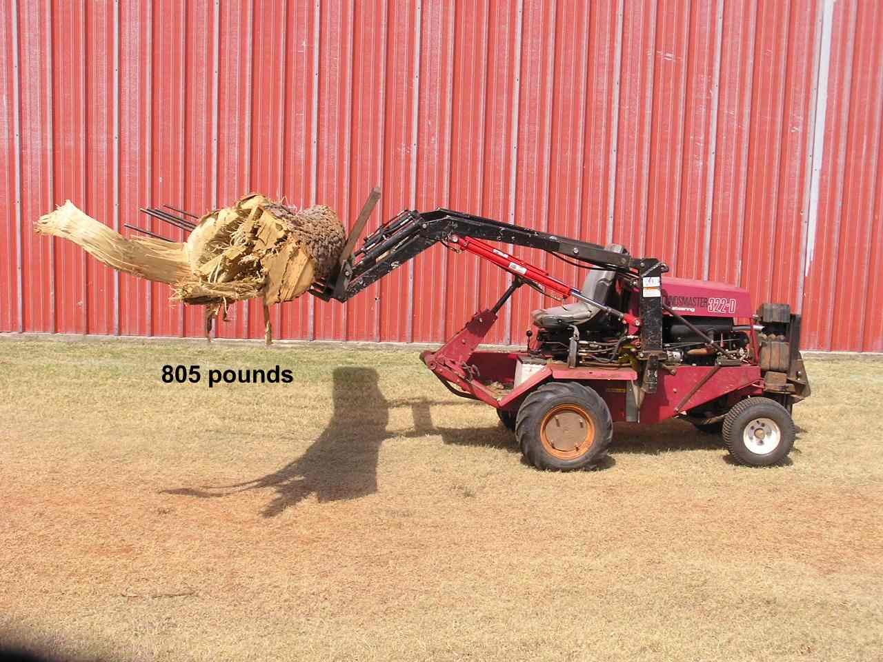

What size and lift capacity?
Mine is a 3 cylinder 22hp diesel, 9 mph top speed:

Yours is a front deck mower with a loader added on in place of the mower deck, correct?
Correct.
