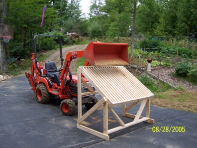

Has anyone ever built something to screen dirt that can be used with a FEL? I want an easy way to screen out rocks and debris.

HERES MINE,Built it for under 50 bucks works great!

hey escavder,
I was wondering how far apart your boards are to let the dirt through and how long they are? thanks tim
   / screening dirt #8
TIM,
I went back through my posts and found it.I posted last august in the KUBOTA OWNER SECTION,a thread called BUILDING DIRT SCREEN BX 23.I have all my details there.I wish i was better on this computer ,and knew how to show it.To answer your question ,i tryed it at 2 inch spacing,but it didnt screen it fine enough for my liking,i ended up at 1 3/8 apart.

All you need to do is strech a piece of wire mesh over a 2X4 frame and prop it up with legs. The size of the mesh will determin how fine the sift will be. The larger the screen the more vertical suports you use.
